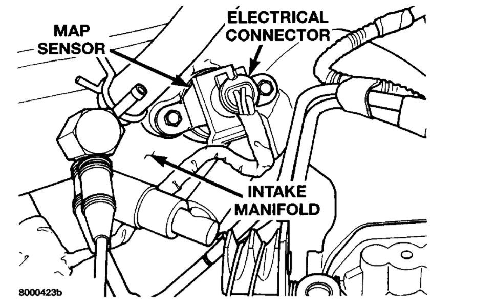

The location of the map sensor on the car listed above needed.

Good afternoon.
Below is the procedure and a picture is attached.
Removal:
1. Disconnect electrical connector from MAP sensor.
2. Remove two screws holding sensor to intake manifold (Fig. 9).
3. Remove sensor from manifold.
