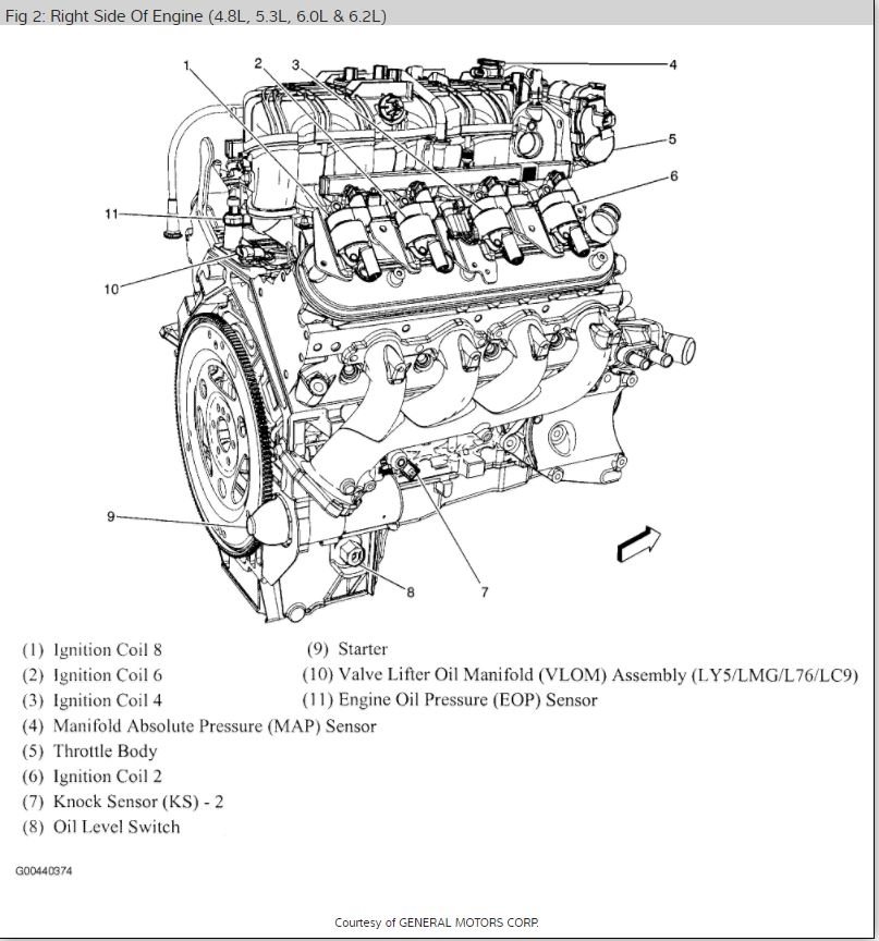

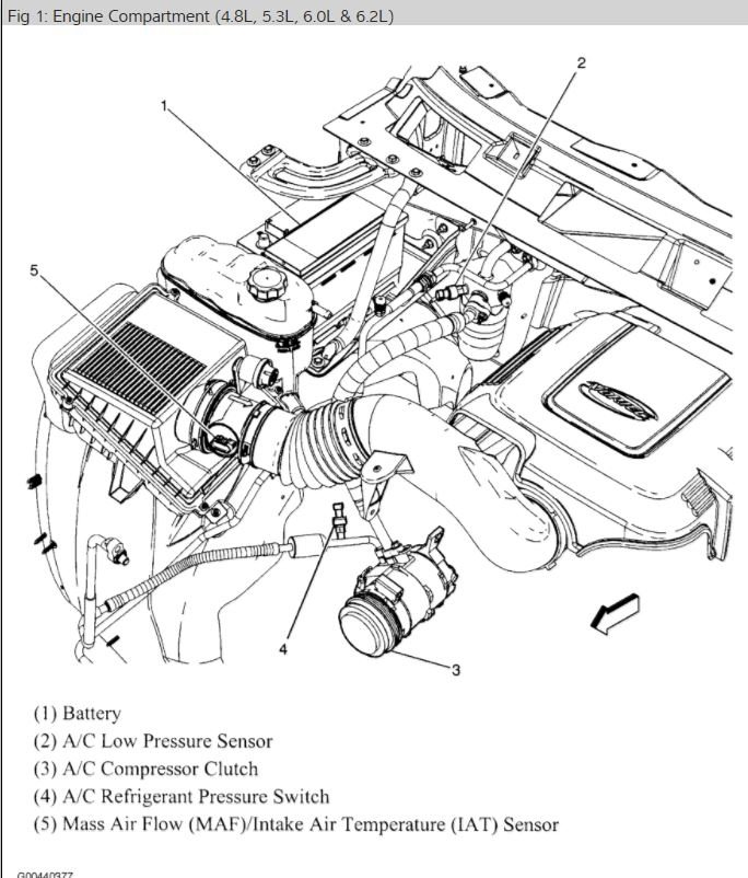

Can you tell me where the MAP sensor and the MAF Sensor is on my truck? Thanks!
(1500 SLT, Vortec engine)

Check out the diagrams below. Check out the diagrams (Below). Please let us know if you need anything else to get the problem fixed.
