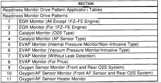

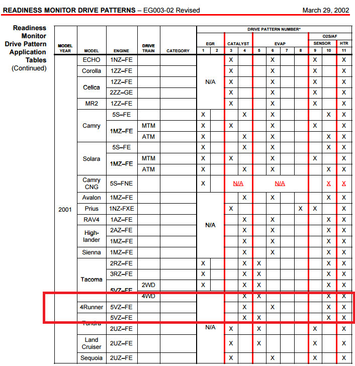

S = Set, U = Unset
The chart goes with a table that shows in which order the various monitors run and what the drive cycle is to get each item to run. The attached pics shows a couple versions of the 11 monitors.

Most of that is in the factory technical service bulletins or in the FSM for particular vehicles. Some makes simply have a single readiness monitor drive cycle. Some of this you can also find in scan tool "help" sections.
Full versions of the above. Just search and you should find the. Pdf files.
Toyota - TSB EG003-02
Lexus - TSB EG002-02
