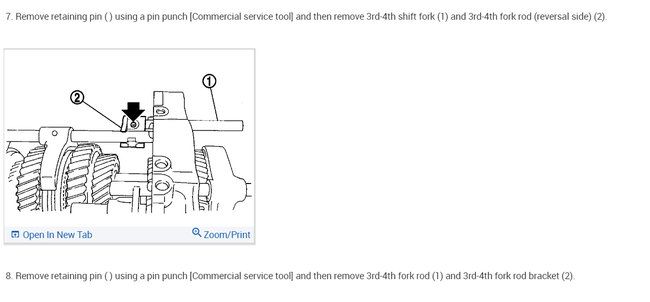

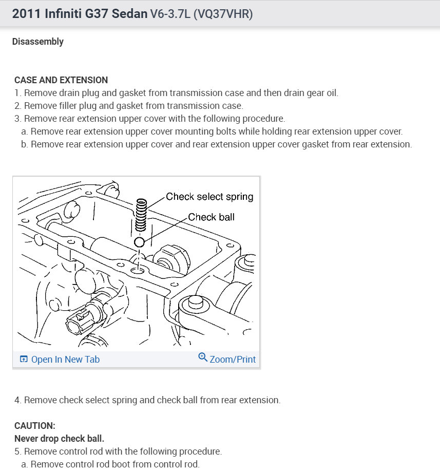

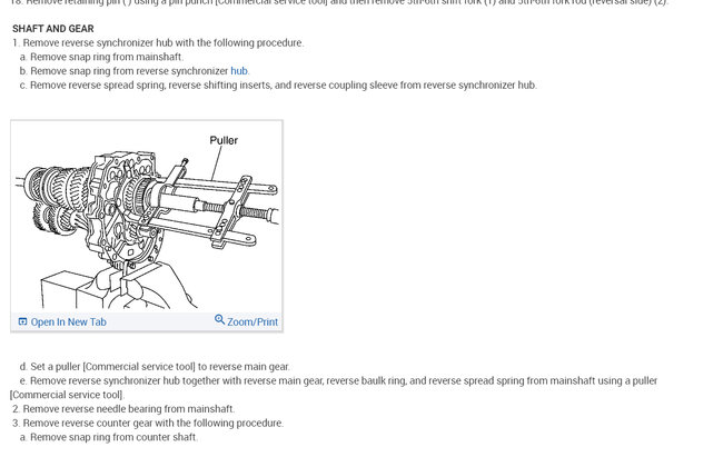

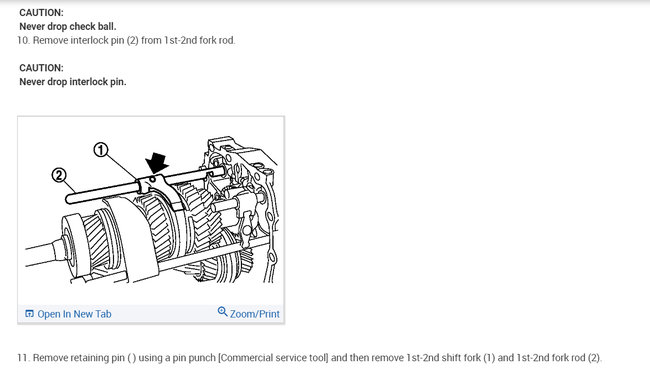

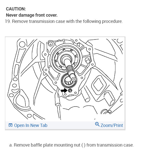

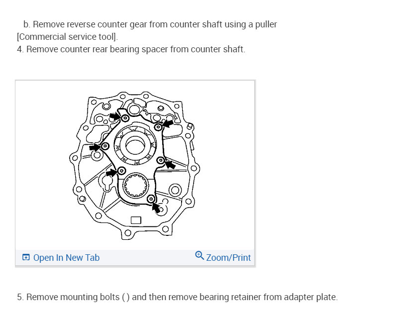

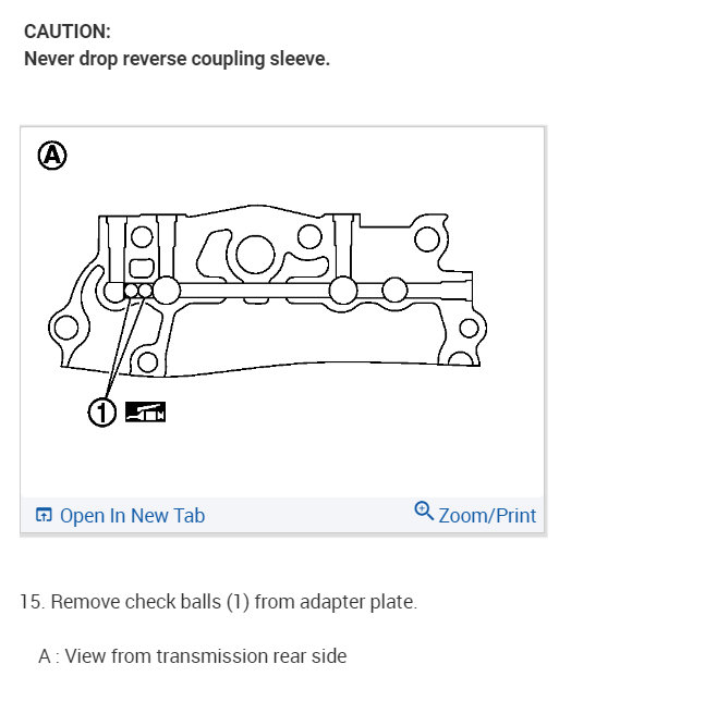

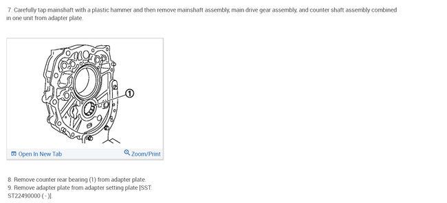

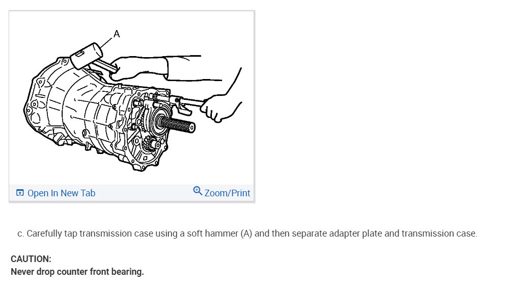

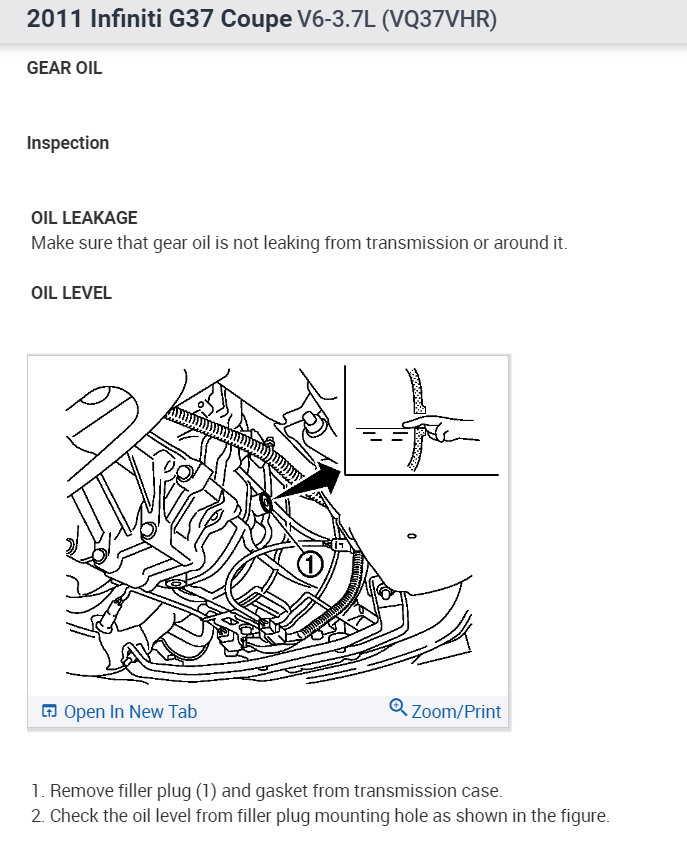

It sounds like the transmission input shaft bearing has gone out, I would make sure the transmission fluid is full and clean. Here is how to check it:
Fluid Types
Manual Transmission Fluid
Genuine NISSAN Manual Transmission Fluid (MTF) HQ Multi 75W-85 or API GL-4, Viscosity SAE 75W-85
Capacities
Manual Transmission Gear Oil
Capacity .................... 6 pt (2.83L)
Aug 24, 2022 at 8:51 AM

Thank you for the reply, Ken. I actually just changed the manual transmission fluid yesterday with redline mt85 hoping that would solve the issue, but it did not.

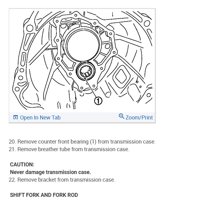

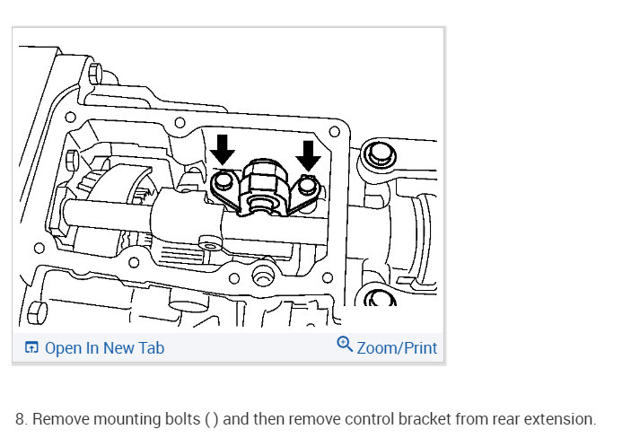

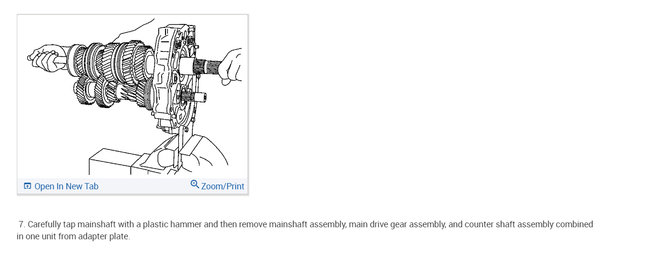

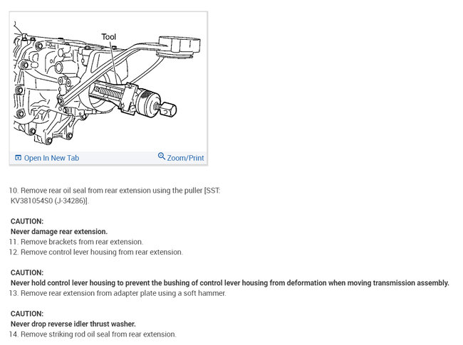

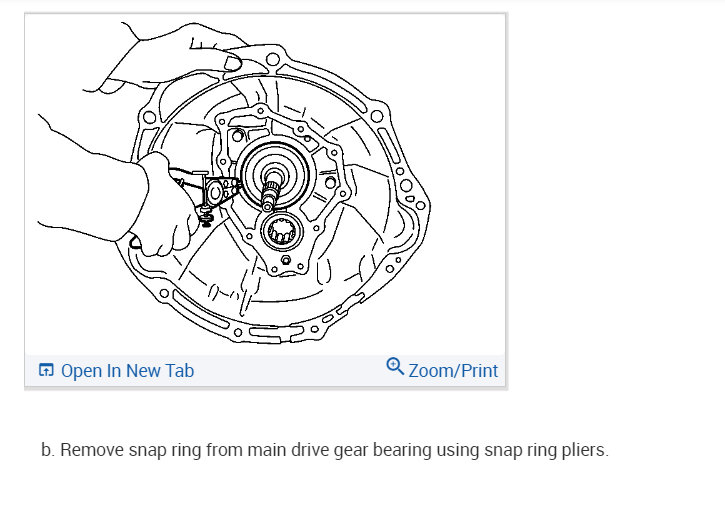

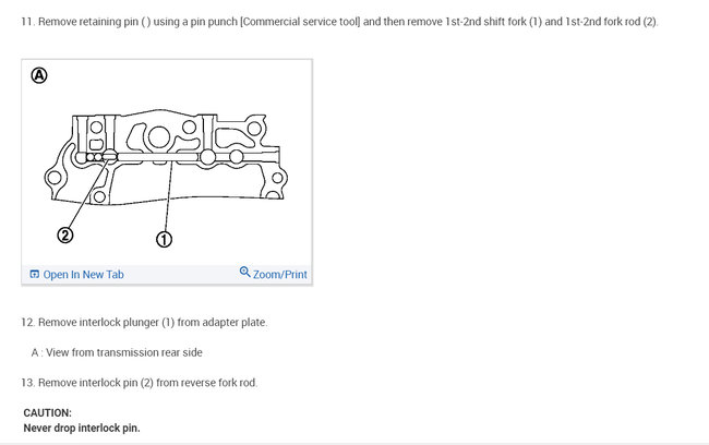

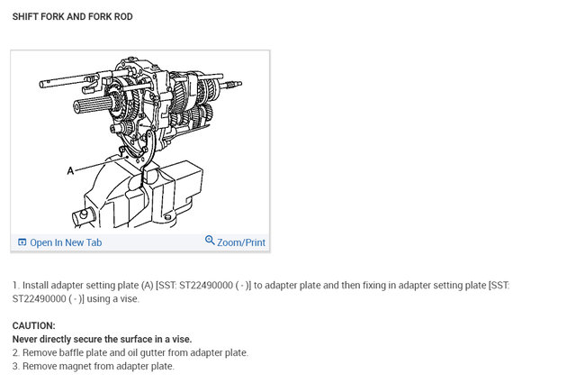

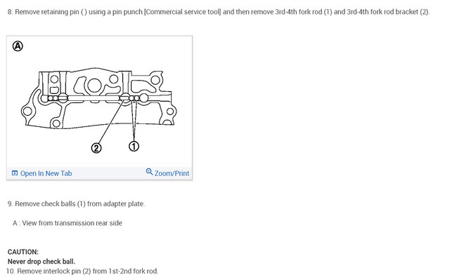

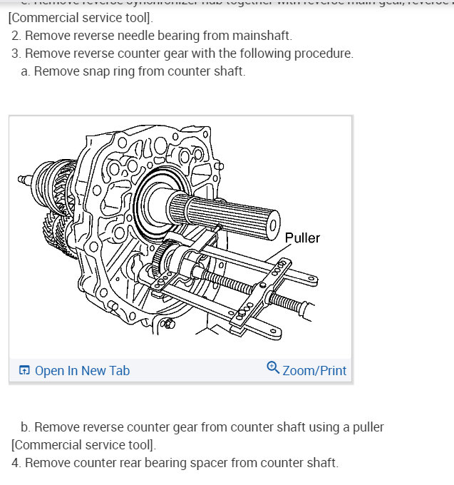

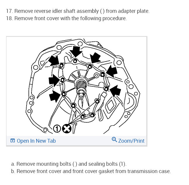

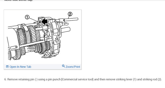

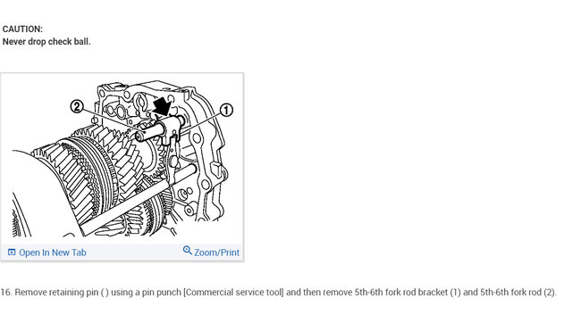

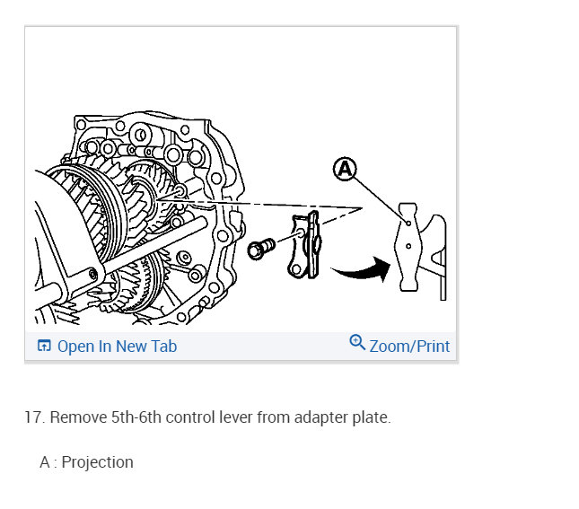

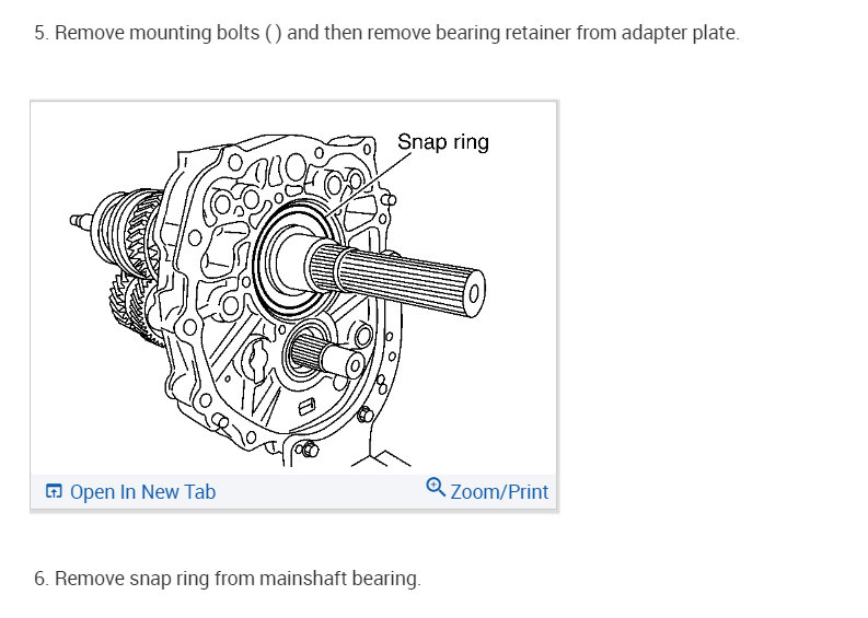

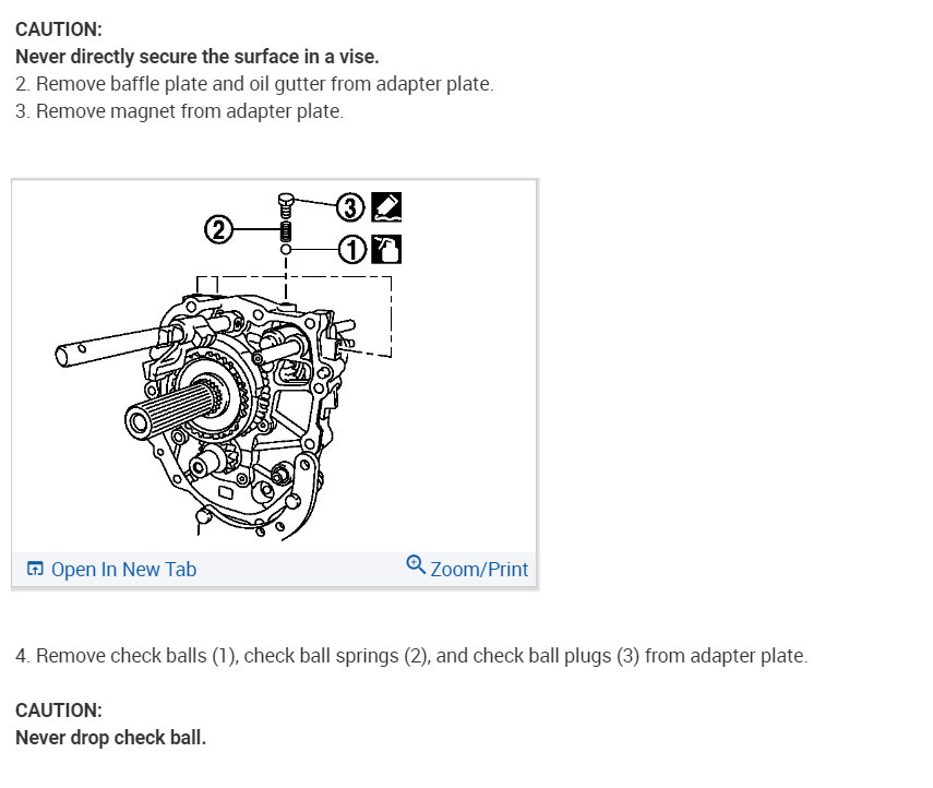

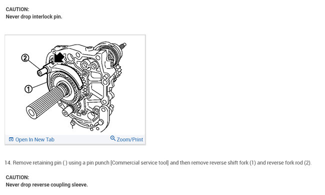

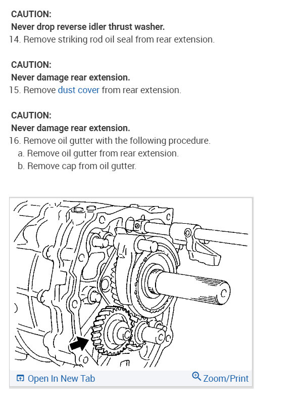

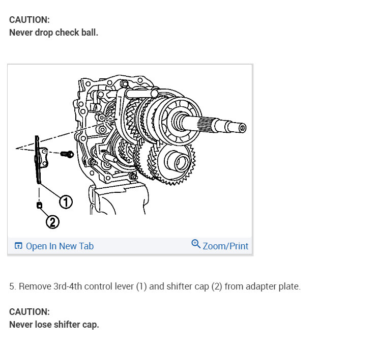

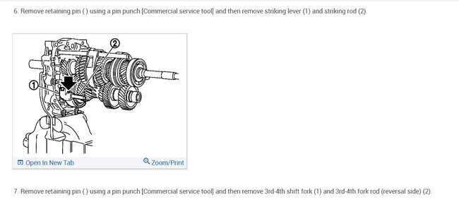

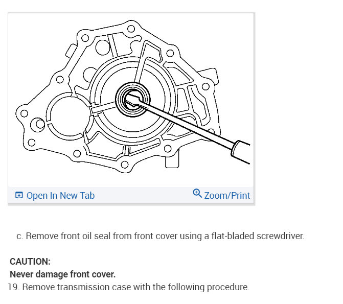

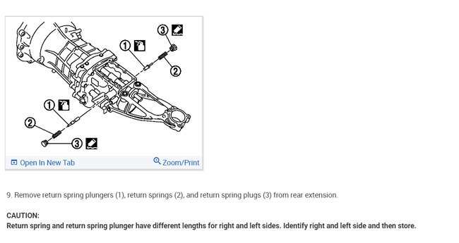

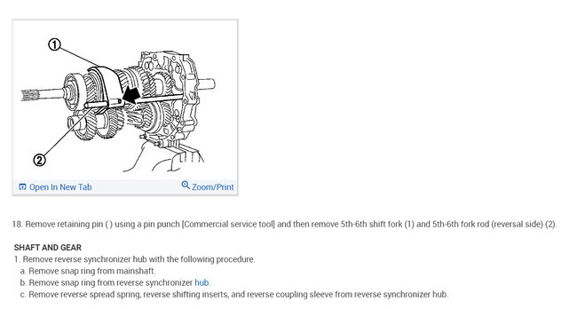

Yep, it sounds like the input shaft bearing is gone. the transmission will need to come out, let me know if you need help with the repair. check out the instructions below.
