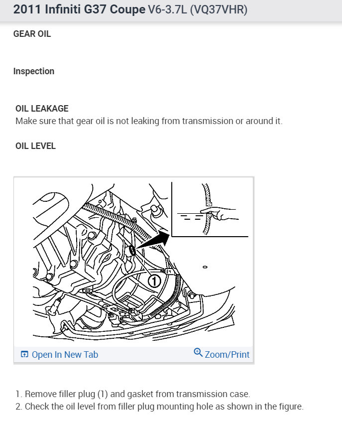

It sounds like the transmission input shaft bearing has gone out, I would make sure the transmission fluid is full and clean. Here is how to check it:
Fluid Types
Manual Transmission Fluid
Genuine NISSAN Manual Transmission Fluid (MTF) HQ Multi 75W-85 or API GL-4, Viscosity SAE 75W-85
Capacities
Manual Transmission Gear Oil
Capacity. 6 pt (2.83L)
Wednesday, August 24th, 2022 AT 8:51 AM

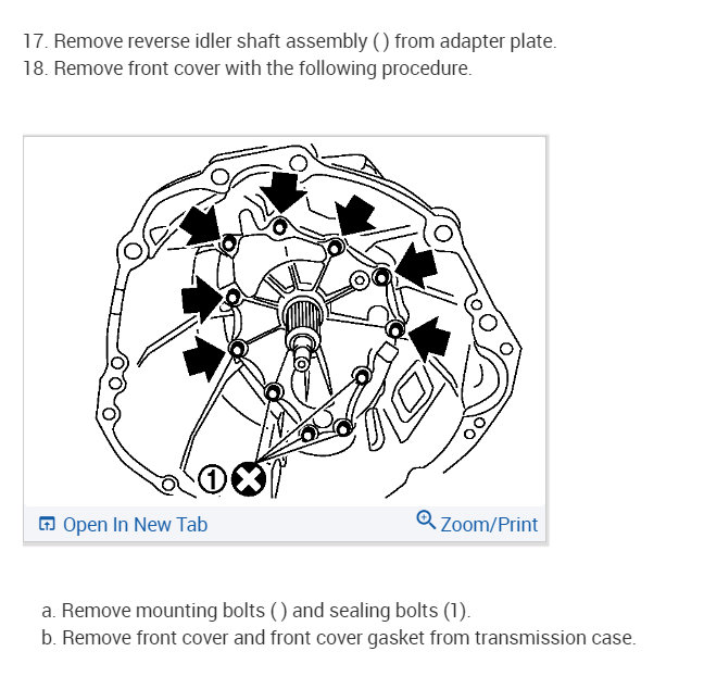

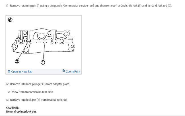

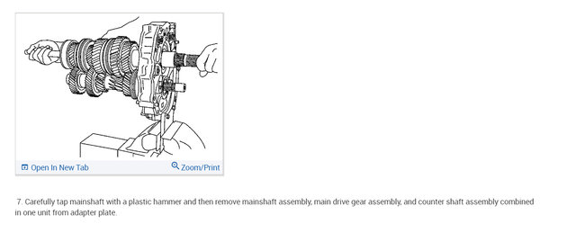

KEN L
  • MASTER CERTIFIED MECHANIC
  • 55,361 POSTS

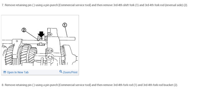

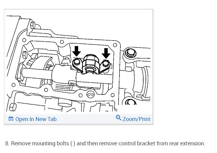

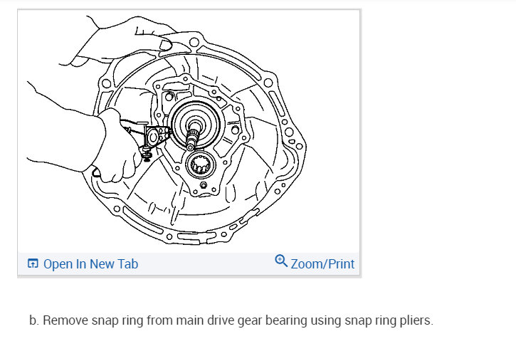

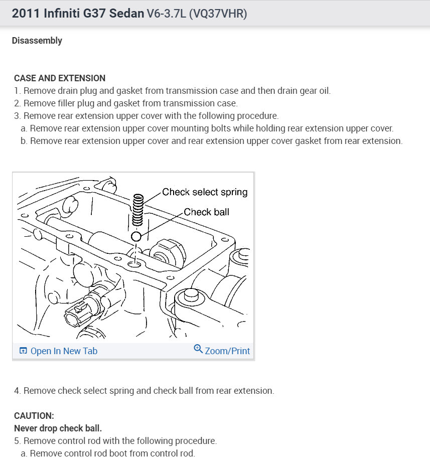

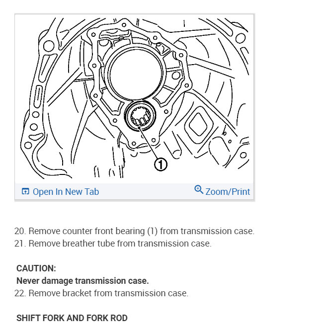

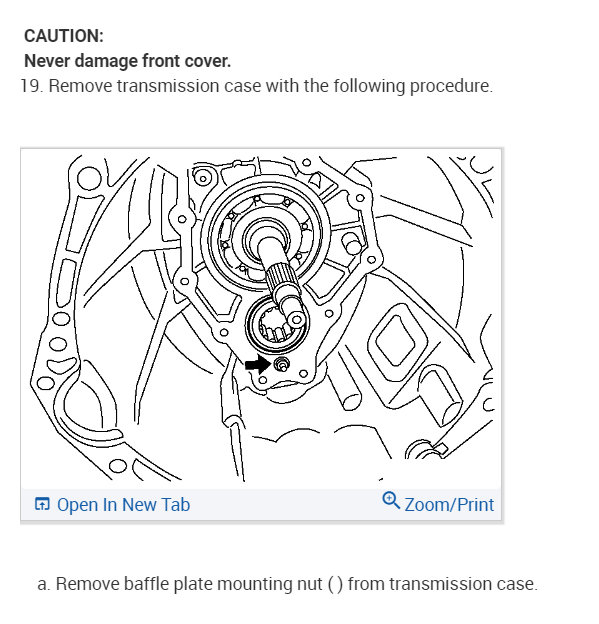

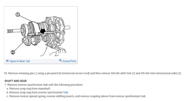

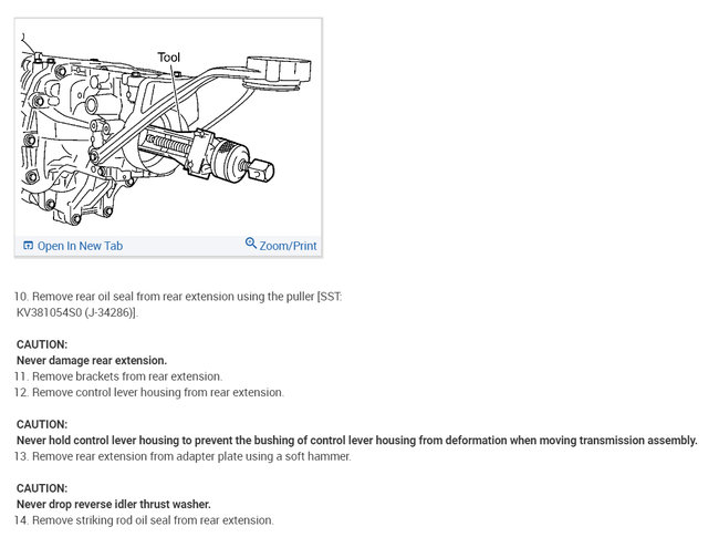

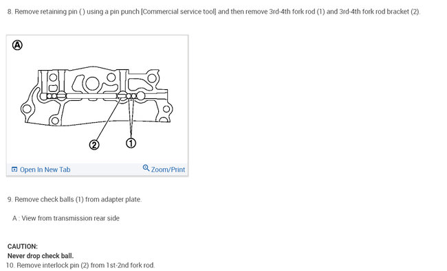

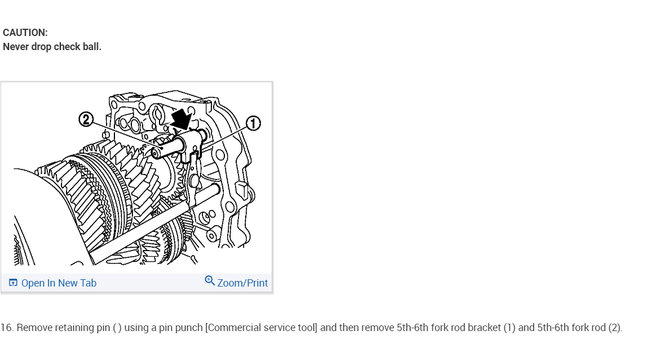

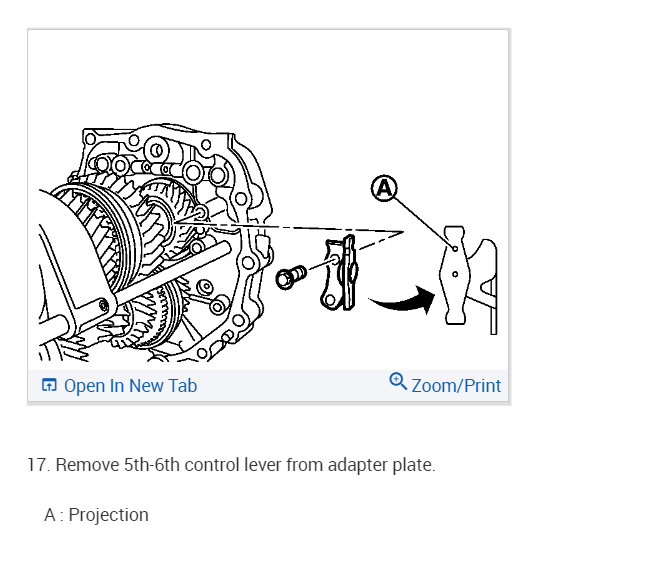

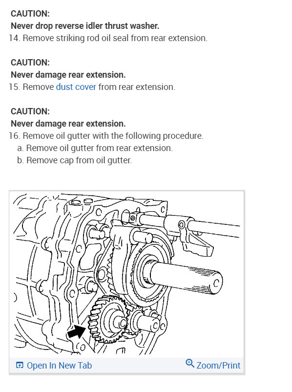

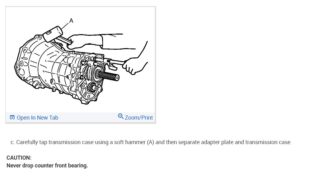

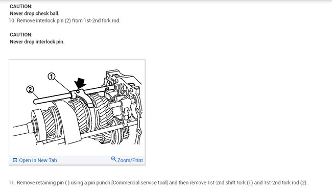

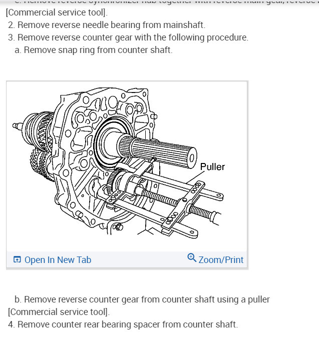

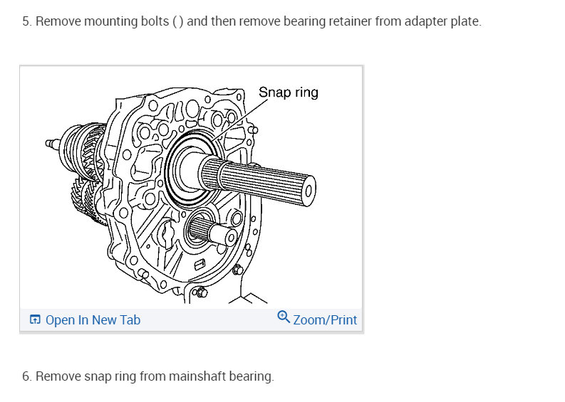

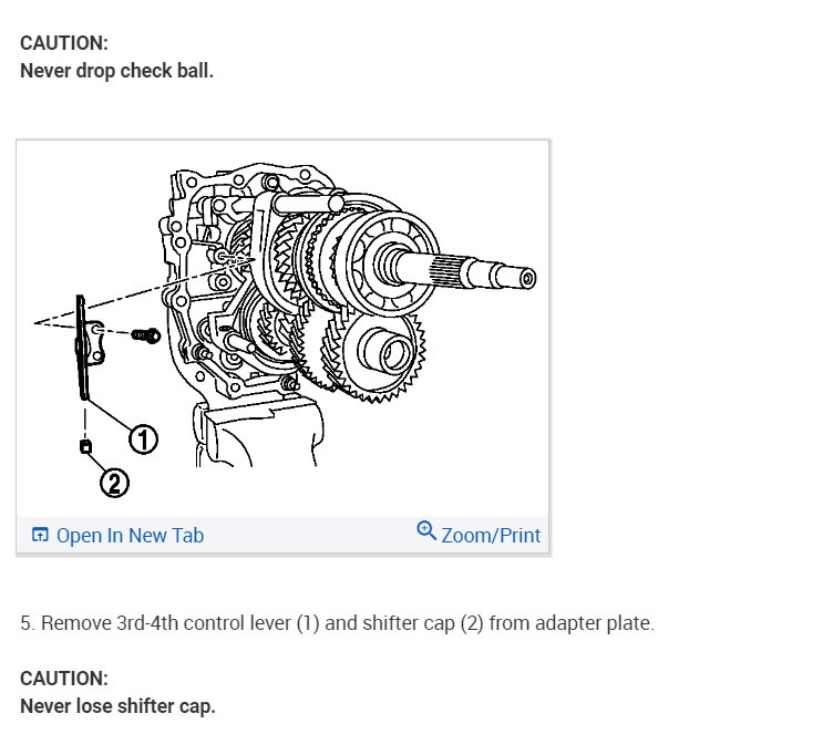

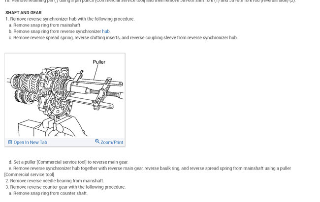

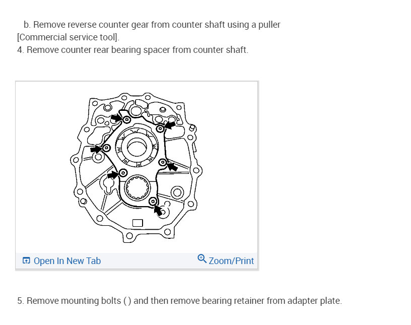

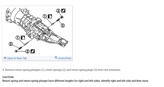

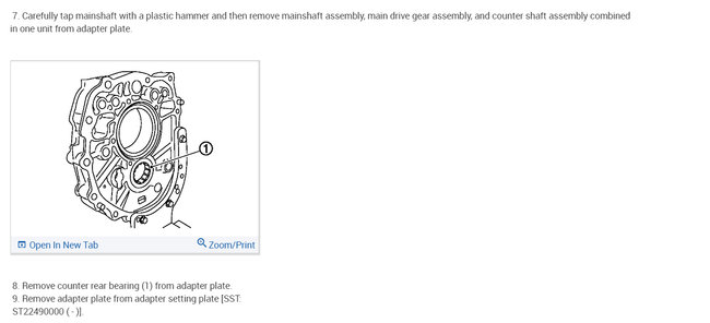

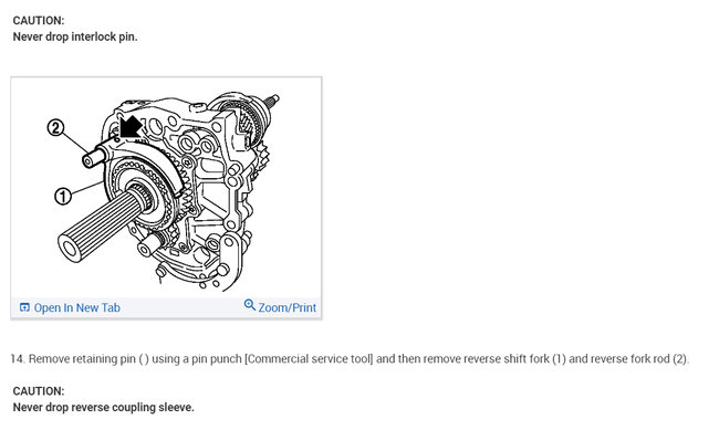

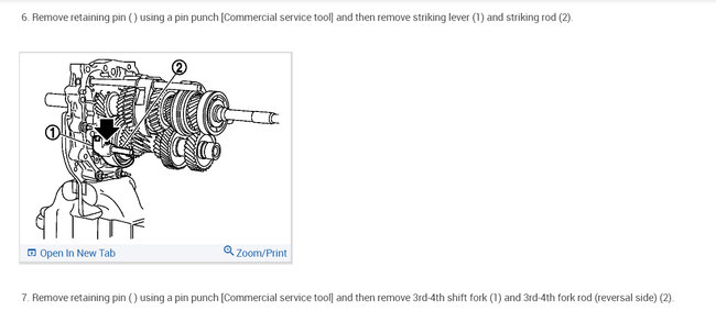

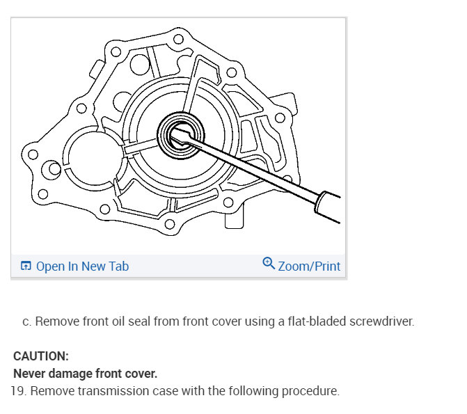

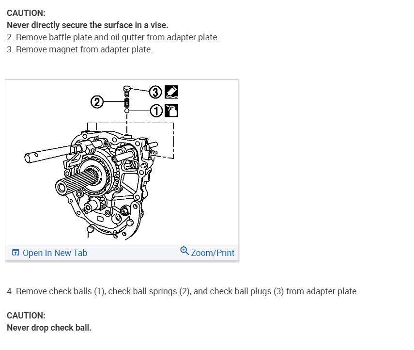

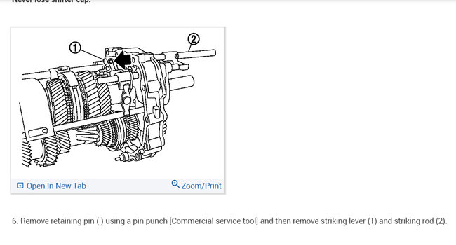

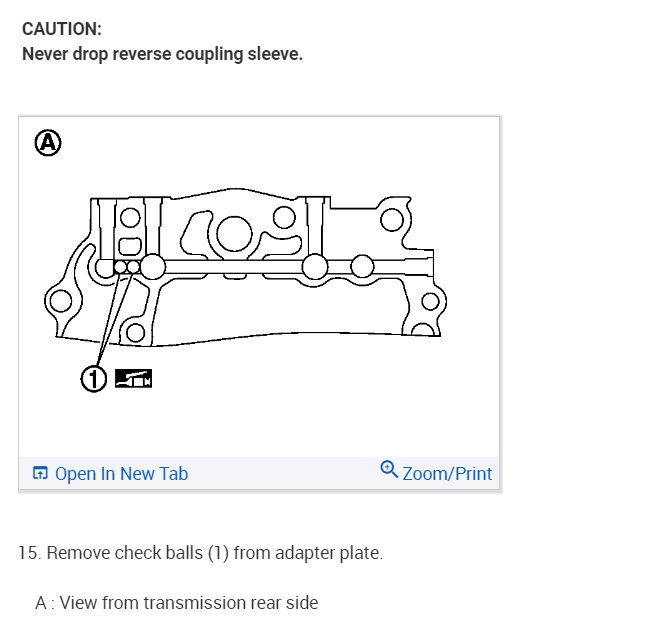

Yep, it sounds like the input shaft bearing is gone. The transmission will need to come out, let me know if you need help with the repair. Check out the instructions below.
+1
Thursday, August 25th, 2022 AT 4:54 PM

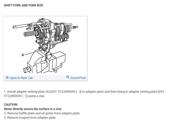

KEN L
  • 55,361 POSTS
I can tell if the noise is normal if you upload a video of the noise from inside the car. You can upload it here with your response.
