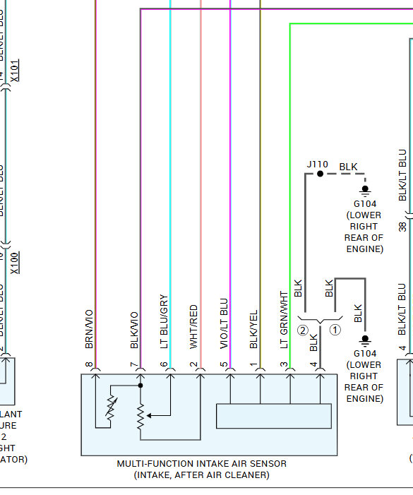

I have a maf sensor that was wired up wrong and I cannot find anything to help identify the 8 pin wire colors for this car.Any help would be greatly appreciated!

Sure, here is how the wires go to the MAF sensor. Check out the images (below). Let us know if you need anything else.
