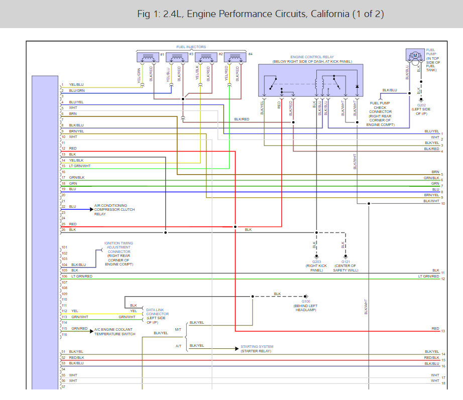

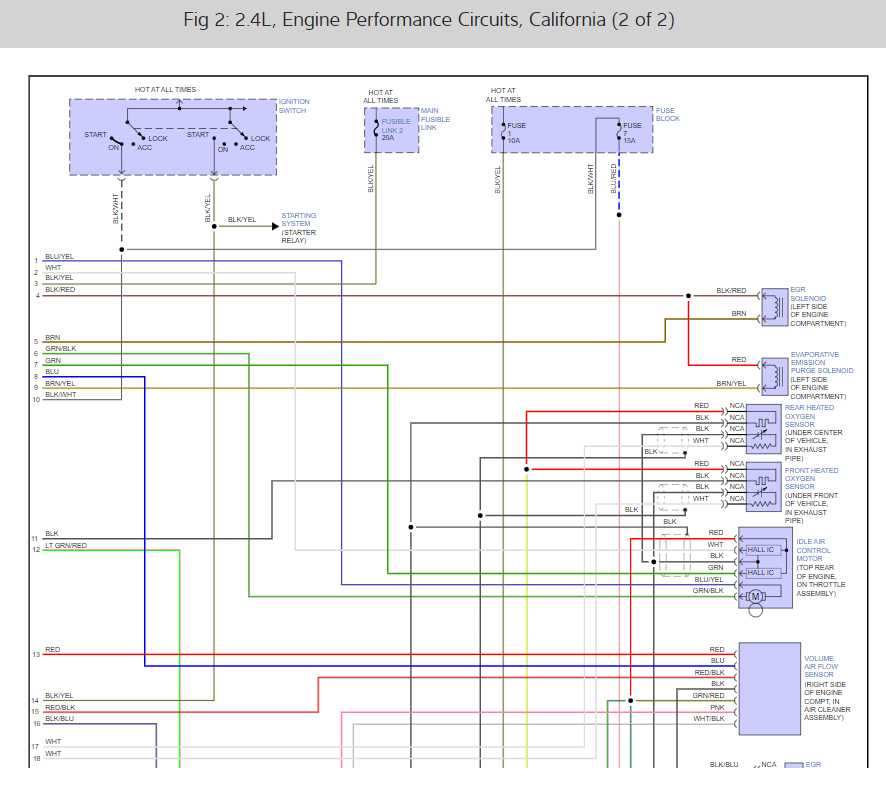

Need to know the vehicle listed above, Mass Airflow Sensor spec's on the wiring connector?

Here are the engine wiring diagrams which included the MAF sensor and I have included a guide to help you check the connections.

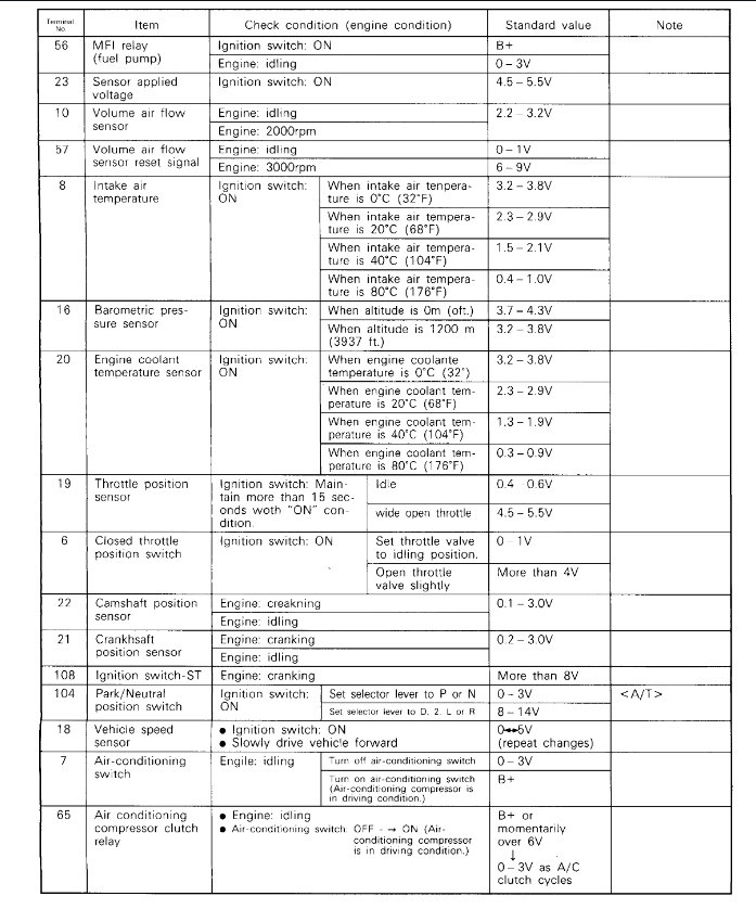

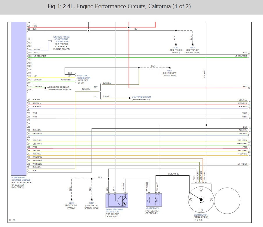

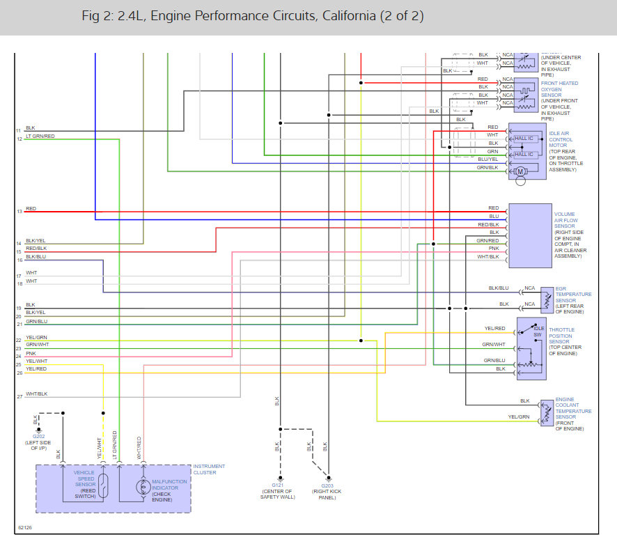

I need the specs of the connector pins/terminals such as the 5v/12v/MAF signal wire/ and others on the 7 pins.

Sure, here you go. Check out the diagrams (below). Please let us know if you need anything else to get the problem fixed.
