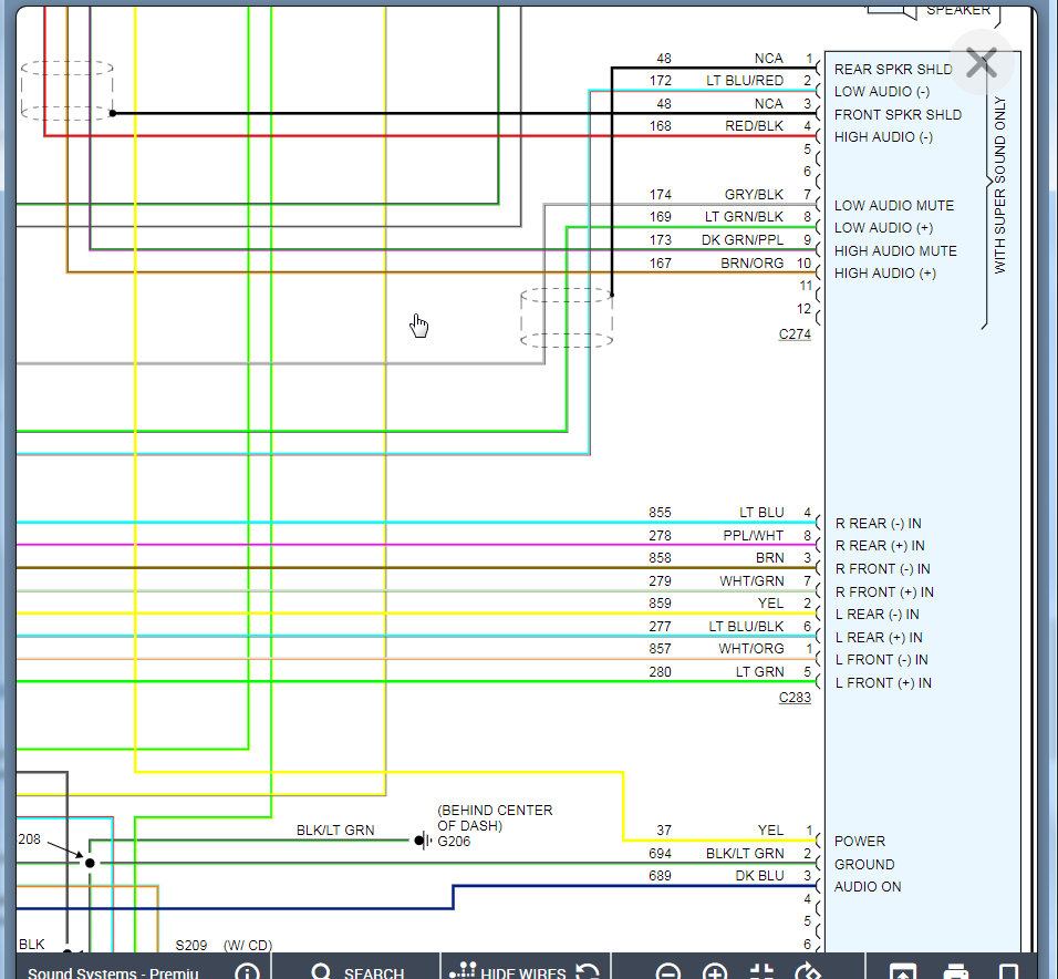

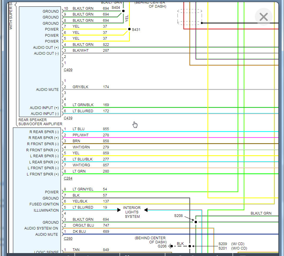

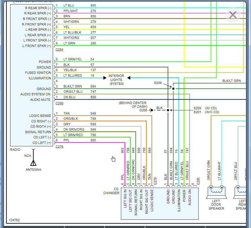

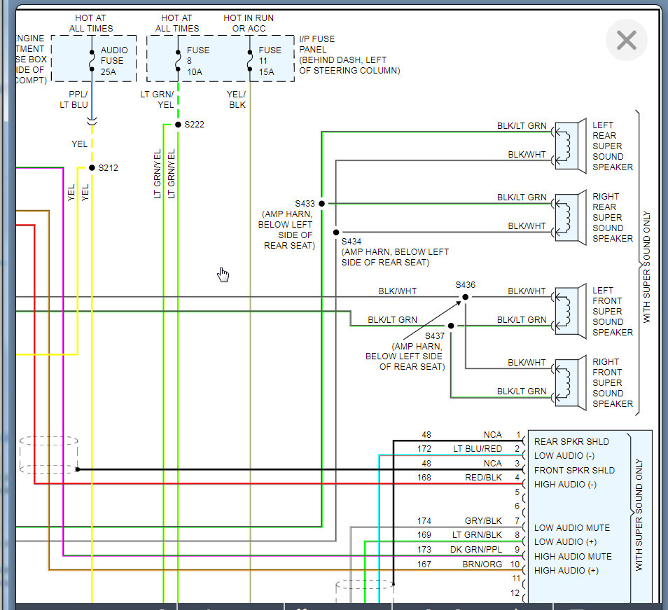

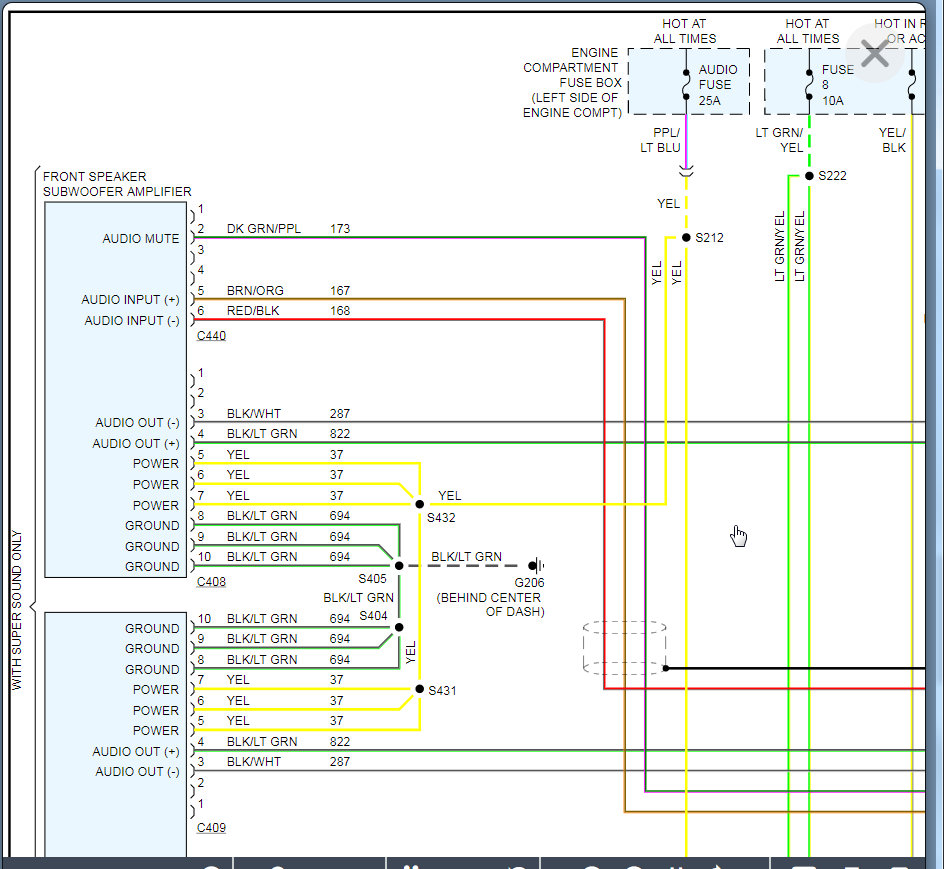

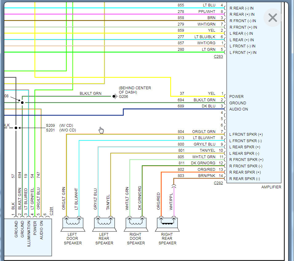

Hello guys, I need to get a wiring diagram for my car listed above GT's Mach 1 stereo system, please. I am really interested to see if the head unit goes to a pre amp or not. Thanks for all you guys do.
Oct 1, 2020 at 9:55 PM
  • CAR REPAIR CONTRIBUTOR
I attached the complete harness for the premium system as that is what came in the GT. Let me know if you have questions. Check out the diagrams (Below). Please let us know if you need anything else to get the problem fixed. Thanks
