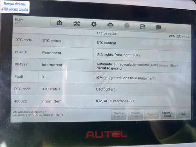

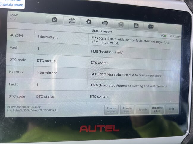

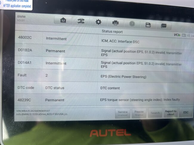

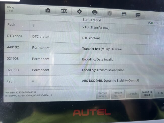

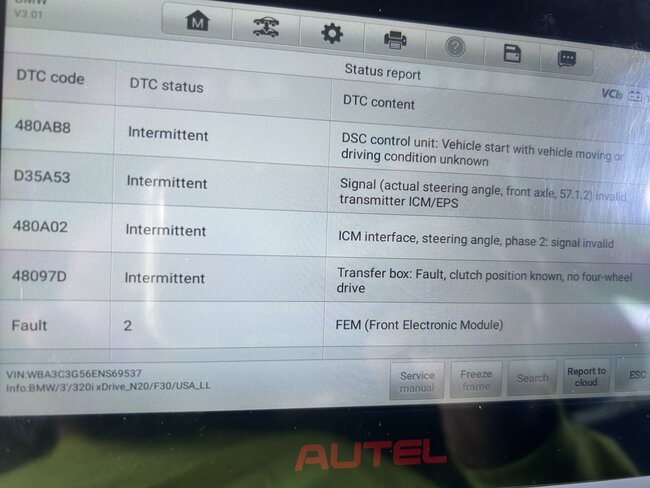

Hello, I just bought this BMW from a private seller. I just replaced the transfer case in it and while out test driving it I got a warning message for low oil pressure. Hopefully this is something easy to address. Are you able to look and see any service bulletins or anything on Low oil pressure with this particular set up?
I’ll attach photos of the codes.
Jun 16, 2025 at 10:47 AM

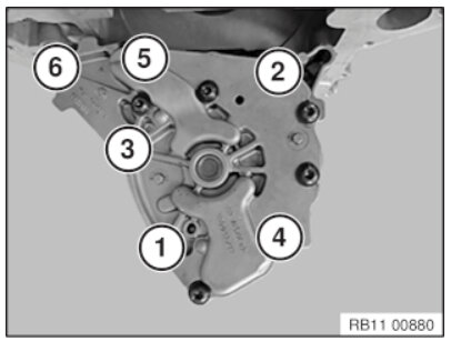

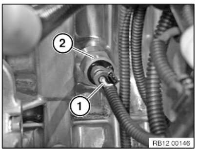

There is no TSB's for low oil pressure on this car. Most of the time the oil pump pick up is clogged due to poor maintenance. Can you remove the oil fill cap and look inside using a flashlight to help confirm sludge inside the engine? You might want to try changing the oil and filter and then clear the codes. Please upload pictures or videos in your response of what you find. There is an outside chance the oil pressure sensor that is going bad, here is the location so you can check it out. Check out the images (below).
Jun 17, 2025 at 12:40 AM
BEETLEPUNK21
  • 127 POSTS
Thank you so much. Where exactly is the oil pressure sensor located? The picture didn’t really show where it was located.
Jun 17, 2025 at 1:19 AM
  • 55,433 POSTS
It should be near the oil filter.

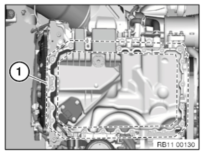

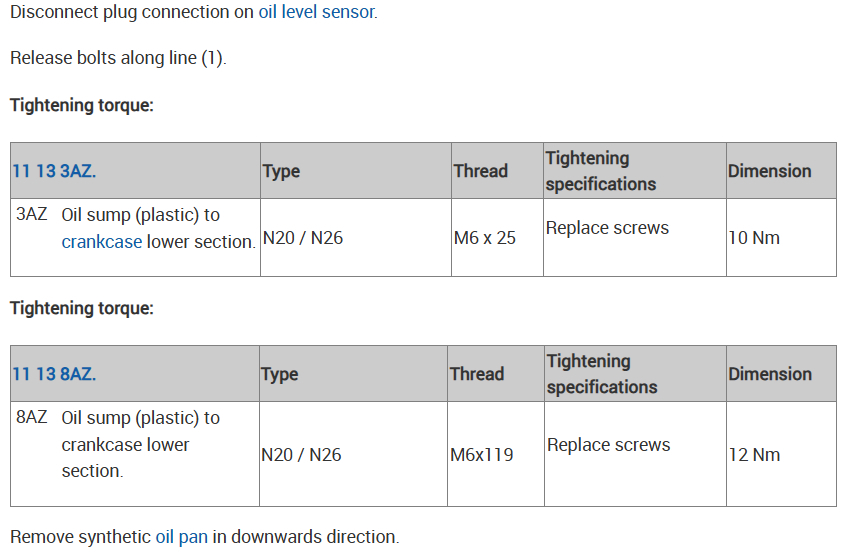

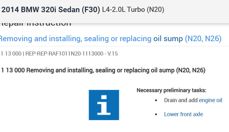

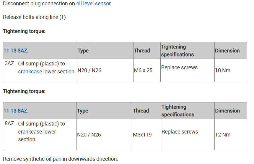

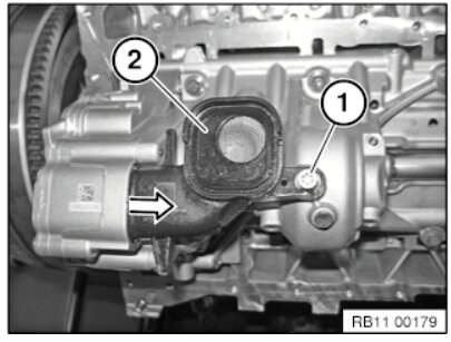

Hey Ken, I haven’t gotten a chance to look at the BMW yet, but I remember reading on some forums that some BMW owners were having low oil pressure due to low quality timing, chain guides, breaking and then clogging up the intake pump.
In the off chance that that is the case, could I get the diagram of how to pull the oil pan?
Thanks
Jun 20, 2025 at 10:12 AM
  • 55,433 POSTS
Yep, you read correctly. It is a good idea to check the oil pump pick up. Here are the instructions they give. Check out the images (below). Please upload pictures or videos in your response.

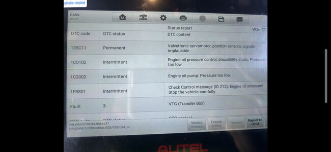

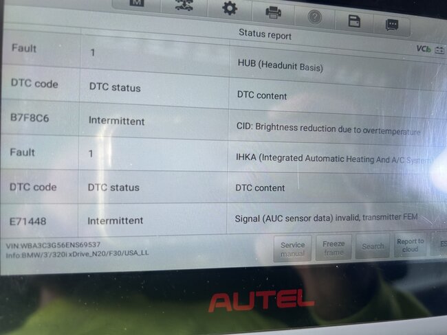

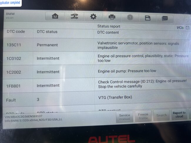

Hello, I just bought this BMW and have quite a few codes that I pulled from the computer. One in particular that I am concerned about is this 135C11 code for the valvetronic motor? I’ve attached a photo.
What would be the process to correct or fix this issue?
Can it be reset?
Thanks in advance!
Jun 22, 2025 at 6:09 AM (Merged)

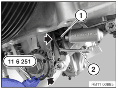

Hello!. I was able to drop the oil pan over the weekend and I did notice that were there were some broken timing chain plastic pieces, not a whole lot, but there was some. I didn’t see anything else that would be clogging the intake oil pump. I’m assuming maybe one of the plastic pieces was close to the intake and Possibly it was clogging it?
Let’s say that maybe the plastic pieces weren’t the issue causing low oil pressure. What would the next step be? Would it be to just replace the oil pump?
Jul 27, 2025 at 10:51 PM
  • 55,433 POSTS
Yes, so what happens is a part of small plastic gets through the oil pump pickup and logged into the oil pump pressure control valve and hangs it open. You might be able to remove the pump and take it apart to find the piece causing it or the oil pressure control valve is not working. Check out the images (below). Please upload pictures or videos in your response
