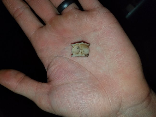

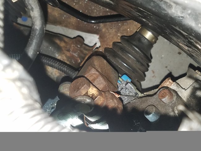

TRAVIS JONES
  • 24 POSTS
This piece
Sunday, August 28th, 2016 AT 7:36 PM
TRAVIS JONES
  • 24 POSTS
Where the notch is where it goes

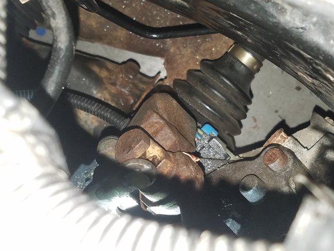

TRAVIS JONES
  • 24 POSTS
Another
Sunday, August 28th, 2016 AT 7:37 PM
TRAVIS JONES
  • 24 POSTS
SATURNTECH9
  • 30,869 POSTS
We need to replace that piece and lube everything up with deep creep.
Sunday, August 28th, 2016 AT 7:48 PM
