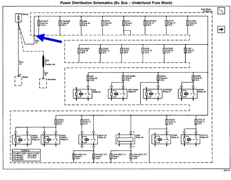

I disconnected the battery to replace a bad alternator which was further bench tested to confirm it was bad also left the key in the ignition overnight till I did the replacement, after replacing alternator and reconnecting the battery (which is good) I turned the key forward to find no power at all to anything also the key was stuck in acc. position I eventually discovered the ign. release button anyway from there I've checked and metered out everything I could think of; battery connection, battery wires, battery to ground, main 125-amp fuse and all fuses under the hood and in the back under the seat and all is good? The only fusible link I found is for the alternator and it too is good? What am I missing or not catching?
Something new. Should it be showing 12 volts from either side of the (good) 125-amp fuse to ground? Because I am not, and the battery is good also.

Where is your meter's negative probe, on the battery post or on the engine or body?
If it's on the engine, you're including the negative cable in the test. To narrow the list of suspects down, put the negative probe right on the battery's post, then double-check for 12 volts on the fuses. Unfortunately, with GM's side post design, we still can't exclude the negative cable to battery connection in the test, so for now, all we can do is assume it is okay.

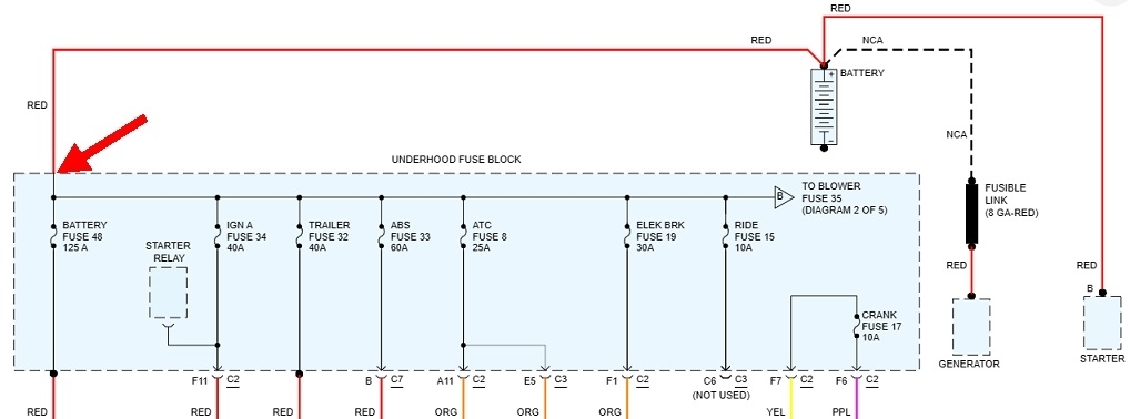

The best suspect is common to all brands of vehicles today. That is a loose or corroded connection where the smaller positive battery wire bolts to the under-hood fuse box. You can often get misleading or false results when using a digital voltmeter. To prevent that, turn on the headlight switch so current is trying to flow. That will make the bad connection show up better.
This first diagram is from GM. My blue arrow is pointing to the connection to check. If you don't have 12 volts on the 125-amp fuse or any of the others, that leaves very little to check. The defect has to be in those battery cables or connections.
If you do find 12 volts on the fuses, move the meter's negative probe to the engine, check again, then move it to a paint and rust-free point on the body sheet metal and try again. If either of those comes up with near 0 volts, the bad connection is in one of those wires. Look for the copper wire strands corroded away under the insulation next to the terminals where it can't be easily seen.

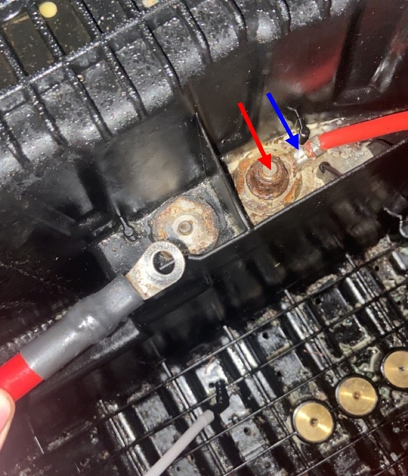

To verify if the connection is bad, follow the smaller positive battery wire down to the fuse box. This photo is from a different model. It's the stud we're interested in on your fuse box. Place one meter probe on the terminal, (blue arrow). Place the other probe on the very center of the stud, (red arrow), not on the nut or on the terminal. These two points are the same so you are supposed to find a difference of 0.00 volts there. That's when it's working properly. If you find anything other than 0.0 volts, that connection must be cleaned and tightened.
Now for the clinker. It is entirely possible right now to find 0.0 volts, but that's because no current is trying to flow. This equates to trying to find blockage in a garden hose without trying to run water through it. This is where you need to turn something on that would make current want to flow. The easiest is the head lights. When a higher current is needed, also turn on the ignition switch and the heater fan. Now recheck that voltage and I'm betting you're going to find as much as 12 volts. The only way that can be possible is if that connection is bad. Very often people will say they see tiny sparks when tugging on that wire.

Well, I figured it out.
The 12v positive from the battery to the fuse box (under the hood).
Is a small junction harness with a couple of connection points not used and caped off...been that way and I don't think it's factory
Whether way the connection from battery positive and the 125 fuse has a wire into a wire block with an allen screw to lock down the wire and that's where the corroded and slightly loose connection was....

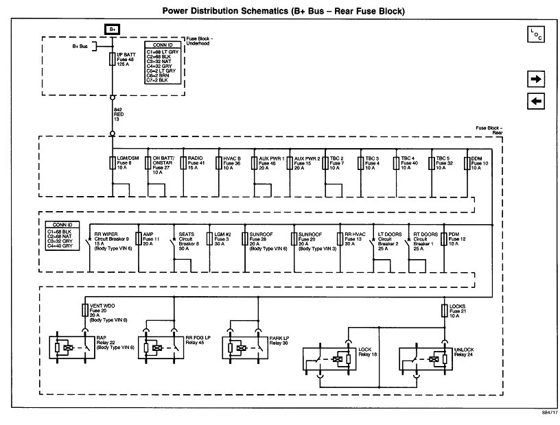

I have a question, that wire from positive to the 125 fuse what side of the fuse is correct?
Better yet does the 125 fuse the rear fuse box only? Or does it cover the front and back together?
The way it was wired only covers the rear fuse box...

If possible, I'd love to see a photo of the device you found.
That connection can be tested the same way, with the two meter probes just a fraction of an inch apart, with one on each side of the bad connection. That's how we find bad connections in starter circuits, by moving from one connection to the next until we find the one with any voltage higher than 0.0 volts. But here again, and especially in the high-current starter circuit, that undesirable voltage will only show up when the circuit is trying to operate. That means using a helper to turn the ignition switch to "crank", or by using a remote starter switch.

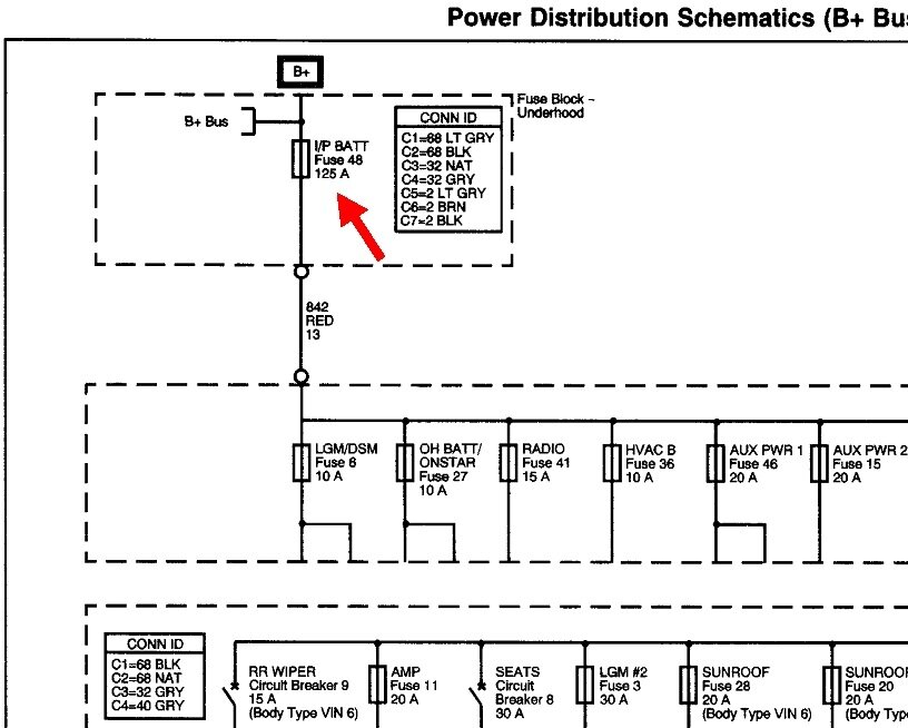

On most models, large fuses are for the generator's output circuit. They don't involve any other circuits from working normally. Here, however, in these diagrams, you are correct that this fuse does indeed feed the Rear Fuse Box. The first one shows the Rear Fuse Box, and at the top is the 125-amp fuse from the Under-Hood Fuse Box. In the second one, I just expanded it to make it easier to see the fuse at the top.
Here's the way I interpret this part of the diagram. At the very top in the square box, it says, "B+". That goes back to the early 1900s in the first days of portable radio. Tubes needed three voltages to operate. The "A" battery ran the filaments in the tubes. The "C" battery ran other circuitry. The "B" battery provided the high voltage used in the "plate" circuits for the tubes. (You won't be tested on this later), but the "B+" designation has stuck around all this time to denote the power source, in this case, the 12 volts coming directly from the battery. Once the current passes through some other part of the circuit, other than fuses, it is no longer called "B+".
The reason this is important is right above the fuse you see, "B+ Bus" going to the left. That means it is a buss bar that all the other fuses are connected to in that square box, which is the Under-Hood Fuse Box. Most importantly, that circuit taps off before the 125-amp fuse, so nothing there is protected by that large fuse.
Below that fuse, nothing is shown as tapping off inside the Under-Hood Fuse Box or after it, other than the red wire going to the Rear Fuse Box. If the 125-amp fuse was protecting something else not related to this diagram, it would have been noted the same way as that "B+ Bus" designation did. To say that a different way, if you remove the 125-amp fuse or if it has a bad connection, everything in the Rear Fuse Box would be dead, but only the circuits coming from that fuse box. Everything coming from a fuse in the Under-Hood Fuse Box would still operate normally.
To add one more point of confusion, when the Rear Fuse Box is dead, some circuits in the Under-Hood Fuse Box will also appear to be dead, but this can be misleading. I didn't research this to verify it, but it is very common in most models to have a fuse inside the vehicle feeding one of the three or four parts of the ignition switch, including the part that turns on the low-current side of the starter relay. That relay switches on the medium-current side of the starter solenoid, (bolted onto the starter motor). That medium-current part of the system is fused in the Under-Hood Fuse Box. There's actually nothing wrong with the medium-current part of the system. It just doesn't turn on because the low-current part is not working.
