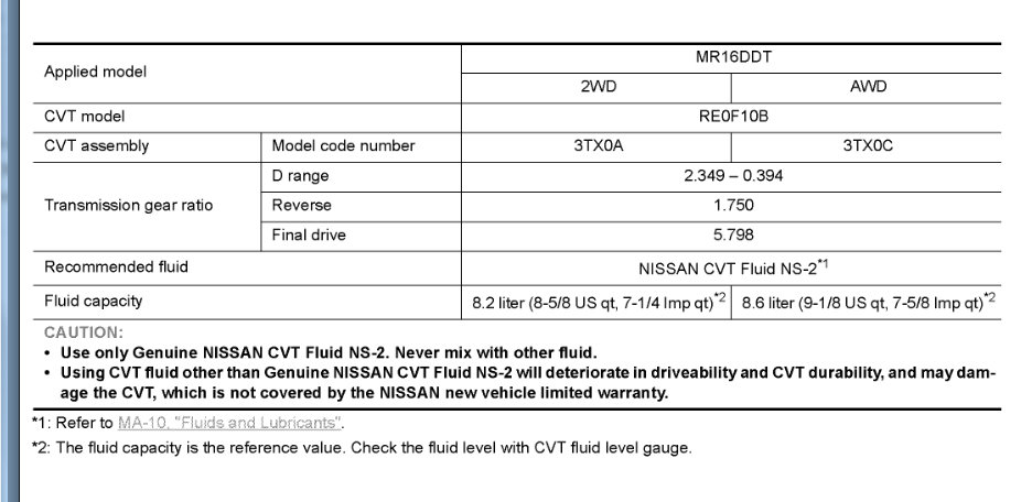

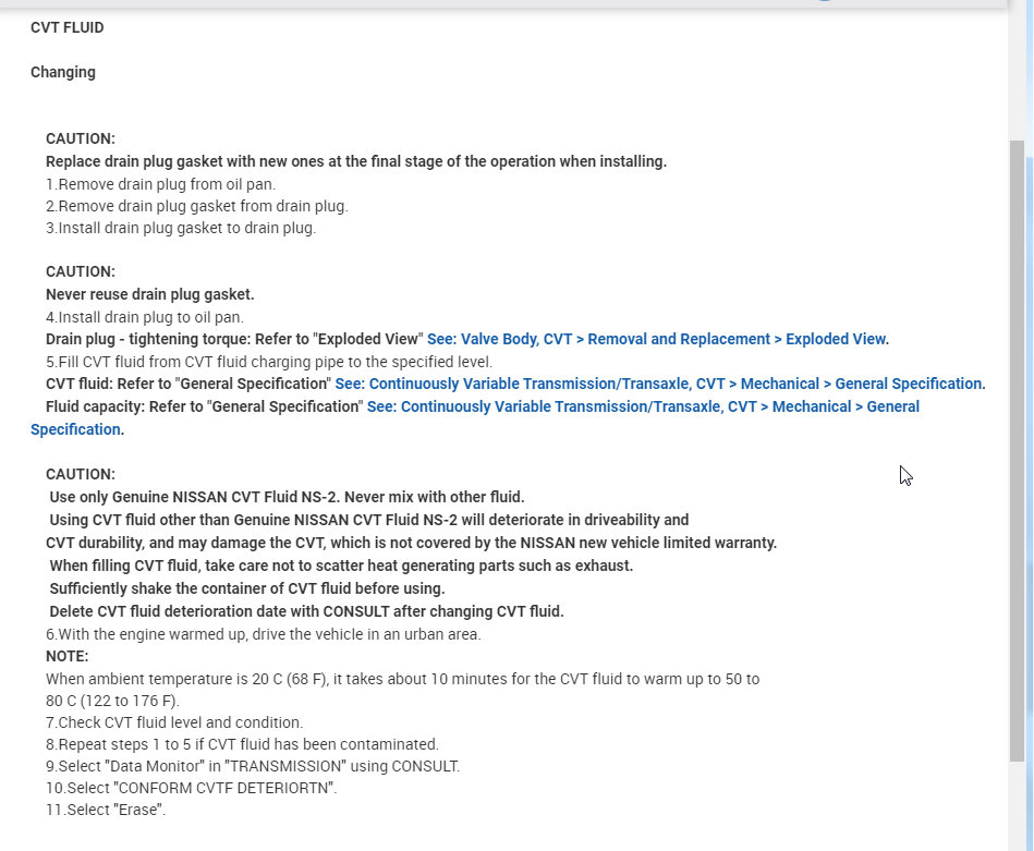

So you are on the right path with a slipping clutch. However, you do not have a traditional transmission for the clutch to be slipping. You actually have a steel belt inside the transmission that when the fluid breaks down and the unit is hot the belt starts slipping and the PCM will actually shift the engine to limp mode to protect it from damage.
I would recommend changing the fluid out because this is called high temperature fail safe mode.
If changing the fluid doesn't solve this then the only way to fix it is replace the transmission. However, as I said before, if this only does it on long drives like this, don't worry about it until it is an issue during your normal driving.
I would still recommend changing the fluid if you have not done so recently.
