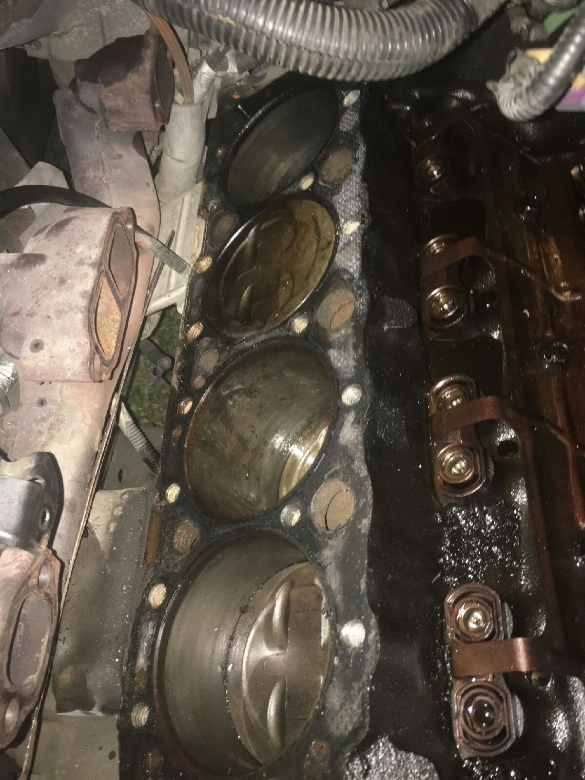

Vortec engine. I had a radiator leak, the guy drove it after it overheated. The dash gauge said "check gauges" The gauge says red all the time even when the truck is off. Turn back on the truck has not even reached operating temperature and the gauge still is in the red. He changed the radiator but might be too late. There is white smoke out the tail pipe and it appears to be leaking coolant from the edge of the muffler itself.
Mechanics are saying to replace the entire engine. But, they have not inspected the vehicle just off the back they are saying to replace the engine.
Can it be a blown head gasket? Or is it possible the block faces are warped or the cylinder heads are warped. Or if there are any other possibilities can anyone share?

Yes, it can be just a blown head gasket which if they found which side they can do the one. Or it is burnt to a crisp and everything is cracked it all depends on how bad it is. By the sounds of it with the temp gauge pegged it probably needs a motor. They do not want to gamble it.

So here is an update we did a short compression test like I mean seconds short cause we saw water coming out of the spark plug ports
youtube. Com/watch?V=GhPRAh0zyp8
we removed the head on one side still have to do the other side but look at this engine block and this is after we soaked all the coolant out of all the walls

Nice work, the youtube URL does not work can you double check the address for me please? Can we get more pictures of the engines condition (cylinder walls) this can tell us how much life is left in the engine.

Yeah it turns out the head is cracked right were the valve seats and the gasket its really burnt up bad.
