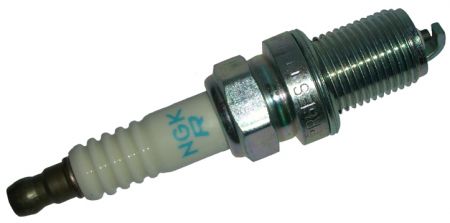

I replaced the 1,3,5 sparks plugs and wiring and now the care seems to shake more than ever. It has some power problems as well, when I step on the gas it will sometimes keep the same RPM till it goes to a lower gear or will jerk up and down in power. I have hecked the 3 spark plugs i replaced and they looks like the are fine. I did get a higher quality spark plug from auto zone which isn't the tranditional one.
New Ones
https://www.2carpros.com/forum/automotive_pictures/240957_sparknew_1.jpg
Old Ones
https://www.2carpros.com/forum/automotive_pictures/240957_sparkold_1.jpg
I also replaed 1,3,5's wiring with better duralast wiring.
Friday, August 23rd, 2019 AT 1:35 PM (Merged)
DREWDODSON89
I also forgot to add that it is now idling at a higher rpm.
MMPRINCE4000
  • 8,548 POSTS
You should replace all the plugs and wires on a major tune up.
You should use the same plug, not mix them up.
The high idle is more than likely a vacuum leak, which could have been caused when installing the new plugs (cracked, or disconnected a vacuum line).
Put the old plugs back in and see if it helps. You should also check coil output, some shops have testers which will measure coil output.

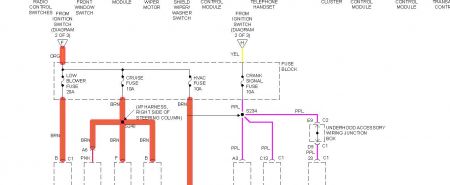

1998 Buick regal has no power to the fuse block for several circuits. Heated mirror, cruise control, hvac and low blower circuits are all dead. Naturally, my cruise control, air conditioning system, and low beam headlights do not work.
My windshield wipers just stopped working, and the fuse tests good. How do I test the motor? I also just got around to replacing the ignition switch, (after the windshield wipers quit), and that did not fix the problem. Is there another problem that could cause this problem?
  • 75,992 POSTS
Hi dockrat100, Welcome to 2carpros and TY for the donation
. heated mirror, cruise control, hvac and low blower circuits are all dead.
Check and test ignition maxi fuse 40amp if okay either the ignition switch is defective or the orange wire is open between the ign switch and the fuse block. See EWD
https://www.2carpros.com/forum/automotive_pictures/12900_r1_7.jpg
https://www.2carpros.com/forum/automotive_pictures/12900_r2_7.jpg
DOCKRAT100
  • 8 POSTS
40 amp fuse checks out ok. There is not power from the orange wire at the ignition switch.
Bad ignition switch?
I did run a jumper wire from the cigarette lighter directly to the hvac fuse and the compressor still doesn't cycle on. (I still need to check the freon level to see if it isn't a low pressure switch.)
  • 75,992 POSTS
Ignition switch is defectve
