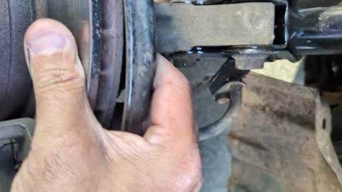

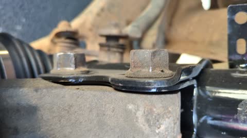

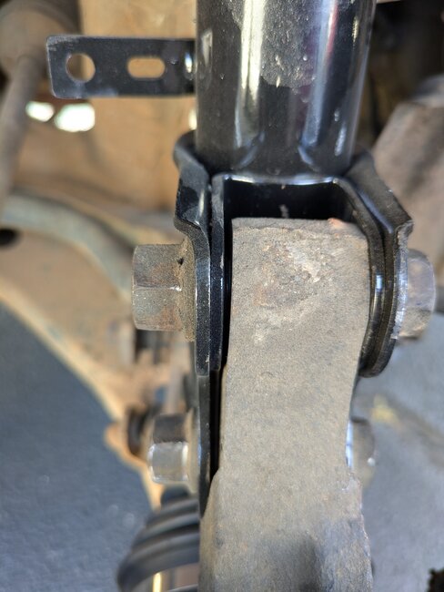

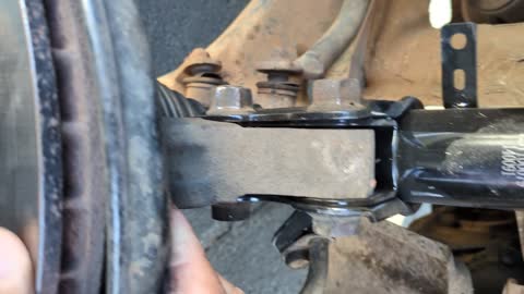

So I'm following up to this old question linked below: https://www.2carpros.com/questions/strut-safety.
I had the strut and axle replaced at the same time. But now the car is shimmying. Looks like he left the bolts loose at the spindle. Please look at the pics and vids. Also, it'd be nice to know what size the nuts and bolts are so I can be sure I have them handy before taking the wheel off again

Yeah so the shaking back and forth of the tire is what brought me here. I was able to shake it on the ground. I compared it to the other side and there was quite a difference. So I then jacked it up and shook more. Still going. Then I took the wheel off to see if I could see where the movement was. It's definitely at the spot where the strut bolts on to the spindle. Looking closer I can see about 1/16 of an inch of space between the strut and the spindle where the bolts are. I'm thinking there shouldn't be any, right?

Look at the heads of the two bolts for the number "11". Then look for the dots I mentioned. If there's one dot, they show that to the left of the number. If there's two dots, the second one will be at the 4 o'clock position. If there's three dots, the third one will be at the 2 o'clock position. Based on interpreting the instructions, the more dots, the thinner the bolt, and the more play there will be.
The idea is when a skinnier bolt is installed, it provides the means of adjusting camber by pushing or pulling on top of the tire. Once in position, the bolts must be tightened sufficiently to hold the spindle. The clamping force is the only thing preventing the adjustment from slipping over bumpy roads.
Camber has to be set to specs very precisely to get best tire wear and to prevent a pull to one side. With this type of adjustment method, the job can be exceedingly tedious and frustrating. We never hit it just right the first time. How long it takes to get it right depends on how picky the mechanic is and how many times he tweaks the adjustment.
As I tried to describe, tipping the spindle to adjust camber also moves the steering arm on the spindle, so the steering linkage must be adjusted too. That is always the last step in the alignment procedure. On your model, with rack and pinion steering, that adjustment for "toe" is the threaded connection where the outer tie rod end is screwed onto the inner tie rod end. Along with the same adjustment on the other side, those set the two front wheels parallel to each other and center the steering wheel.
At this point, since you have the wheel off already, I would pull the spindle out about halfway toward you, then tighten the bolts. That should get camber reasonably close enough to allow you to drive to the alignment shop. The actual adjustment during the alignment is very tiny between "out of specs and "in specs"; almost too small to see by eye. That's why you'll only be able to get is somewhat close by yourself.
