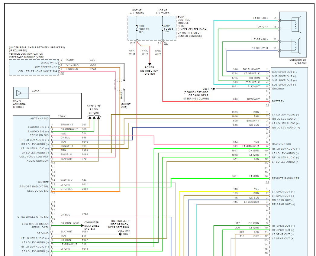

Looking for a good wiring diagram or wire description so I can hard wire my aftermarket stereo in place of the stock unit.

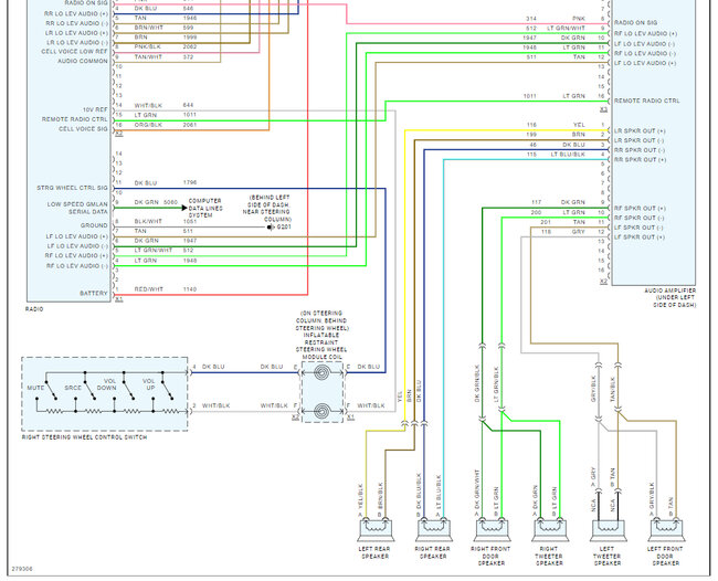

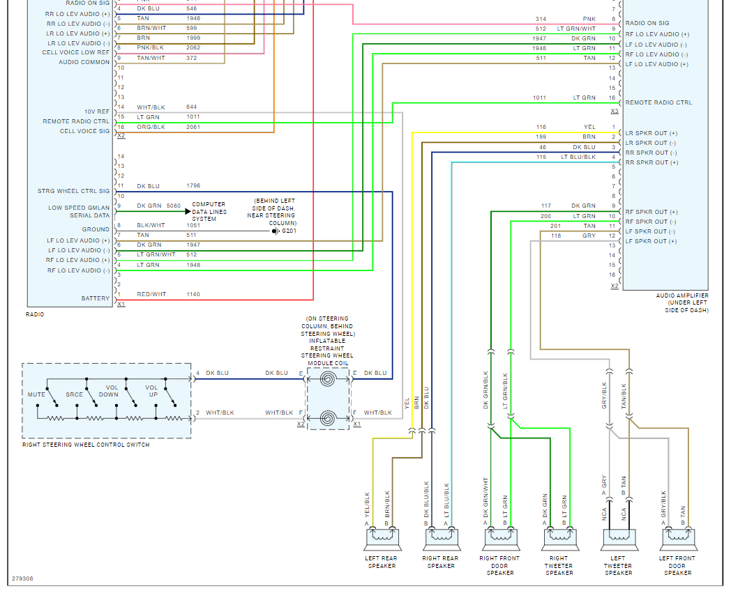

Sure, here are the wiring diagrams for the radio with an amplifier. Check out the images (below). Let us know if you need anything else.

Is there anyway to bypass the GMLAN wire or will it affect much if I leave it disconnected?

The GMLAN wire is part of the General Motors Local Area Network (GMLAN), a communication network so you better leave it.
