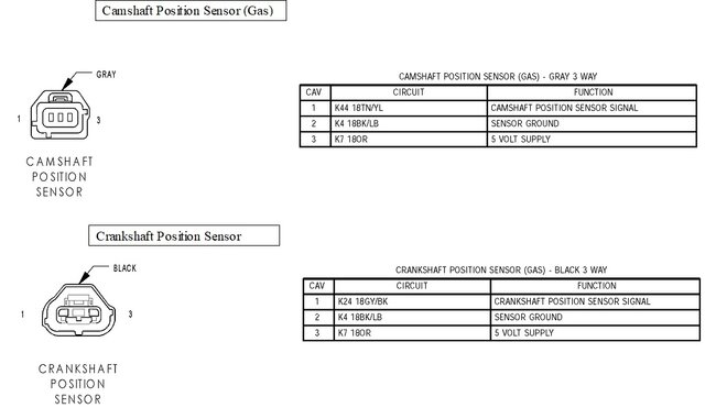

Looking for diagram of crankshaft position sensor connector wiring?
2002 JEEP GRAND CHEROKEE
158,000 MILES • 4.7L • V8 • 2WD • AUTOMATIC
MIA MORRIS
We have been told our crankshaft position sensor and camshaft sensor are not testing correctly on diagnosis. We are changing the parts now using OEM parts. We previously changed the crankshaft position sensor connector/wires. I want to double check the wiring is correct. So, I am looking for a diagram of the wire set up. Thank you

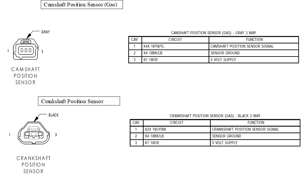

Here's the two connector views. Check out the images (below). Let us know if you need anything else.
