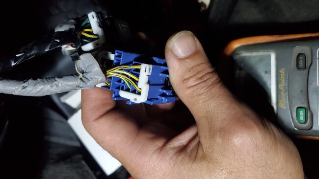

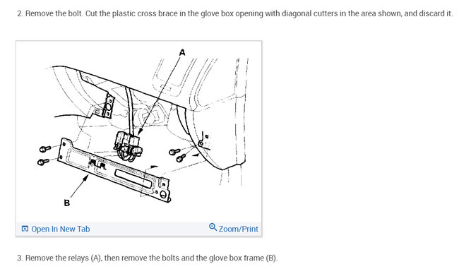

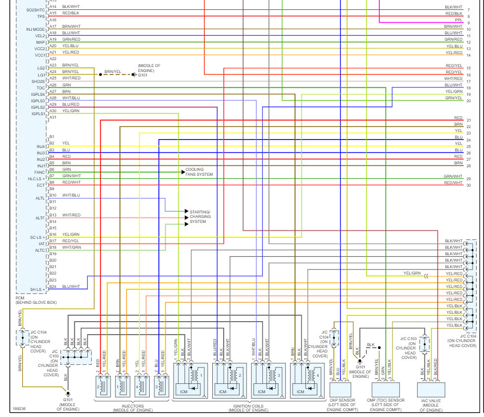

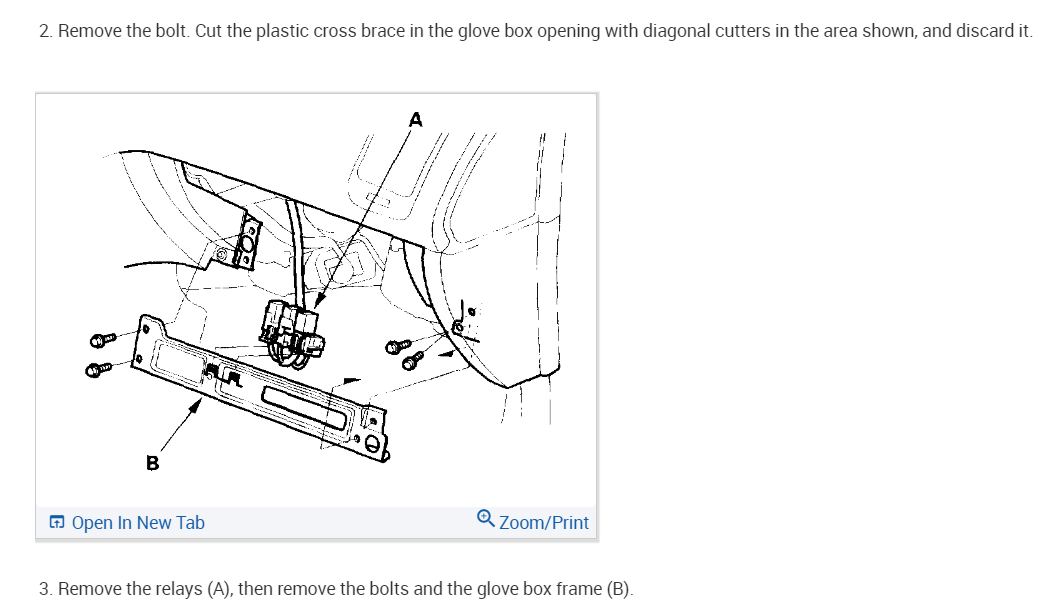

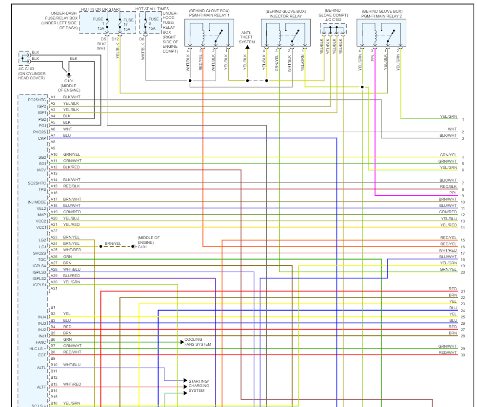

Replace the crank sensor and H2o sensor and now it starts soon but dies out on its own. The fuel pump is good, and PSI is above 40 when cranking. But I have to jump the relay. Checked for ignition power at relay and it's good but not getting the negative that the yellow/black wire needs? I moved relays around with ignition on and still the same. Jump relay = open the relay and push the tab towards the coil. Did send the ECM out and they found nothing wrong with it? If possible, to get the wiring diagram on the four relays behind the glove box?

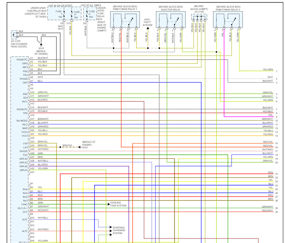

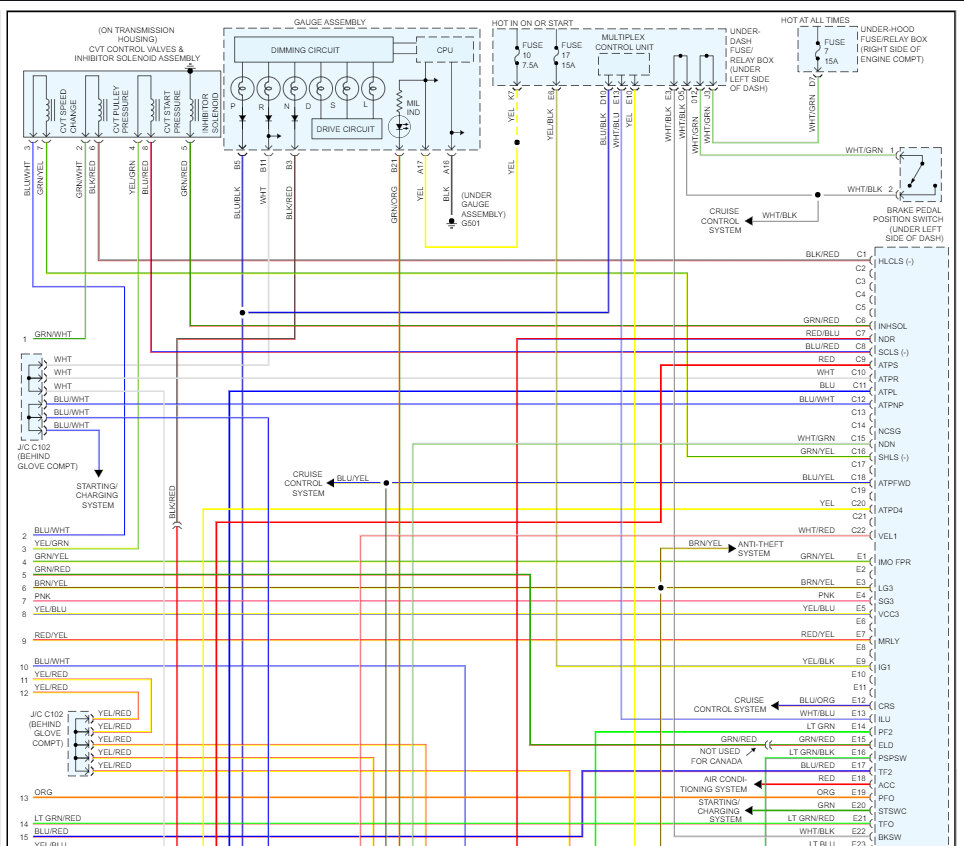

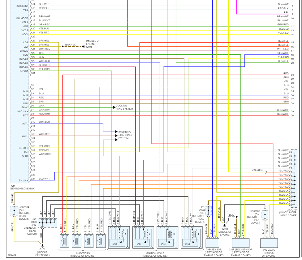

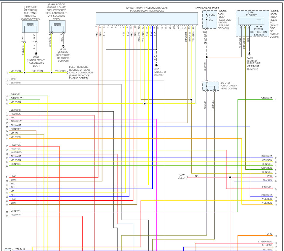

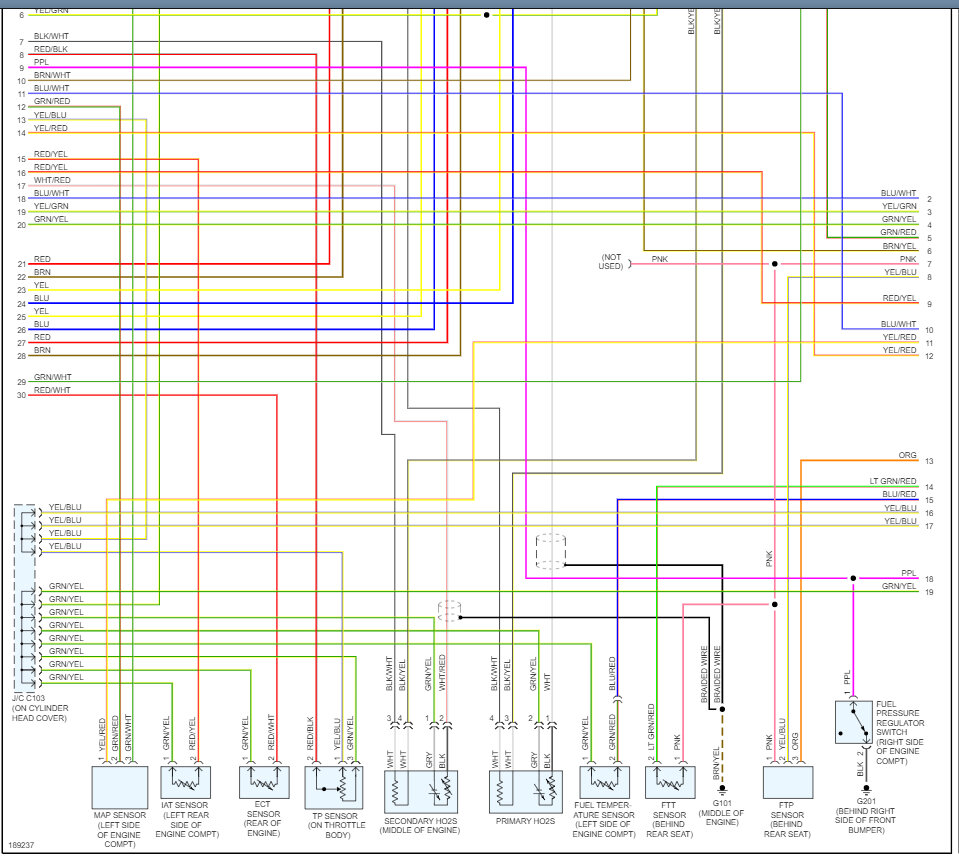

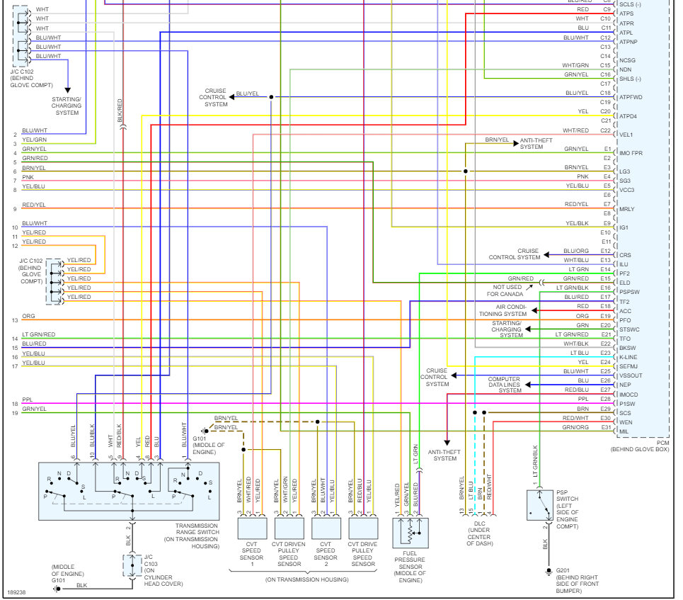

Does the engine still have the same codes, did you clear them? Also, here are the engine wiring diagrams so you can see how the system works.
This guide can help test the connections:
Thursday, June 1st, 2023 AT 10:38 AM

Hello Ken L I would like to know if I can get the image you had share in a printable format. Thank you
Tuesday, June 6th, 2023 AT 9:39 AM
KEN L
  • MASTER CERTIFIED MECHANIC
  • 55,512 POSTS
I would just print the images above which is the format we have access to.
Wednesday, June 7th, 2023 AT 10:24 AM
ETON250
  • 8 POSTS
Okay, I will give it a shot on printing the images. Thank you

Hello Ken, thank you for the wiring diagram. I replaced the crank sensor and also checked for current at the fuel pump relay, now the fuel pump is not turning on when the ignition is turned on or cranking and came to notice that the wiring diagram you had shared does not match to what's on the car.

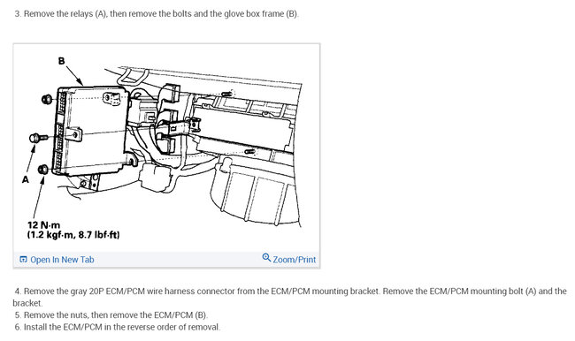

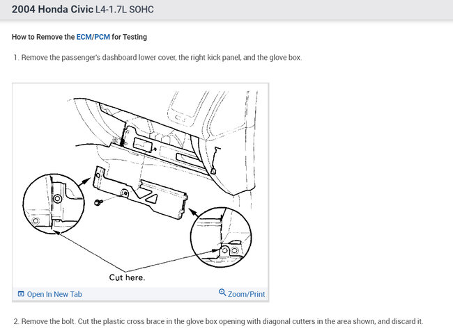

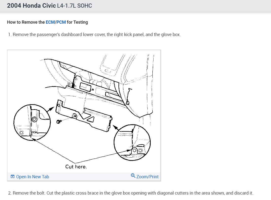

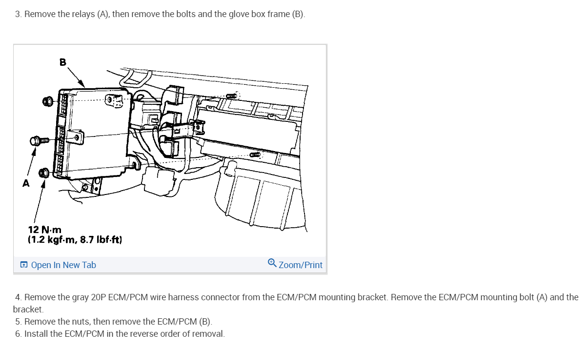

If the fuel pump turned on before by just turning the ignition key on. Then you may have a bad PCM. Let's do a CAN scan, you can get a CAN scanner (Controller Area Network) which will work on most cars from Amazon.
here is a video to show you how:
https://youtu.be/u-4syLc-ifQ
This should give us a better idea of the problem. Here is how to change the PCM out in case you get a code for it, you can get a preprogrammed unit by searching Google or Ebay.

Also, had sent the PCM out to get checked and they found nothing wrong with it. Again, the car started on its own but very long crank cycle and with a jumped fuel pump relay resolution was limp mode.
