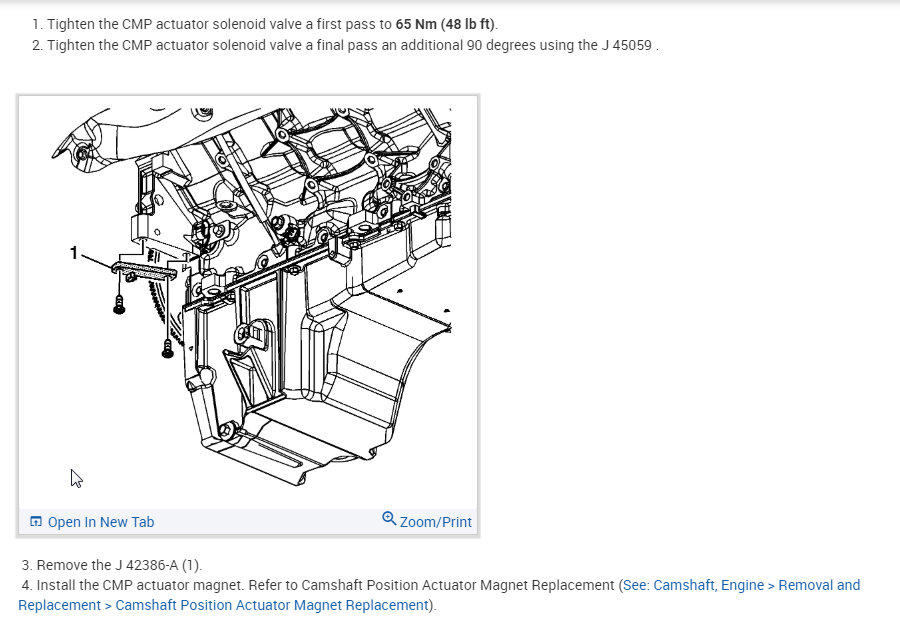

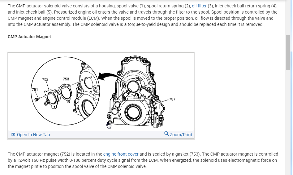

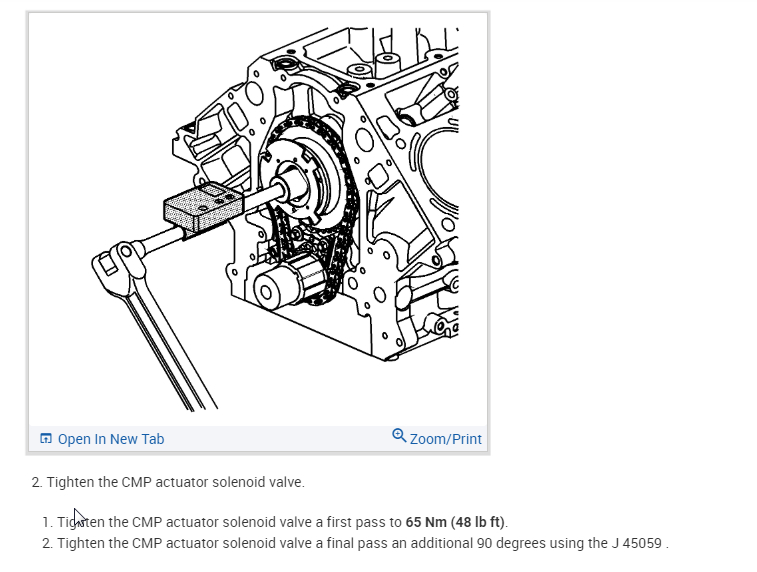

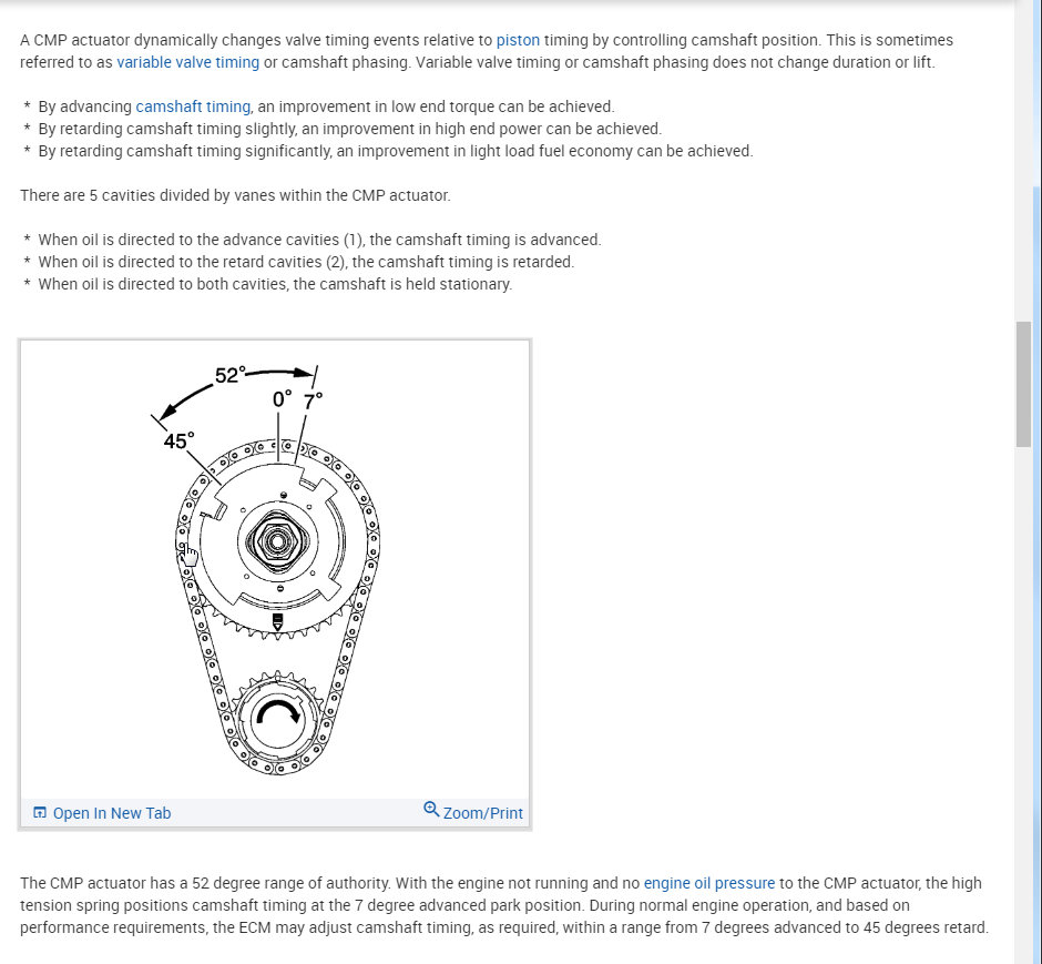

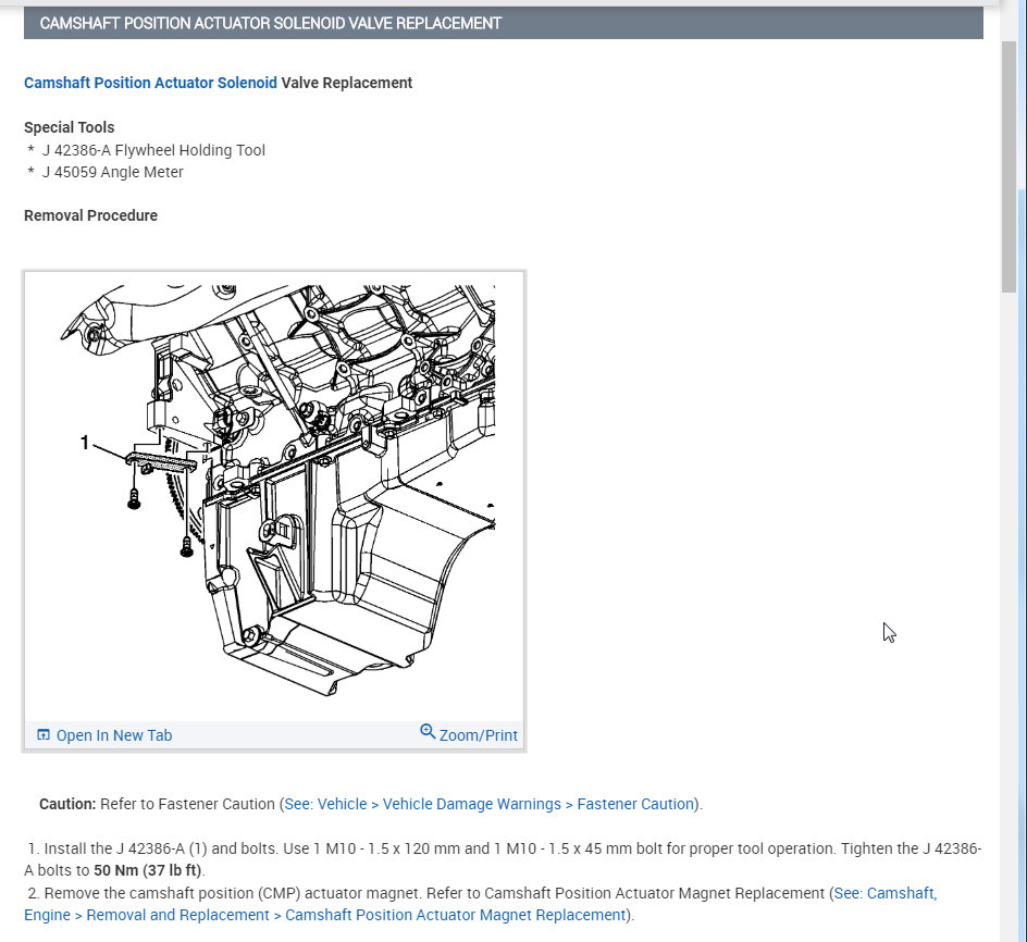

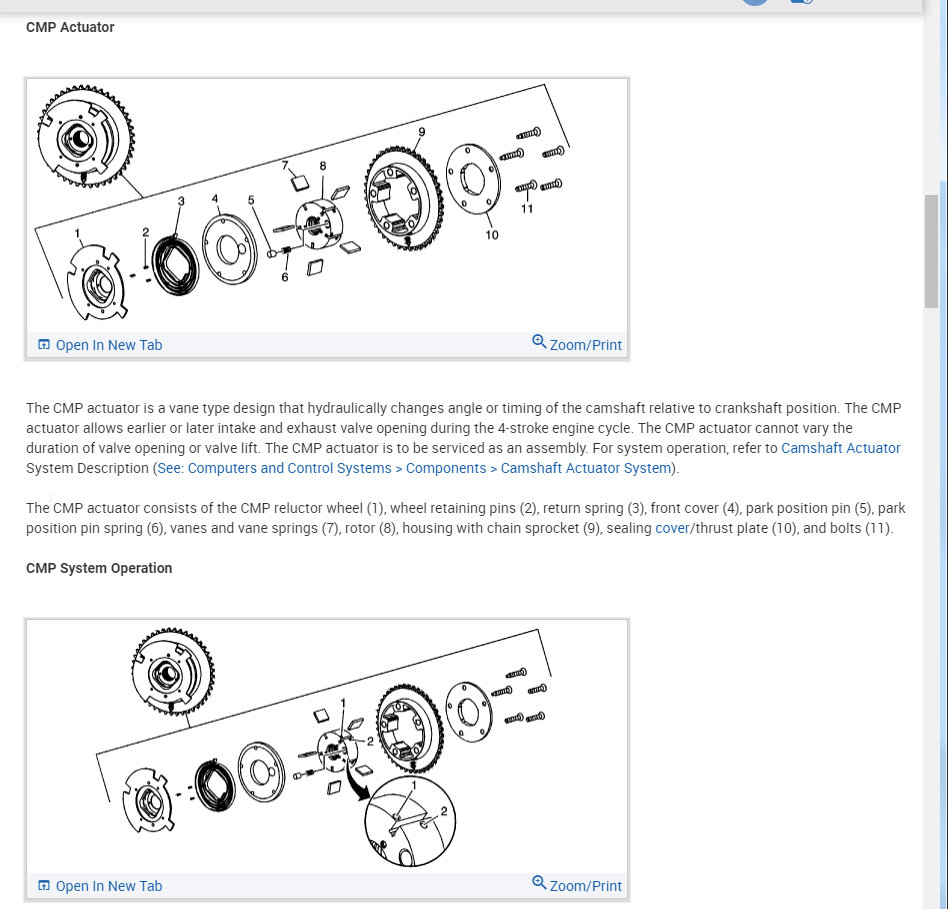

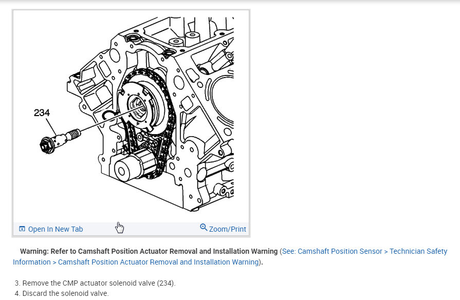

Where is the location of the intake variable valve timing solenoid?
Dec 20, 2019 at 3:41 PM
  • CAR REPAIR CONTRIBUTOR

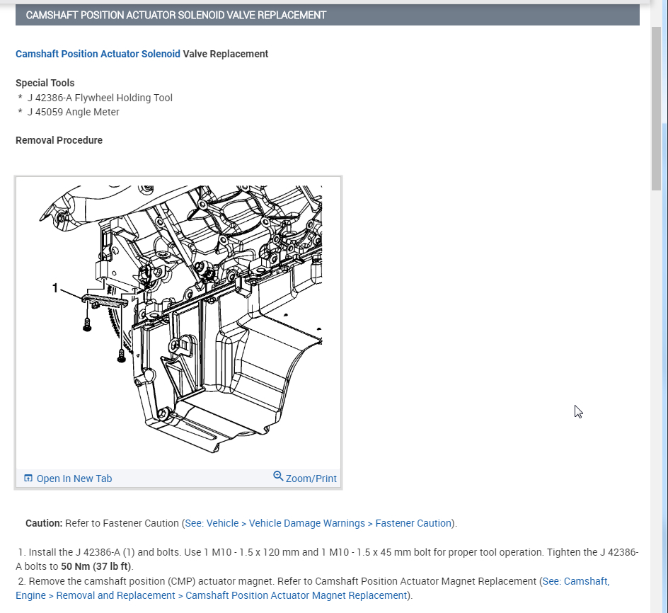

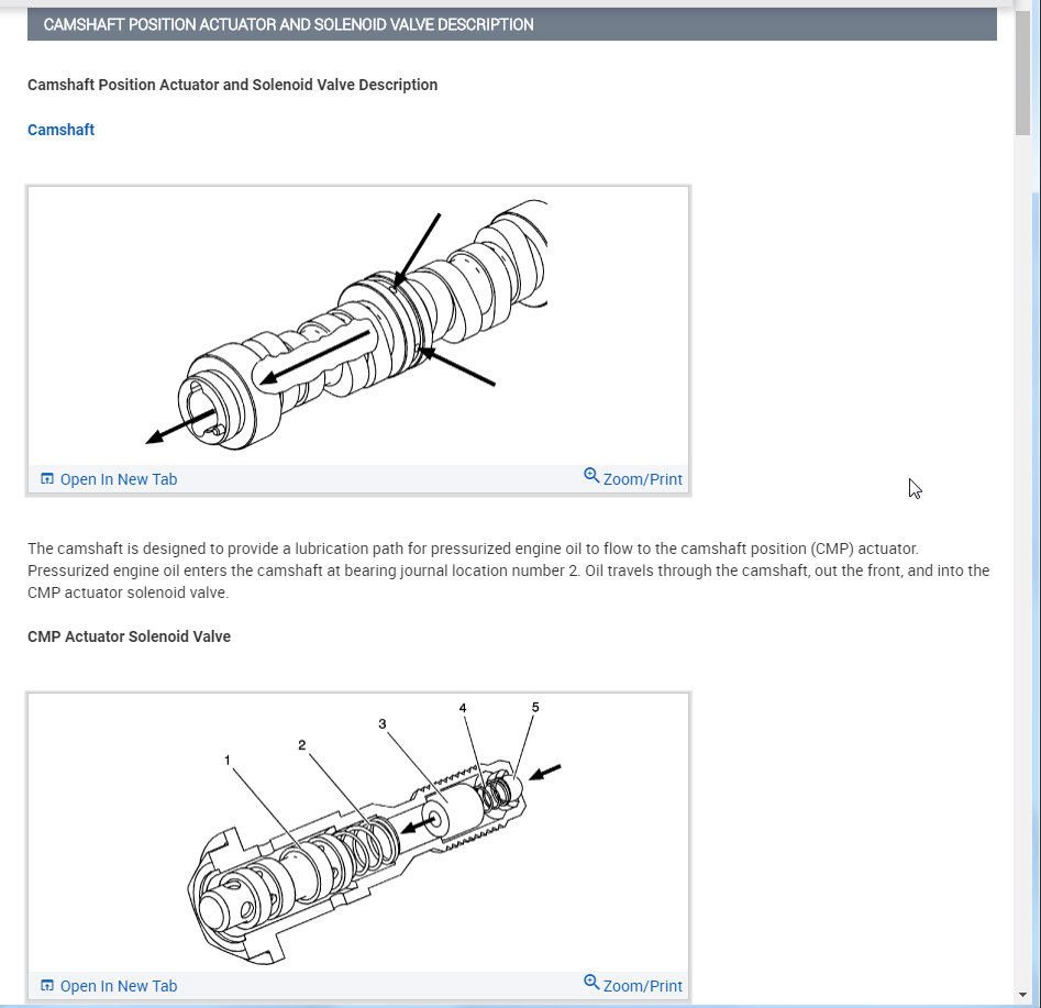

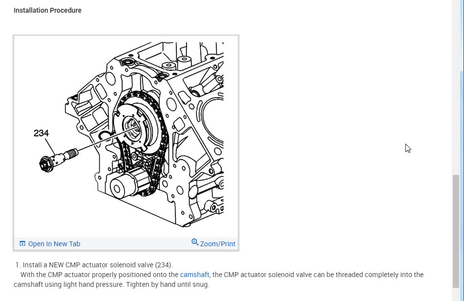

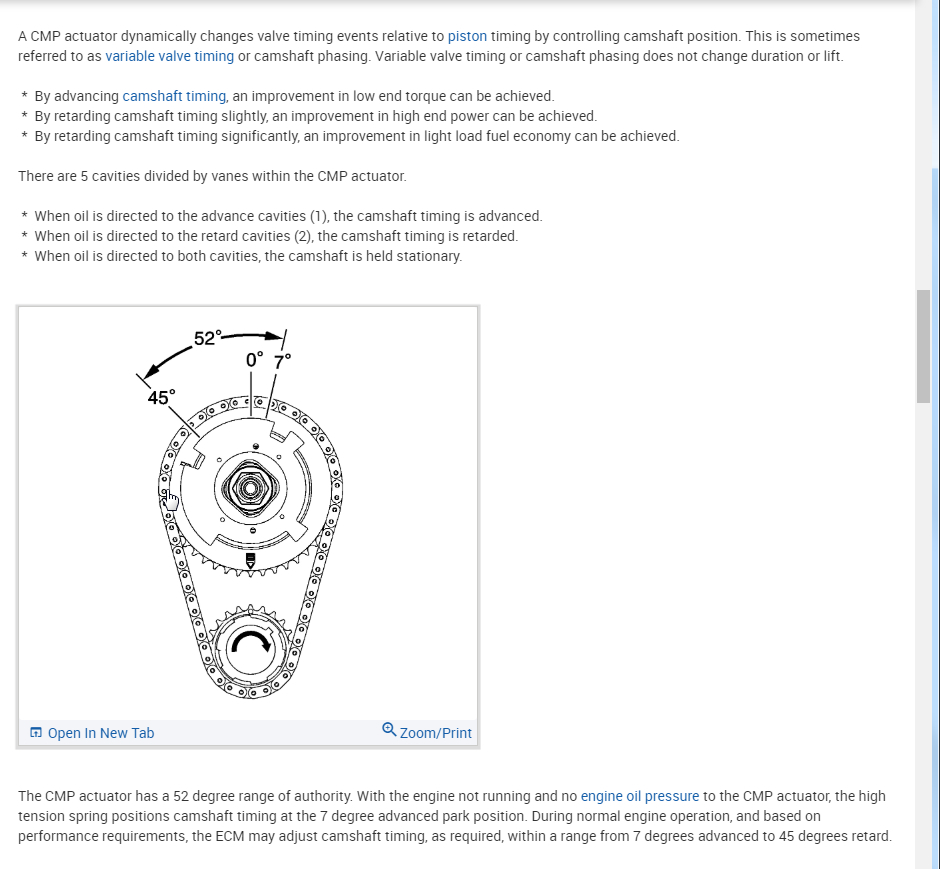

Here is the info and the process to replace the Camshaft position actuator solenoid valve. Let me know if you need more info. Check out the diagrams (Below). Please let us know what happens. Thanks
