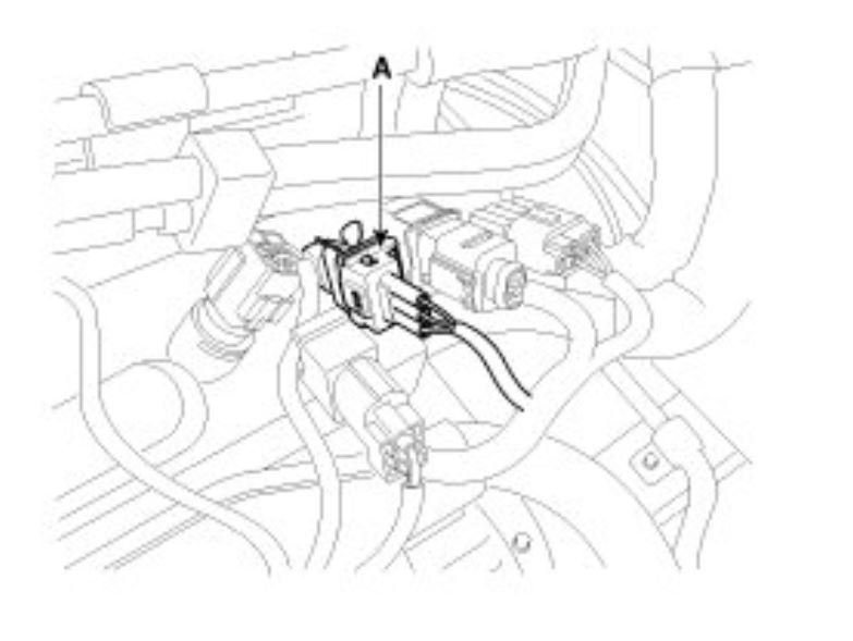

I have been trying to locate the sensor for the crank but no luck as access is tight, is it behind the starter motor?
Mar 29, 2021 at 1:50 PM
  • CAR REPAIR CONTRIBUTOR
Good afternoon,

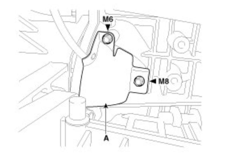

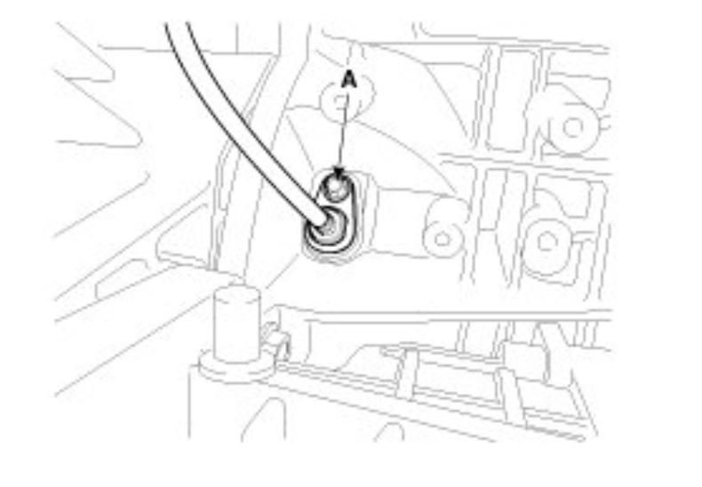

The sensor is behind a plate at the back of the block. I attached the procedure and pictures for you of the procedure.

1. Turn the ignition switch OFF and disconnect the battery negative (-) cable.
2. Disconnect the crankshaft position sensor connector (A).
3. Remove the protector (A).
4. Remove the installation bolt (A), and then remove the crankshaft position sensor.

- Insert the sensor in the installation hole and be careful not to damage.
1. Installation is reverse of removal.
Crankshaft position sensor installation bolt:9.8 - 11.8 N.m (1.0 - 1.2 kgf.m, 7.2 - 8.7 lb-ft)
Crankshaft position sensor protector installation bolt (M6):9.8 - 11.8 N.m (1.0 - 1.2 kgf.m, 7.2 - 8.7 lb-ft)
Crankshaft position sensor protector installation bolt (M8):18.6 - 23.5 N.m (1.9 - 2.4 kgf.m, 13.7 - 17.4 lb-ft)
