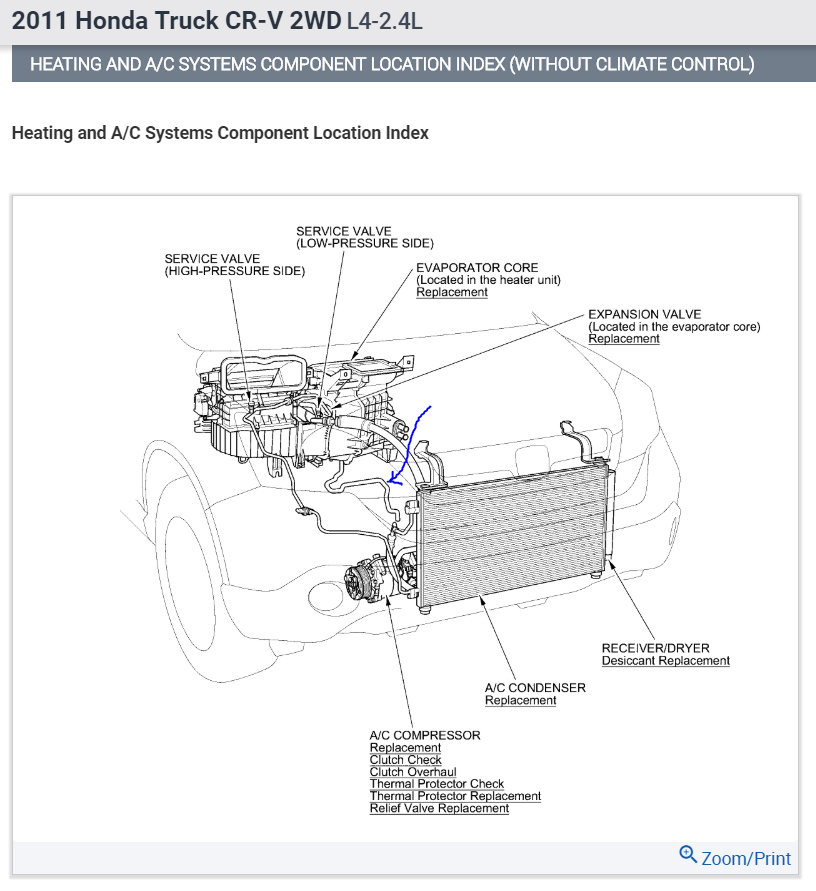

Location of AC drain hole
2011 HONDA CRV
15,000 MILES
EDO AJ
Water leaking inside car, comes out from foot compartment below dashboard.
I know that problem is because EVAP waste stuck inside AC drain hose.
What I want to know, where is exactly location (if you have got pictures will be more helpful) AC drain pipe?

The evaporator water drain is on the passengers side down low on the firewall a little toward the center. Look for a rubber hose open at the end here is a picture of the hose below.
