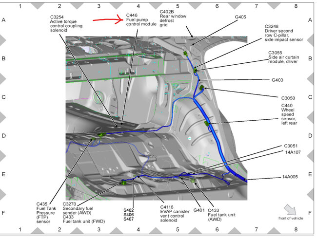

Where is the fuel pump control module located?
2011 LINCOLN MKZ
110,000 MILES • V6 • AUTOMATIC
BR8KN
I need to know where the fuel pump control module is located on or in my car so I can replace it with the part that I got.

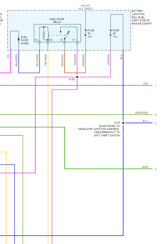

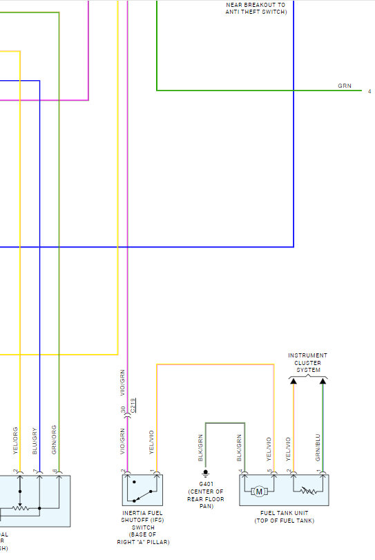

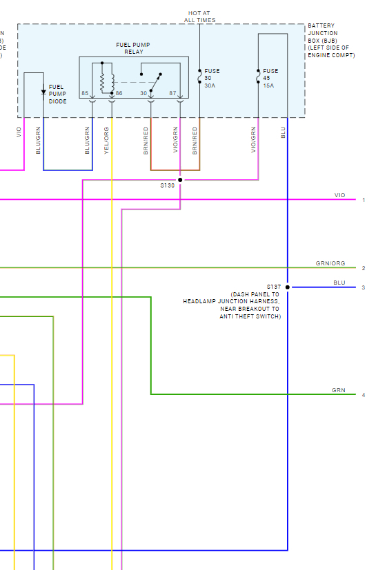

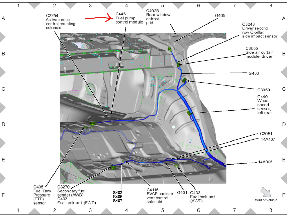

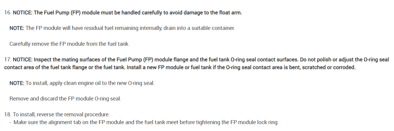

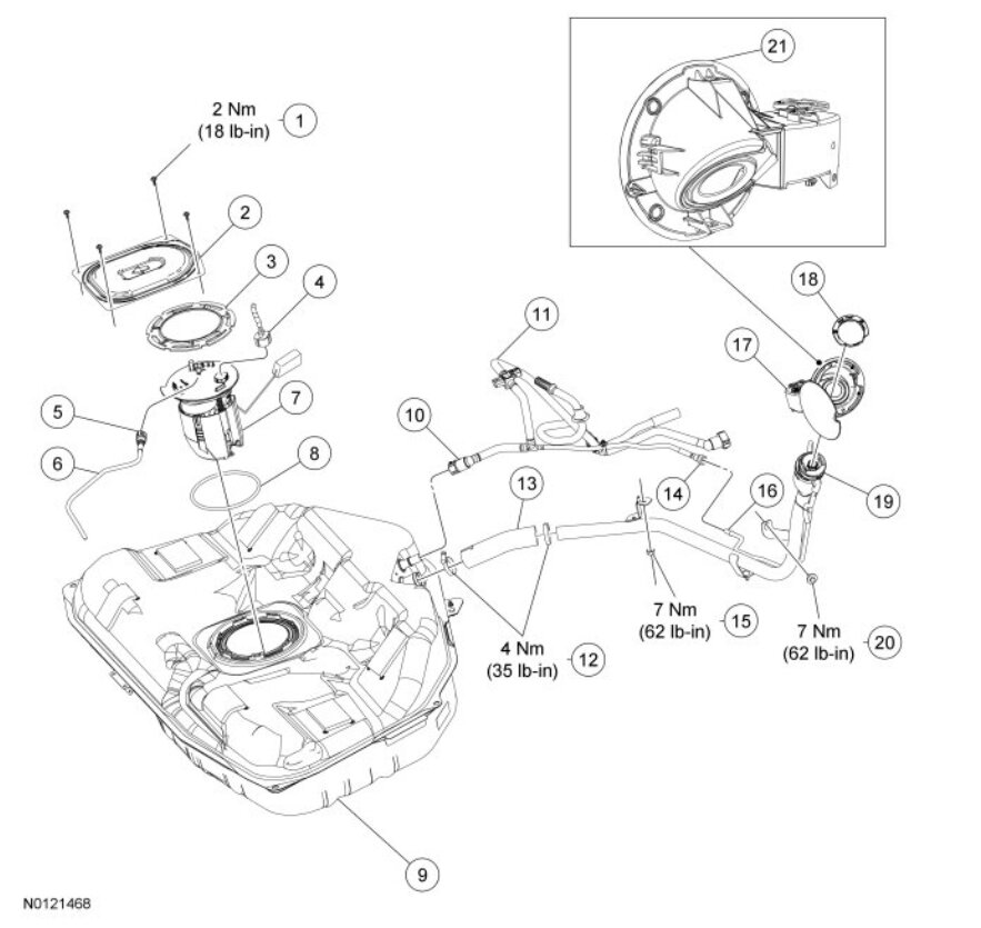

It could be the fuel pump is out but let's give it a go, fuel pump control module is located behind the rear seat in the trunk, but I need to say the fuel pump control wiring does not show a fuel pump control module, only an inertia switch and relay. Here are the wiring diagrams so you can see. Check out the images (below). Please upload pictures or videos in your response to any problems so we can see what to help you with.

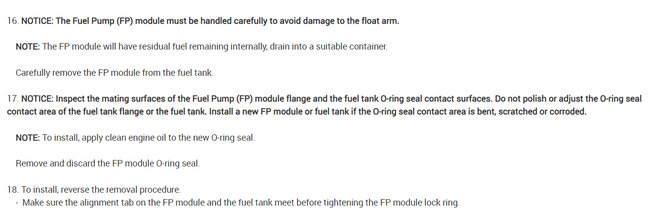

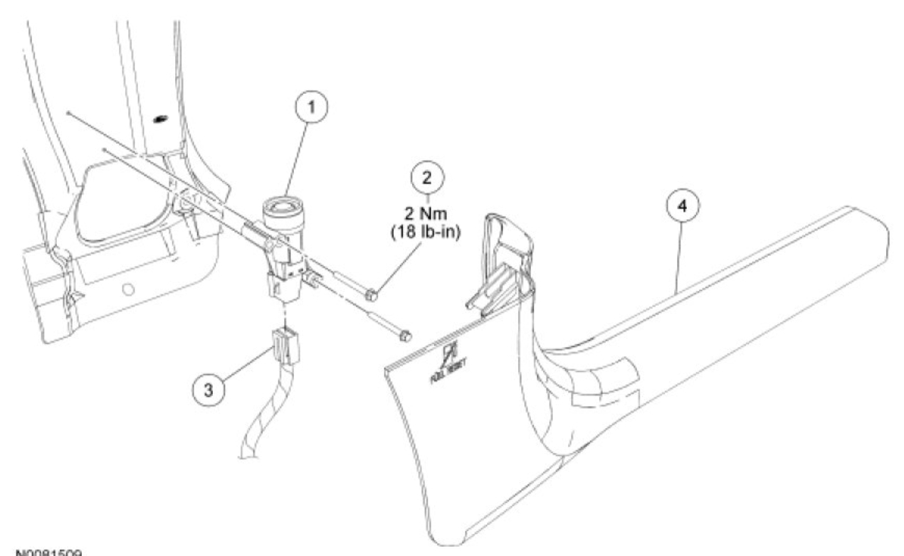

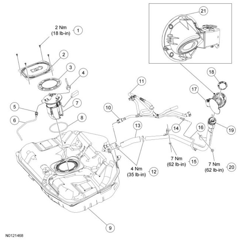

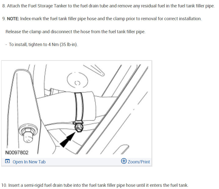

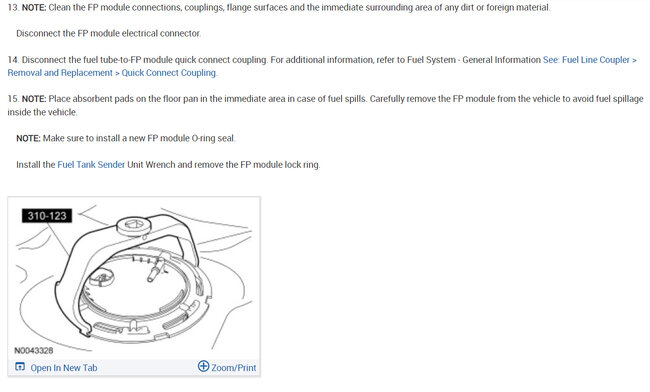

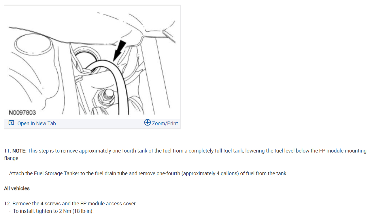

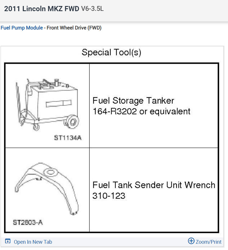

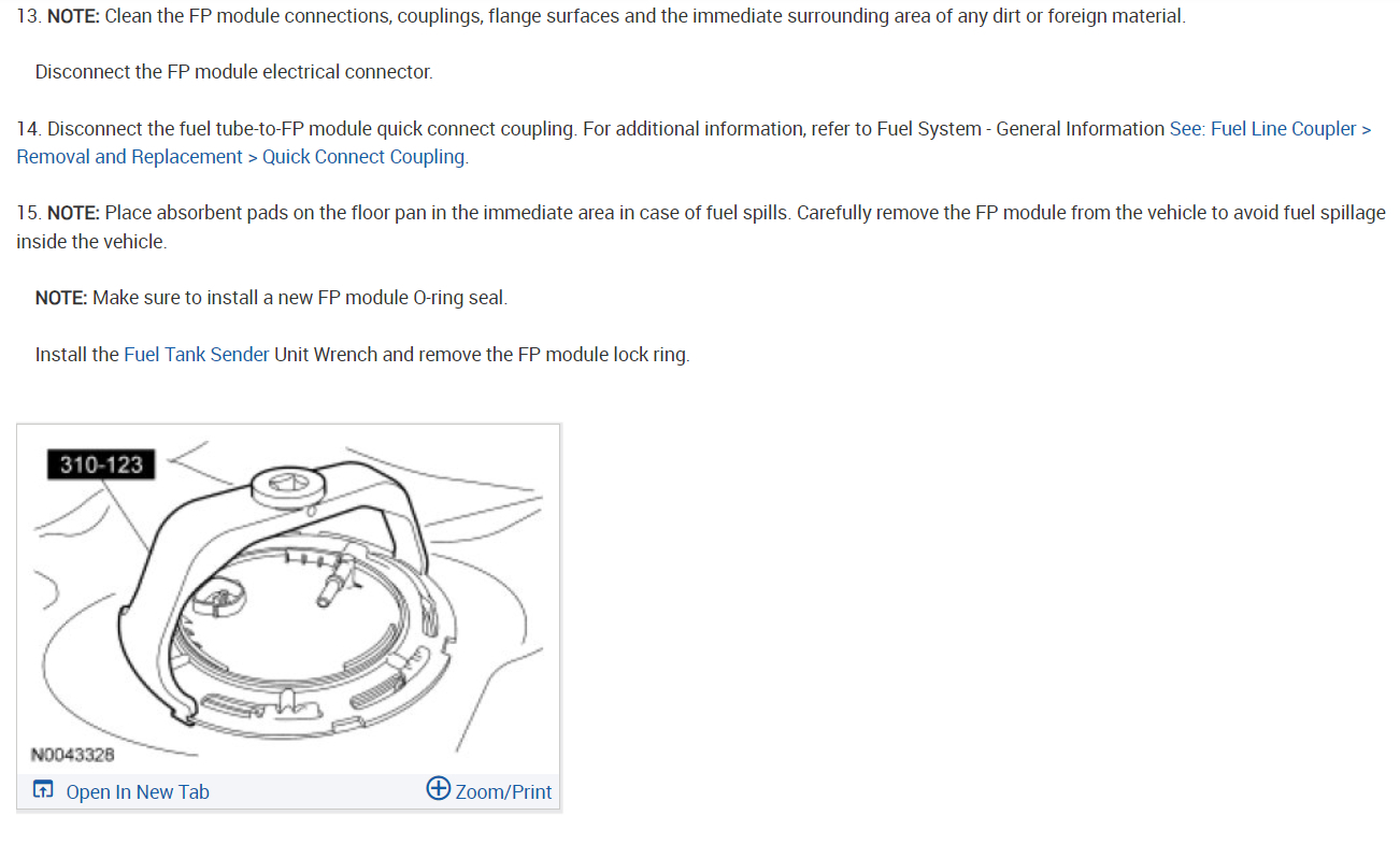

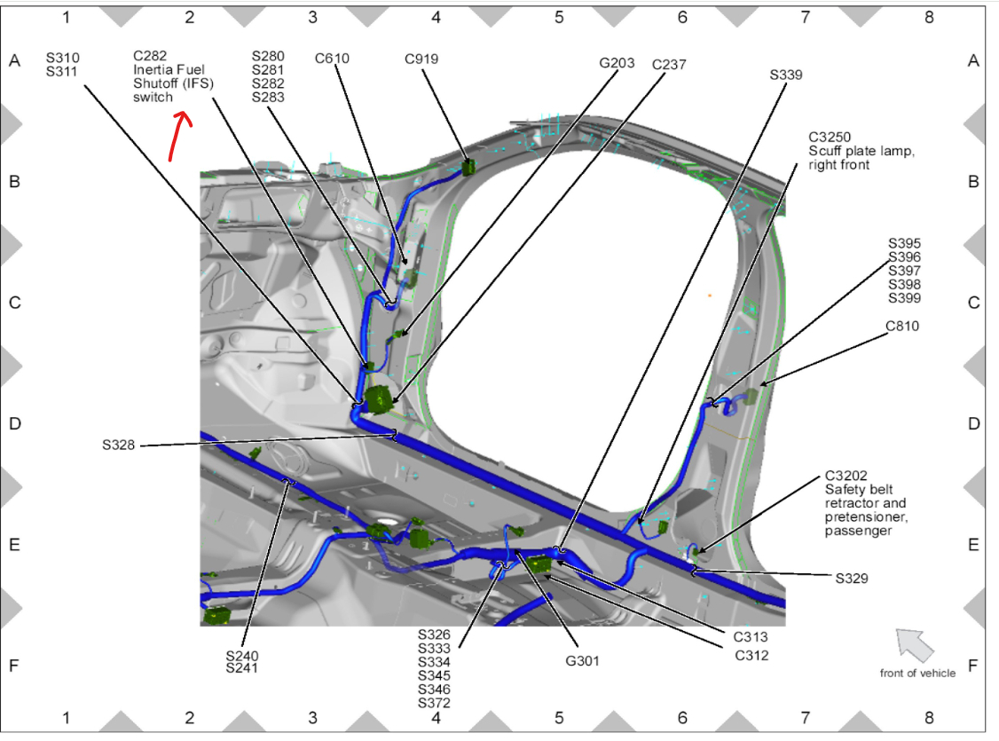

This sounds like a typical fuel pump failure, have the car in a quiet place, turn the ignition on without cranking the engine over to see if you hear the fuel pump run, if not the pump has probably gone bad but to be sure you can check for power at the inertia switch.
If it has power the pump is bad, here is the location of both parts so you can fix the problem. The inertia switch should have power at both wires when cranking. Check out the images (below). Please let us know what happens.
