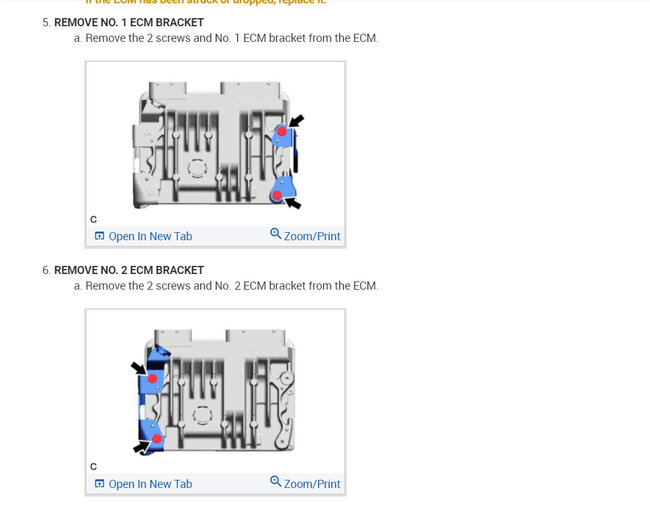

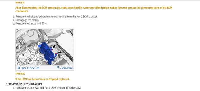

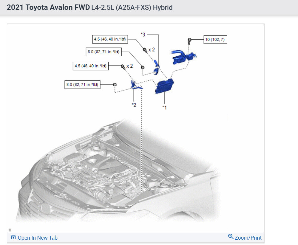

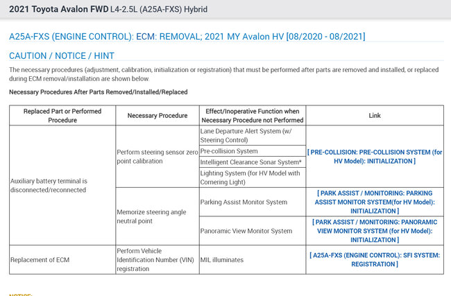

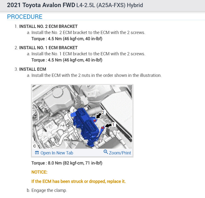

I’m Try­ing To Lo­cate The Com­puter As­sem­bly, Dri­ving Sup­port Unit (part# 88150-07030) on A 2021 Toy­ota Avalon Hybrid. Can any­one help me lo­cate the unit? I removed the glove box but couldn't find it behind the glove box. Any help is appreciated—many thanks for considering my request.

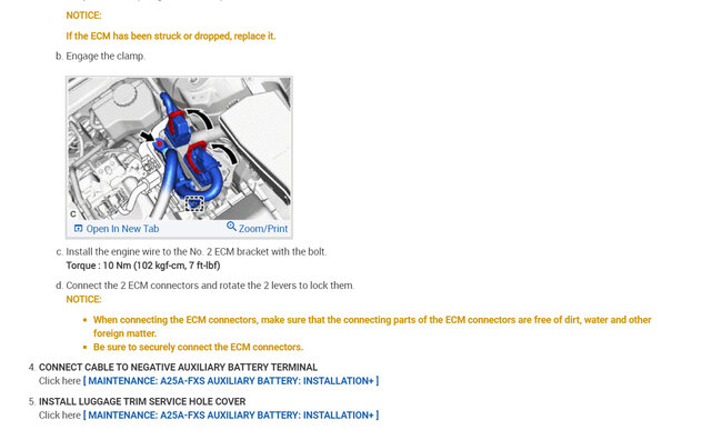

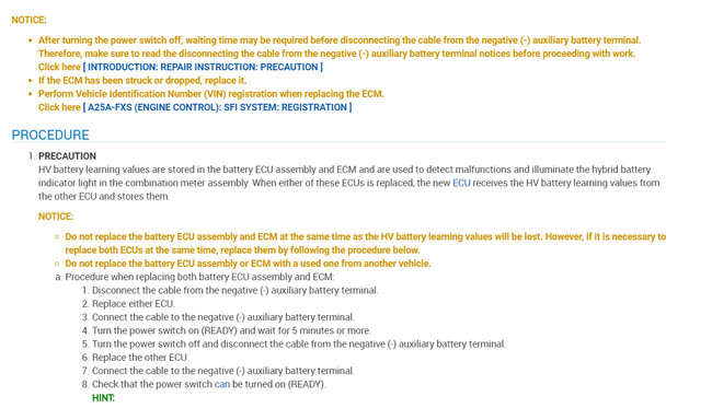

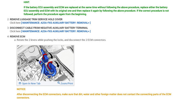

Here is the location and how to change out the main computer PCM. You can get a preprogrammed unit by searching Google or Ebay. Check out the images (below). Please let us know if you need anything else to get the problem fixed.
