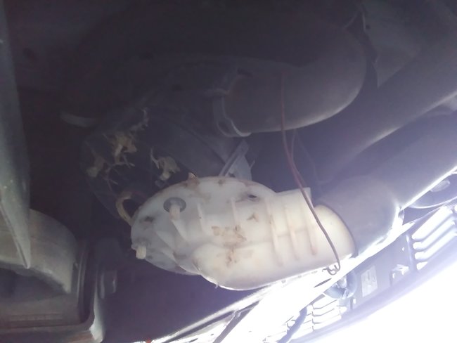

I noticed a little black hose with a white plastic piece hanging out from under the car in front of my front left tire and i just need to know what it is. I read about it and some people say it has something to do with air intake?

That hose looks like it is from the air pump. that is the air injection pump that puts additional air into the exhaust for additional burning of gases after the cylinder firing.
Is there any issue or complaint?

Do i have to get it replaced? because its completely disconnected.

I would get it replaced. it will set a code eventually and that will effect your emission testing.

Okay thanks i appreciate it. Do you by chance know where i could order a replacement?
Dec 17, 2018 at 8:54 PM
  • CAR REPAIR CONTRIBUTOR
Call the dealer. they will look it up for you and they will have pictures for you.
Take your picture with you to help identify the hose.
