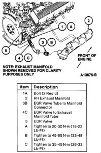

Where is the EGR Valve, and the fuel pump relay located? How hard is it to replace these items?
Aug 26, 2019 at 11:49 AM (Merged)
  • CAR REPAIR CONTRIBUTOR
  • 75,992 POSTS
The Fuel Pump Relay is located at the LH side of engine compartment, in relay center. EGR Valve
https://images.2carpros.com/forum/automotive_pictures/12900_egr_6.jpg
