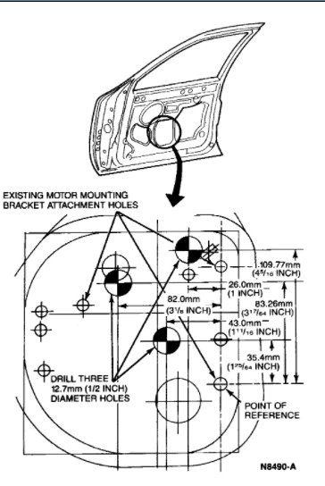

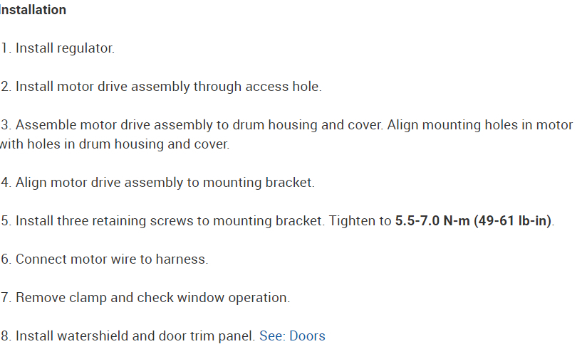

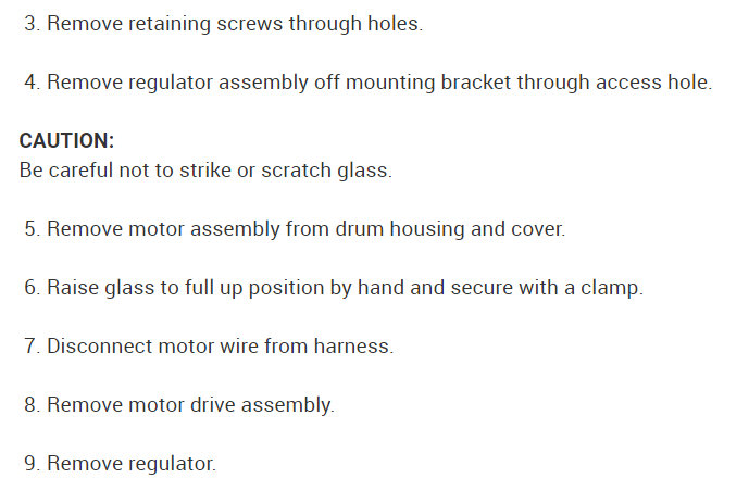

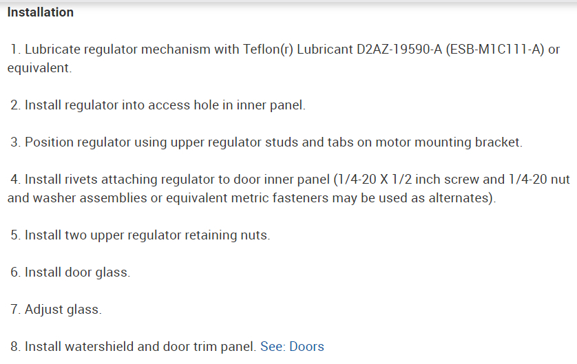

How to repair 1992 Lincoln Town Car power windows. Motor runs, but window won't go up. Can't figure out how to disassemble to see what is wrong.
-1
Saturday, January 11th, 2020 AT 2:20 PM (Merged)
FORD MAN
  • 115 POSTS
Pull the door panel off, & be gentle on the little plastic plugs (they hold the door panel in place on the door), they break real easy !
STEEVEWUUDS
After the door panel is off, how do you get the mechanism out of the door to check out what is wrong?
+3

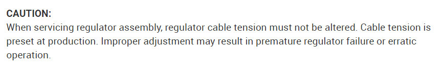

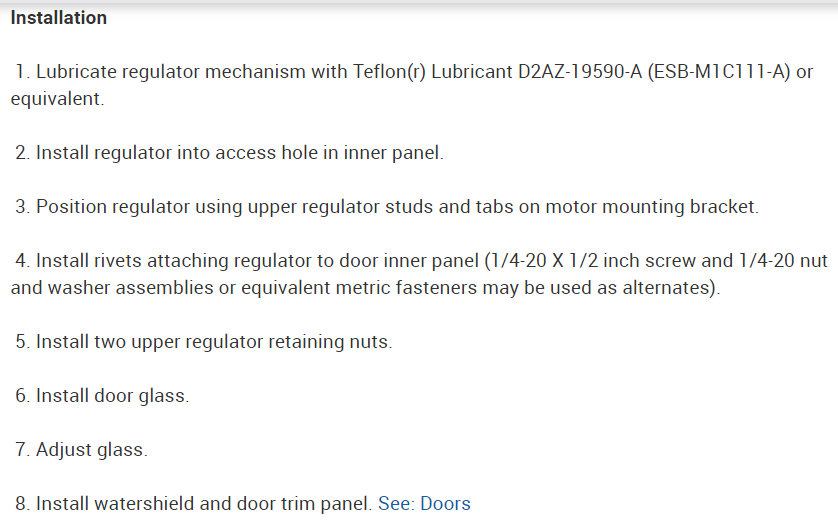

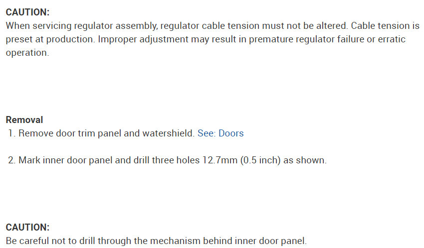

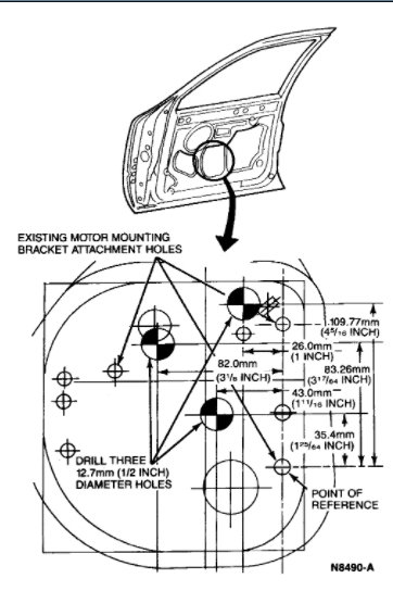

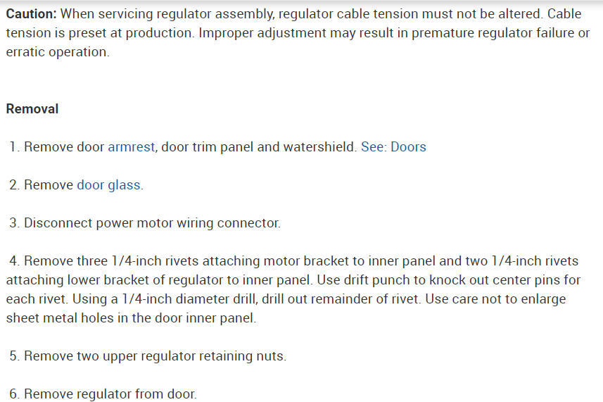

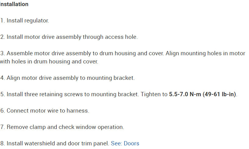

DANNY L
  • 5,648 POSTS
Hello, I'm Danny.
It sounds like you are having an issue with the window regulator. Here are two tutorials to view to aid in gaining access to the regulator to replace it:
https://www.2carpros.com/articles/door-panel-removal
https://www.2carpros.com/articles/how-to-check-and-replace-a-electric-power-window-motor
I've attached picture steps below on how to remove the window regulator for your car. The first set is for having the window glass down and non-functional. The second set is for window being operational. Hope this helps and thanks for using 2CarPros.
