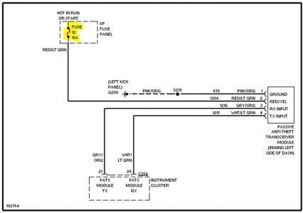

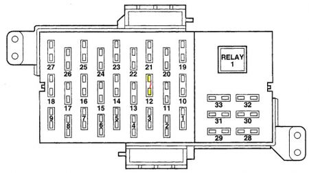

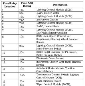

Number 12 fuse in fuse box under dash keeps blowing.
Monday, September 13th, 2010 AT 9:47 PM
BMRFIXIT
MECHANIC
19,053 POSTS
You have a short to ground in the engine wiring harness and or a defect in one of the modules.
Run some tests and get back to us so we can continue helping you.
Best, Ken
