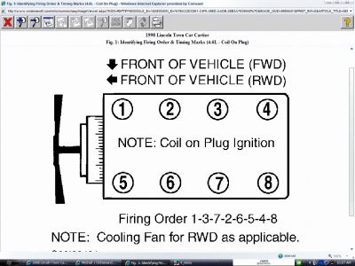

Check engine light on for coil #5. Need to know where to locat it?
