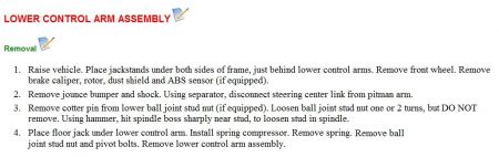

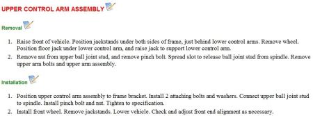

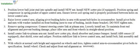

Trying to remove control arm on passenger side. Bolt contacts steering arm to where I cant get the bolt out. What am I missing?
