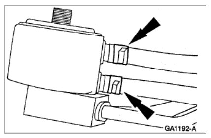

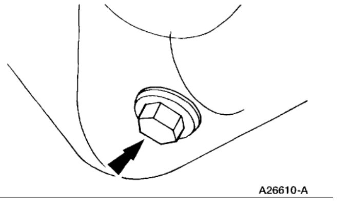

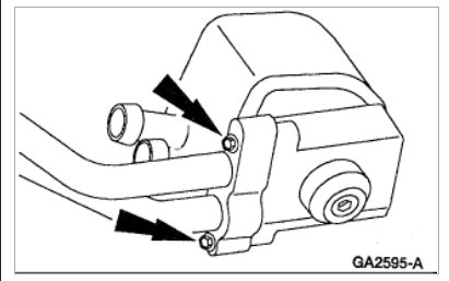

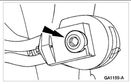

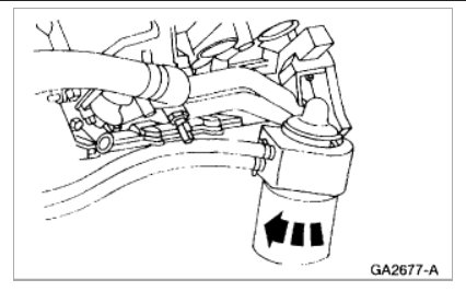

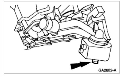

Yes you have a oil cooler that has failed which is located by the oil filter. What happens is the oil pressure is greater than the pressure in the cooling system so engine oil gets pumped into the radiator. Here is a guide and some diagrams (Below) that will help you get the problem fixed.
https://www.2carpros.com/articles/coolantantifreeze-in-the-engine-oil
Check out the diagram (Below)
