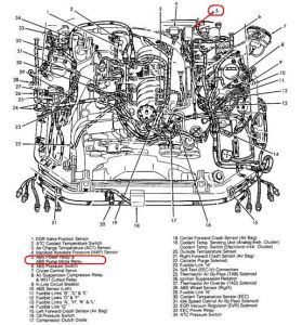

Where is the relay switch for anti-brake
Sunday, April 26th, 2009 AT 5:56 PM
BLUELIGHTNIN6
MECHANIC
16,542 POSTS
ABS Power Relay as well as the ABS Pump Motor Relay are located on the firewall, near master cylinder, under cover (pictured below)..
