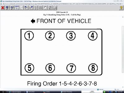

Hi, I was just wondering what is the location of the 6th cylinder inside a Lincoln LS V8 3.9L?

2nd on drivers side

Thank you very much. Im happy to report that I fixed the problem.
