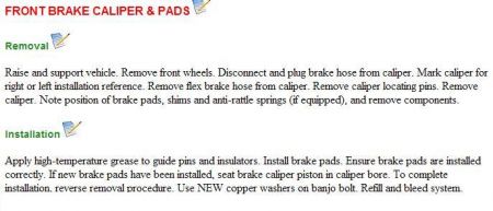

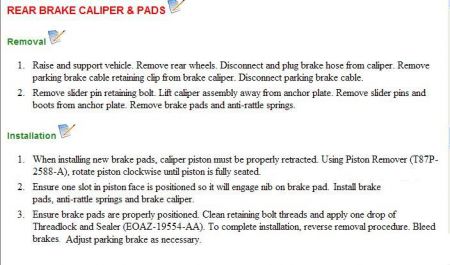

1995 Lincoln Continental replacing car brakes
DOMINIC0007
  • 1995 LINCOLN CONTINENTAL
  • V8
  • 2WD
  • 110,000 MILES
I need a step by step of how to replace the brakes on my 1995 lincoln continental. Front and Rear brakes. Thanks Dominic Spinellidominic@yahoo. Com
Monday, February 22nd, 2010 AT 9:40 PM
BLUELIGHTNIN6
  • 16,542 POSTS
https://www.2carpros.com/forum/automotive_pictures/261618_Noname_1734.jpg
https://www.2carpros.com/forum/automotive_pictures/261618_Noname2_544.jpg
