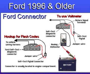

Most of the time drivability problems are tune up related...but if the converters are missing, the 02 sensors in tandem with the PCM are not adjusting fuel mixture correctly. You do need a converter...Also test the car for trCount the flashes, a 22 will flash as 2 flashes then a short pause, then 2 flashes, if more than one code is stored, the pause will be longer. The codes will display three times and end with 11 or 111. Write them down and post here. ouble codes! Do it this way...
https://images.2carpros.com/forum/automotive_pictures/62217_Test_Connector_Pre96_6.jpg
