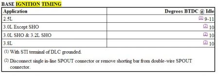

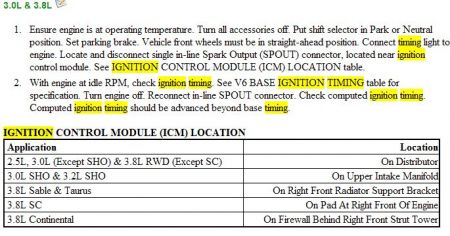

After replacing (long block)Eng:3.8,I wish to set the timing to 10^BTDC, but can't see the timing mark on the harmonic bal. from above (too many obstructions).
Must it be viewed from below? TIA, Al.

You'll probably get a better shot at it from below. It's tough no matter how you do it.
