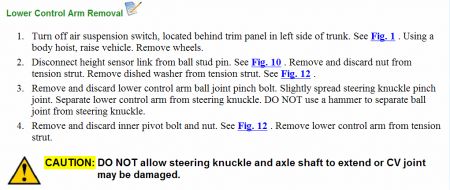

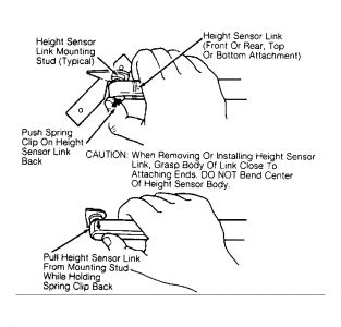

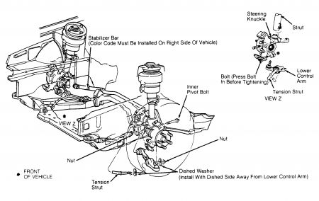

How do I replace my lower control arm bushings on my 1993 lincoln continental executive series
Wednesday, January 7th, 2009 AT 8:44 PM
OBXAUTOMEDIC
MECHANIC
3,711 POSTS
Here ya go Click your CTRL key and the + key to zoom in to read or see pics better.
