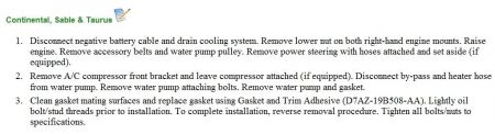

1989 Lincoln Continental water pump
ALBOTELHO25
MEMBER
1989 LINCOLN CONTINENTAL
Engine Cooling problem
1989 Lincoln Continental 6 cyl Automatic 120000 miles
removal&installation of water pump 3.8l v6 motor & what tool needed thanks
Sunday, November 7th, 2010 AT 1:37 PM
BLUELIGHTNIN6
MECHANIC
16,542 POSTS
Monday, November 8th, 2010 AT 12:13 AM
