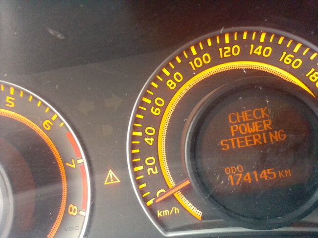

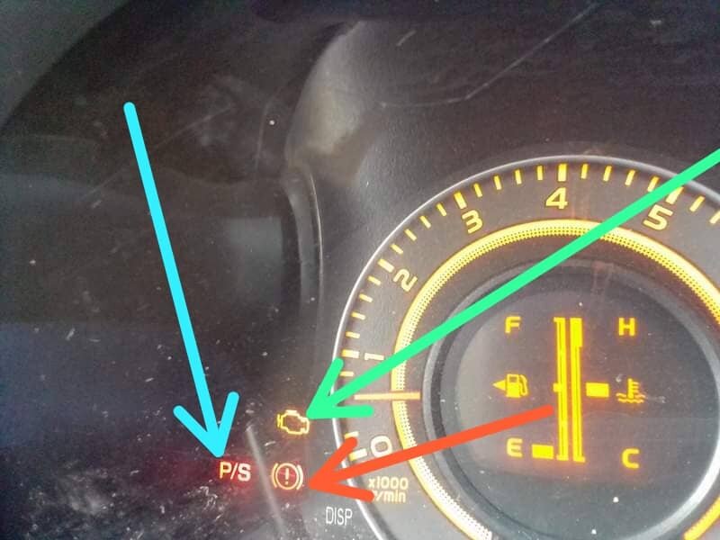

A client complained that when he was in motion his airbag shot. Eventually, he noticed that the smoke was emanating from the engine bay. Hence, he pop-up the hood and saw that the smoke was coming from the ABS module. He called a mechanic to unplug the ABS module connector. Afterward, the connector was connected back. Henceforth, he has noticed that his steering is stiffer to steer. Additionally, he said: "the car isn't moving smoothly as before."
Yesterday, he called and said even the headlights and other lights aren't working again in the car.

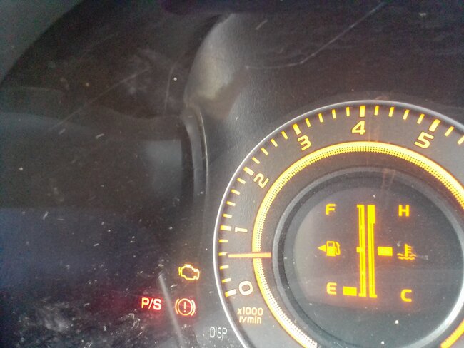

The check light appears first, brake light second then finally the P/S light appears. The lights don't come out at once.
Please help guide me on how I can fix this problem permanently for the client.

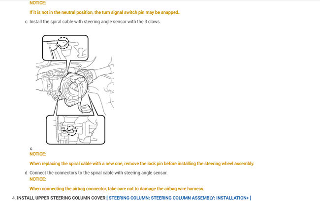

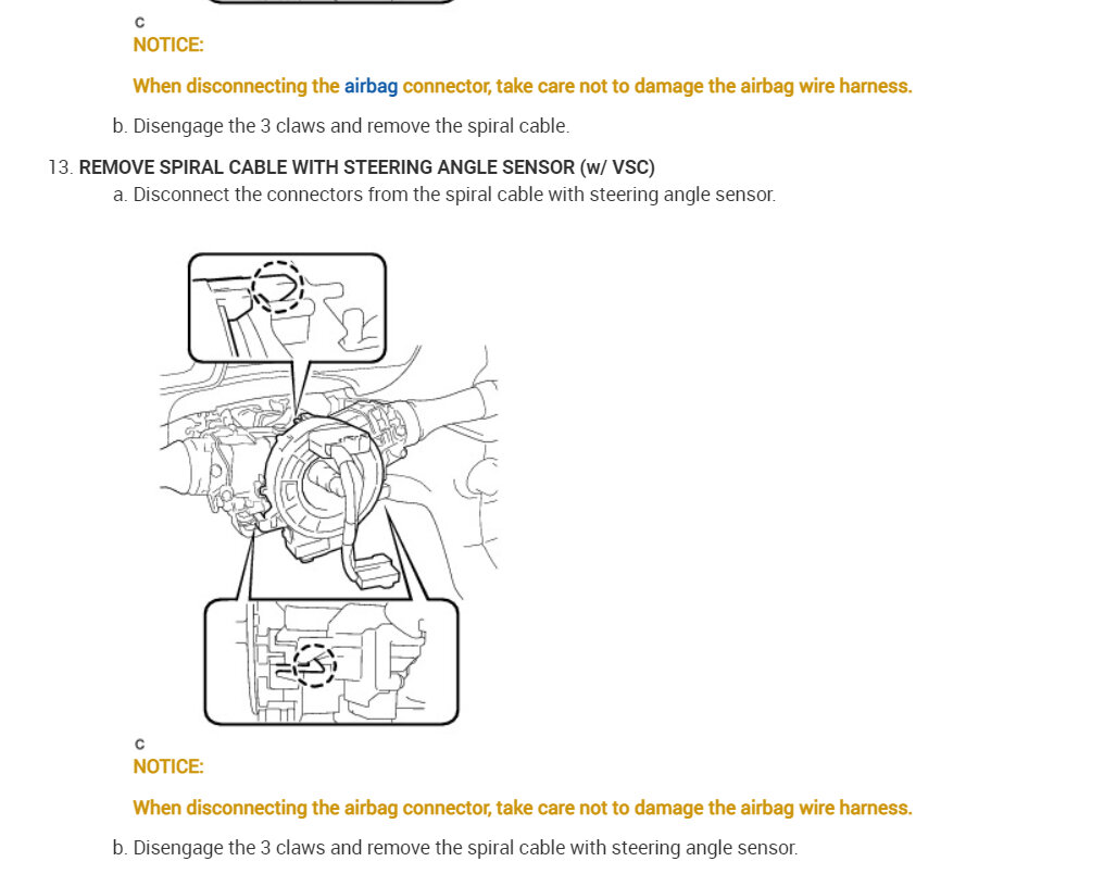

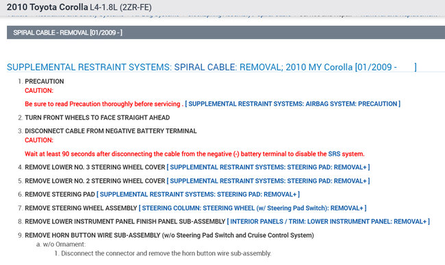

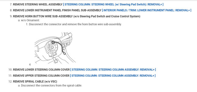

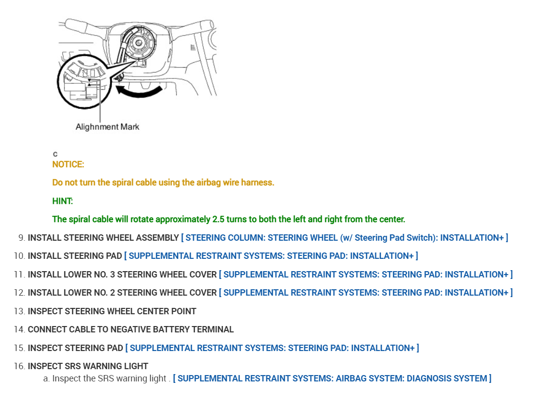

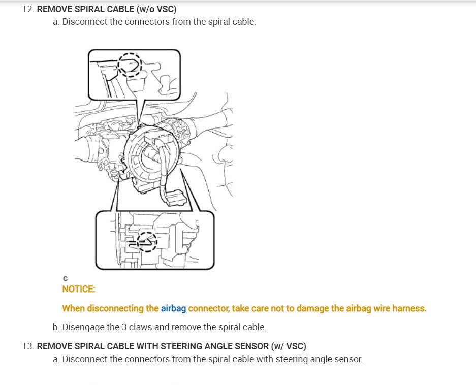

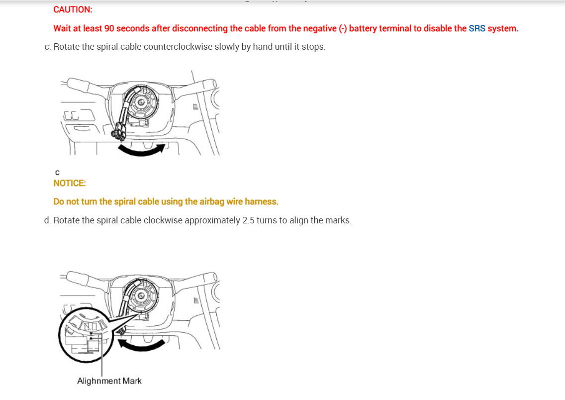

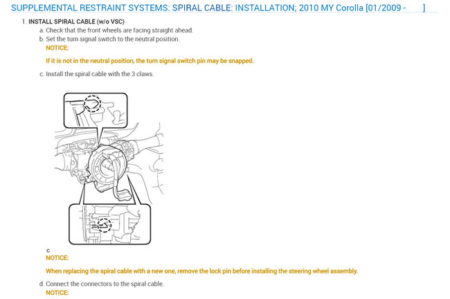

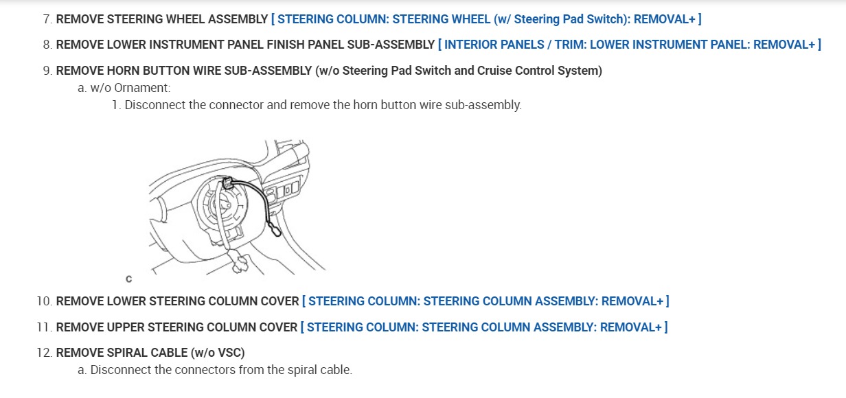

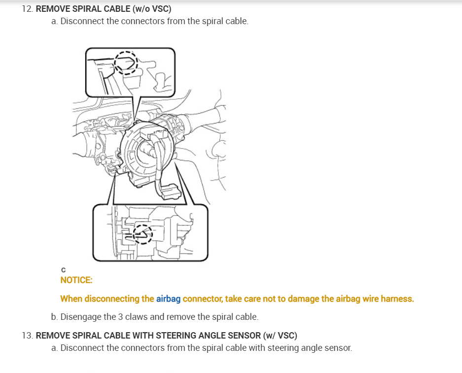

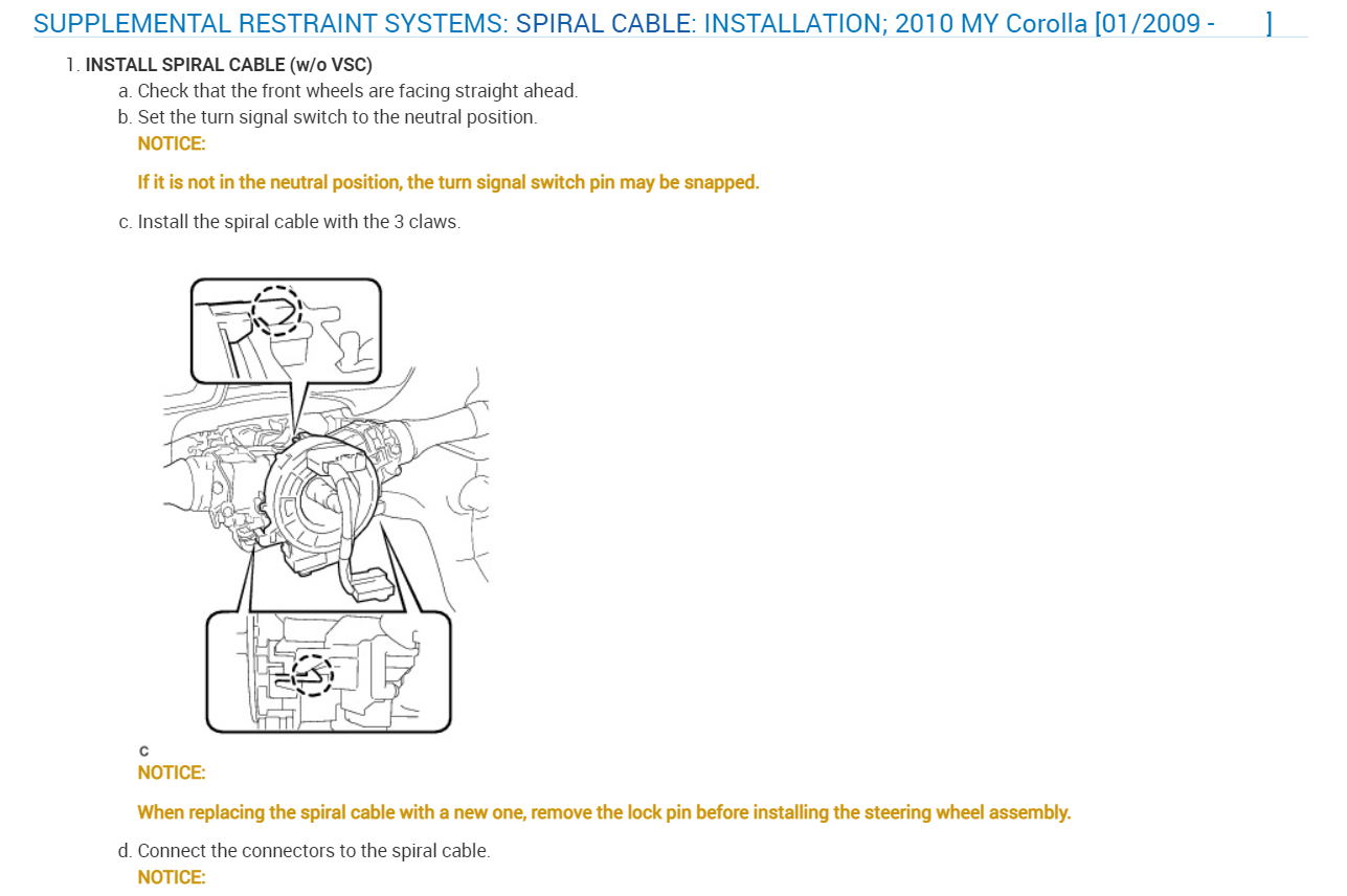

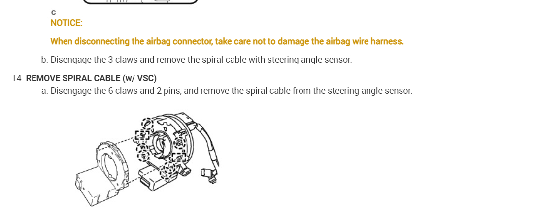

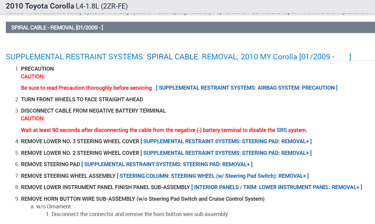

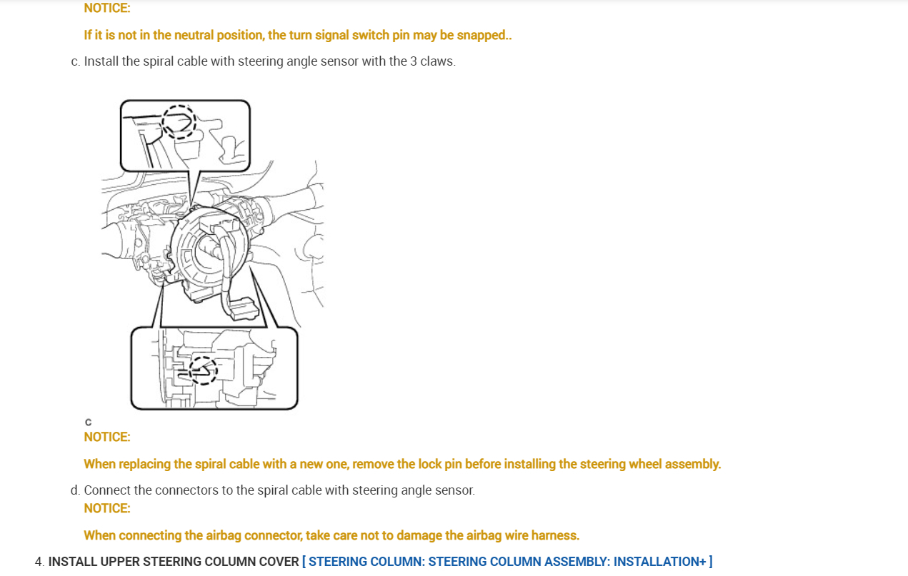

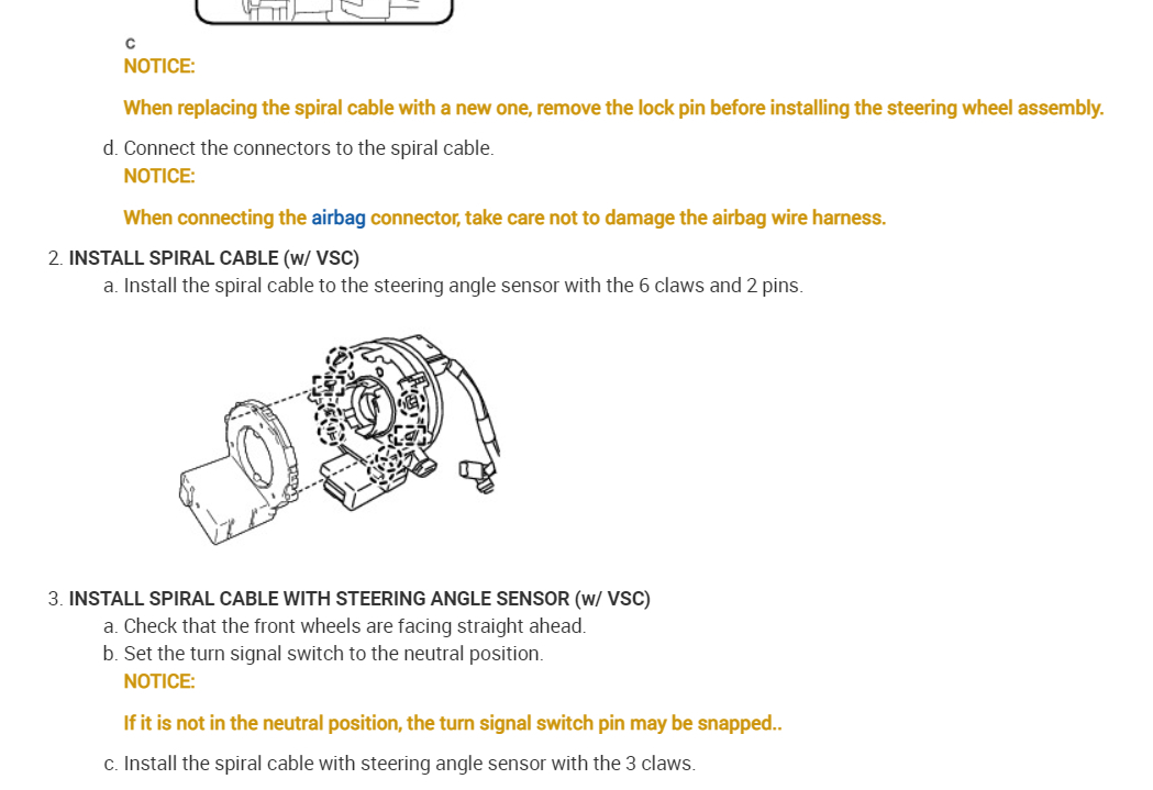

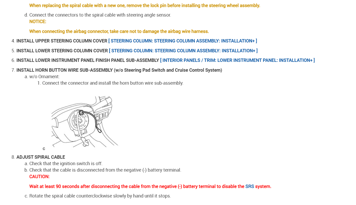

It sounds like the power steering motor has gone out or the spiral wire behind the steering wheel is bad or both, here is the spiral wire so you can check it out. Check out the images (below). Please let us know what happens.

He said that the clock on the instrument cluster wasn't raising on motion as well. The bulbs were replaced.

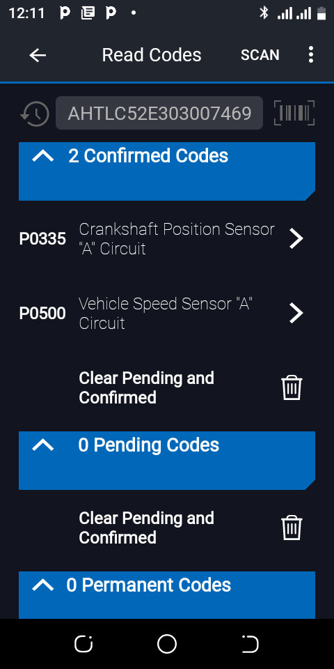

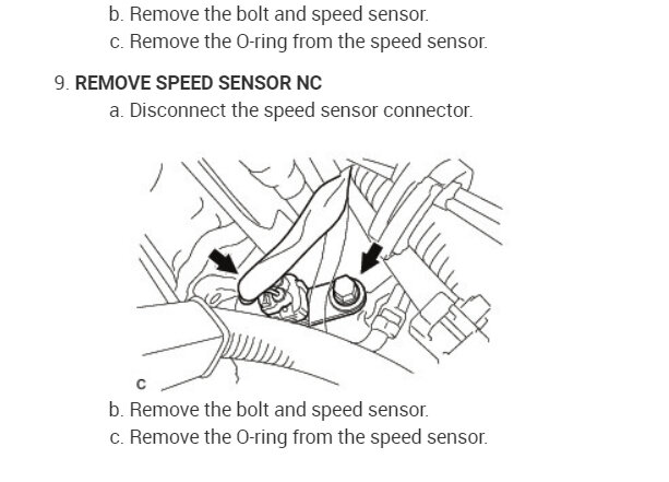

I checked for the DTC yesterday. The codes I found were P0335 and P0500. That's the CKP sensor and vehicle speed sensor code. When I cleared the code the check engine light went off. But later came back ON few minutes later.
Symptoms with the car was that the engine was vibrating, hard starting and can't move freely when on the hill.

The client is a novice about cars and was unable to give me a good explanation. I didn't see any sign of airbag shooting when I saw the car after is complaint. I told him that the airbag is still okay. He made a mistake in his explanation. The only thing I saw was that the ABS connector was unplugged and headlights were bad in the car.
What I noticed from the car was that when it is first started the RPM rises to about 2,500 and then drops to about 700 RPM on its own.
Probably there could be a short on the instrument cluster as well because I noticed a blink once after about every 25 seconds throughout idling except the car is shut-off. He said that was how it was when he purchased the car from someone till date.
In addition, the speed clock doesn't raise when driving and the car is intermittently hard to start.
P0335 and P0500 were the only codes I retrieved.

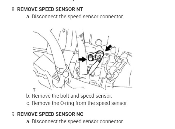

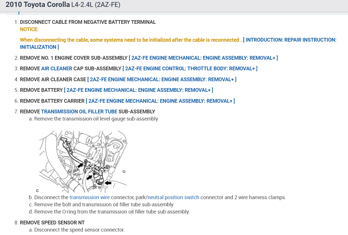

The p0335 code is for a bad crankshaft sensor connection and the p0500 fault with the vehicle speed sensor which can affect the steering so let replace that first to see if that fixes it. Check out the images (below). Please let us know what happens.
