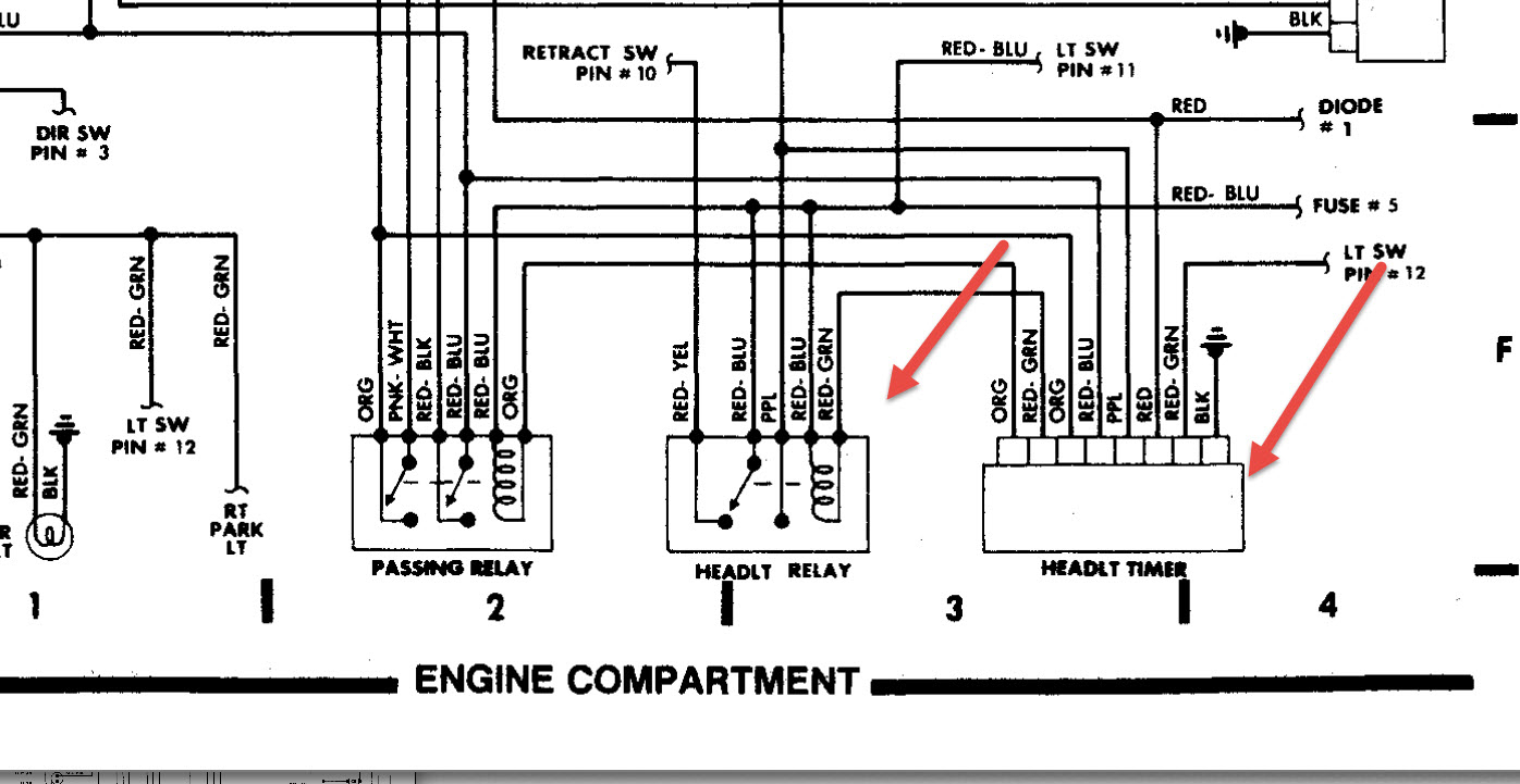

I can turn my lights on but when I get ready to turn them off they stay on.

Check the two items in picture under hood then check for a bad headlight switch, but probably the timer.
Image (Click to make bigger)
