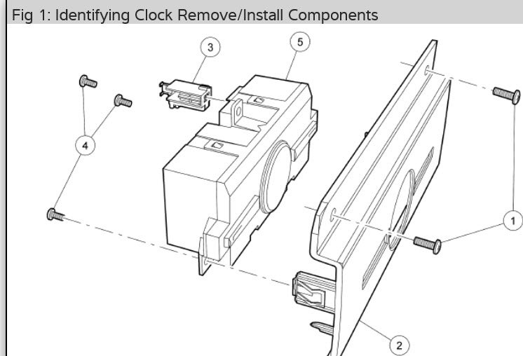

Light in clock was off but would come on if clock tapped.
Now light is off all the time.

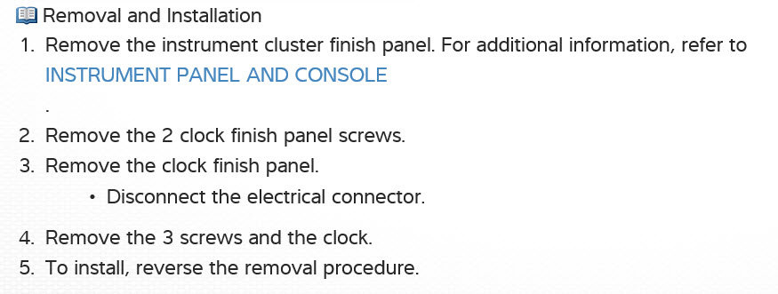

How to simply remove clock and replace bulb without taking apart entire dash.

It looks like one unit but instructions in picture.
