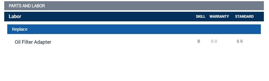

This could be the coolant breaking down and showing a rust color. Since you flushed the system, it may be okay.

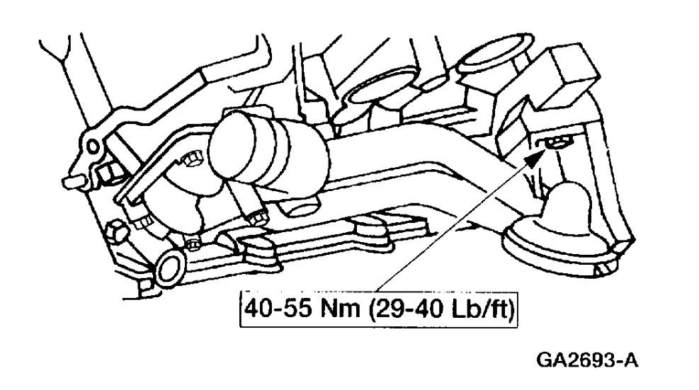

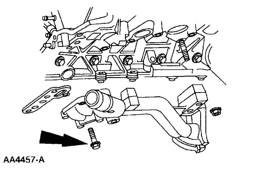

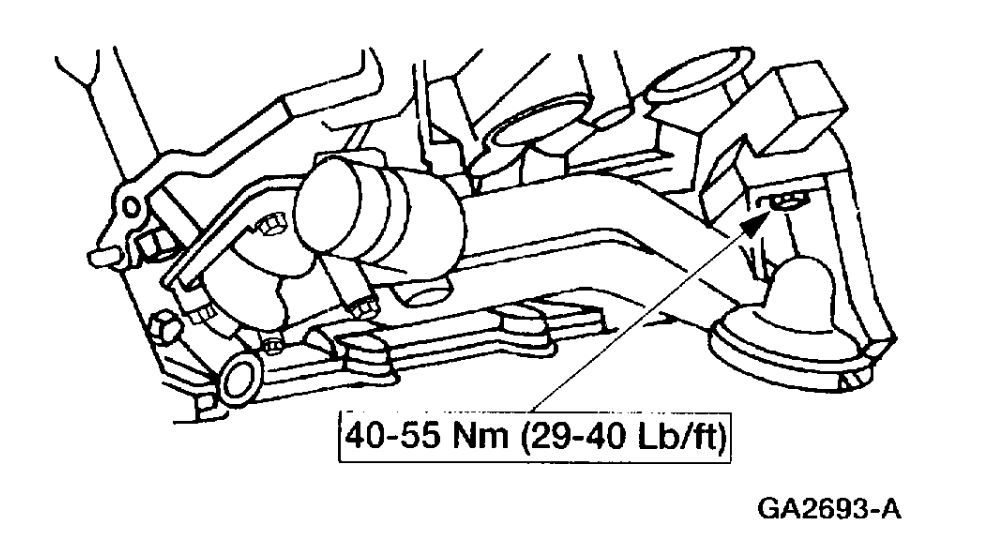

If it was oil, it would indicate a block failure for the engine. If it was a head gasket, you would have coolant in the oil. The oil cooler, that is, the oil filter mount could also cause this issue. I attached pictures for you of the cooler.It pays 7 hours to replace the cooler. It is a big job since it is so tight in the engine compartment.
I would keep an eye on it to be sure it does not return. The YouTube video below is a similar replacement.
