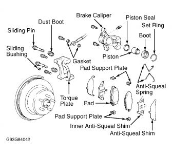

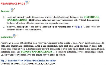

do I need a special compression tool for this cars rear calipers?
Wednesday, June 3rd, 2009 AT 11:58 PM
MHPAUTOS
MECHANIC
31,937 POSTS
Hi there,
There are no special tool;s required to replace the rear pads, see text & pic for details.
