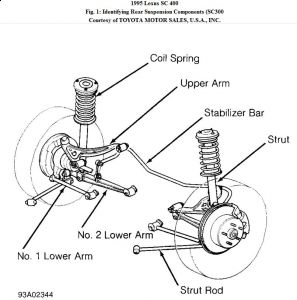

Hi! I do I remove the right rear wheel bearing hub on my 95 Lexus SC400?
We have been trying to remove the hub so we can replace the inner bearing, but we can'nt seem to get the hub off the car.

Hi padixon, Thank you for the donation. Here are the procedures for removing the hub and bearing. Removal 1 . Raise and support vehicle. Remove rear wheels. Remove axle shaft lock nut. Remove and suspend brake caliper. Mark disc and hub for installation reference. Remove brake disc retaining screws and brake disc. 2 . Remove axle shaft. Remove parking brake shoes. Remove ABS speed sensor. Disconnect parking brake cable. Disconnect strut rod. Using Puller (09628 - 10011), disconnect No. 1 lower arm. Using Puller (09610 -200121), disconnect No. 2 lower arm. Using Puller (09628 - 62011), disconnect upper arm. Remove hub and carrier. 3 . Remove bearing dust deflector using a screwdriver. Remove grease seal using Puller (09308 - 00010). Discard grease seal. Remove hub using Puller (09950 -20017). Remove inner bearing race using Puller (09550 -20017). Remove outer grease seal. Remove snap ring. Temporarily install inner race. Press bearing from axle carrier.
https://images.2carpros.com/forum/automotive_pictures/192750_SuspensionRR95SC400Fig01_1.jpg
