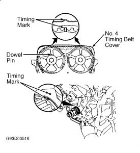

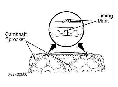

I need to know the timing belt alignment marks for 1992 in line 6 lexus sc300

Here are two pics to show you the marks if you need anything else just ask.
