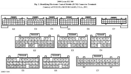

3. Disconnect suspect ignition coil/ignitor connector. Turn ignition on. Backprobing, measure voltage between ground and terminals No. 27 (Green/Black wire) and No. 28 (Red wire) at ECM E2 connector. See Fig. 2 . If voltage is 4.5-5.5 volts, replace suspect ignition coil/ignitor. If voltage is not 4.5-5.5 volts, replace ECM and retest.

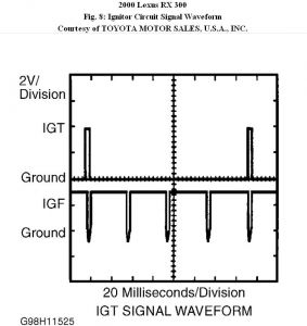

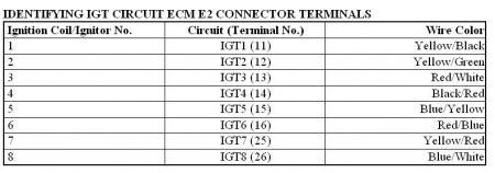

6. Backprobing, measure voltage between ground and each IGT circuit terminal at ECM E2 connector while cranking engine. If voltage is .1-4.5 volts, go to step 7 . If voltage is not .1-4.5 volts, replace ECM and retest. Backprobing, connect oscilloscope between terminal No. 17 (Brown wire) ECM E3 connector and each IGT circuit terminal at ECM E2 connector. Crank engine or allow engine to idle. Waveforms should be as illustrated. See Fig. 8 . If waveforms are as illustrated, go to next step. If waveforms are not as illustrated, replace ECM and retest.
7. Disconnect all ignition coil connectors. Backprobing, measure voltage between ground and each IGT circuit terminal of ECM E2 connector while cranking engine. If voltage is .1-4.5 volts, go to next step. If voltage is not .1-4.5 volts, replace ECM and retest.

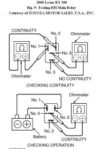

10. Check EFI main relay. See Fig. 9 . EFI main relay is located in underhood engine compartment at right side of engine. Replace as necessary. If EFI main relay is okay, replace suspect ignition coil/ignitor.
