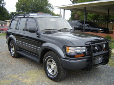

I have a 97' LX450 and both front marker lights are burned out. I see very easily how to replace the both headlight bulbs but cannot for the life of me figure out how to replace the marker lights. Help please if you can.[img:e8929cd8c2]http://www.2carpros.com/forum/automotive_pictures/107795_The_Lexus_1.jpg[/img:e8929cd8c2]

U have to remove the marker lens out
Open the hood
At the corner by the fender you should be able to see a Philips screw
Remove that and than slide marker out
Good luck
