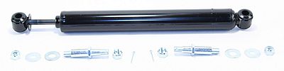

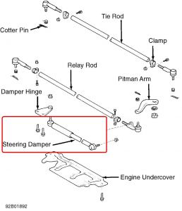

Did you also replace the steering stabilizer/damper as well? That part is responsible for the lateral movement of the vehicle.
https://www.2carpros.com/forum/automotive_pictures/55316_sc2957_1.jpg
https://www.2carpros.com/forum/automotive_pictures/55316_96lexusstabilizer_1.jpg
Wednesday, January 21st, 2009 AT 11:58 AM
MSHARIEF
  • 5 POSTS
The steering stabilizerdamper was a little different from the original. In fact the replacement looks exactly like the picture you sent me. The original looks like the one in the illustration. I dont know if that makes a difference. I replaced it my self. Maybe I should check if it is loose. Could it also be tire balance?
