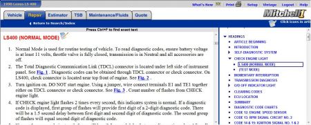

My check engine light comes on when I start my car and stays on for about one mile. This happens after the car has sat for quite awhile. Not every single time. I have replaced my Air Flow Meter previously do to a previous CEL but that has been a few months and this new light just started last week. HELP?

Scan the computer for code/s-you have a problem within the engine management thats popping the CEL

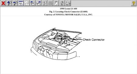

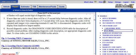

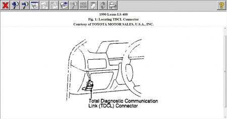

  • 75,992 POSTS
Or do below
