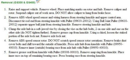

How do I remove the front hub from a Lexus GS400
