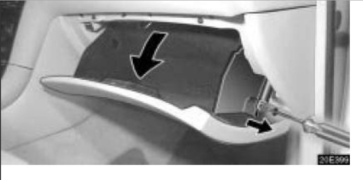

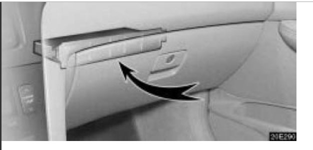

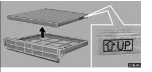

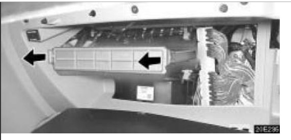

I recently installed a new cabin air filter. When I disassembled the components to allow me to get into the filter, the glove box door tension device fell into the space to the right, rear of the door. Upuo reassembly of the glove box door, I find I don't konow how to reassemble the tension device. Does the Philips head screw go thru hole C? If not which hole, A or B? In addition does the tension device get mounted with the rib up or down?

Hi cimcor, Hope the diagram is what your are looking for.
https://images.2carpros.com/forum/automotive_pictures/192750_LexusE330GloveBox01_1.jpg
Here is a video that can help as well. https://youtu.be/1S9FWyxH5V4 Its close to the same car that shows the glove box shock which is the same on your car. Please let us know if you need anything else to get the problem fixed. Cheers

The top of the tensioner slides onto a small plastic "nub". You have the two black plugs that keep the glove box from falling down when it is reassembled. Look at the hole for the plug on the right. Inside that area will be a small plastic nub (same color as the plastic around it) Your tensioner slides onto that "nub"

Maybe to make the attachment a bit more clear... on the cylinder there two black loops molded into the plastic. Disconnect the cylinder arm from the glove box if it is still attached and with the loops pointed down, simply slide the loop furthest away from the end with the screw onto the black nub on its left. After it's affixed to the nub, pull the screw-end arm down and replace the screw, attaching the arm to the glove box. All that remains is to replace the right and left plastic attachments inside the glove box.
